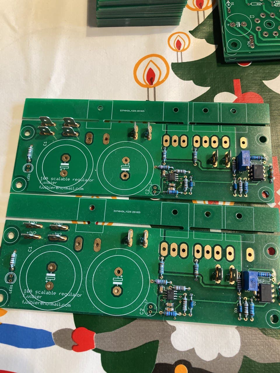

MIC5156 based linear regulator for fillaments may be what you guys are after for 10-20A of output current. This allows very low dropout voltages, provided you either use the IC with the internal charge pump for the mosfet gate driver, or the MIC5156YM with an auxillary 12V winding for gate drive.
I started work on a board sometime ago, but progress can be slow when you have too many projects.
Just a few pointers, if you ever need to drive a mosfet, LT1010 can be ideal to put between an opamp and the FET capacitances.

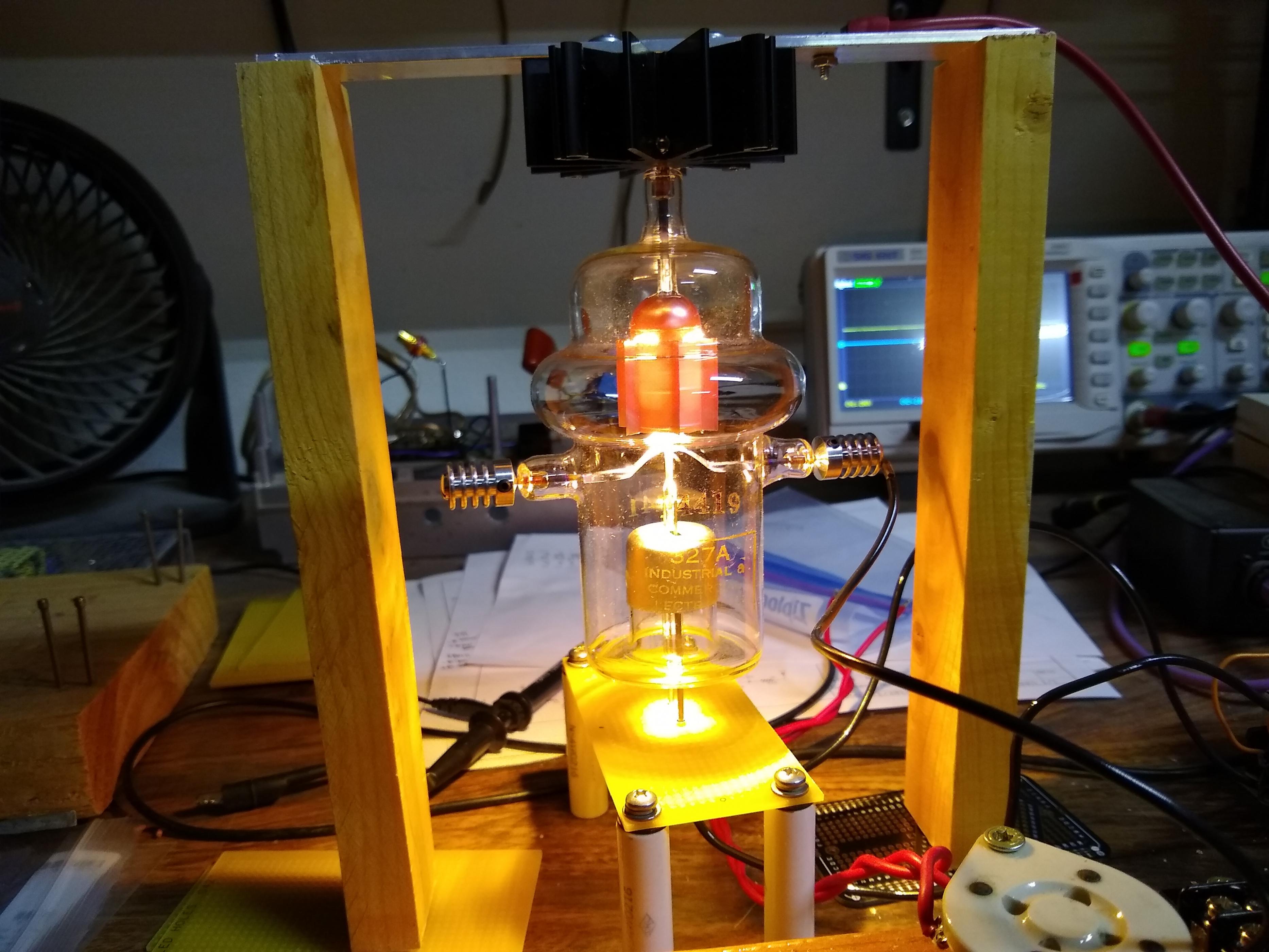

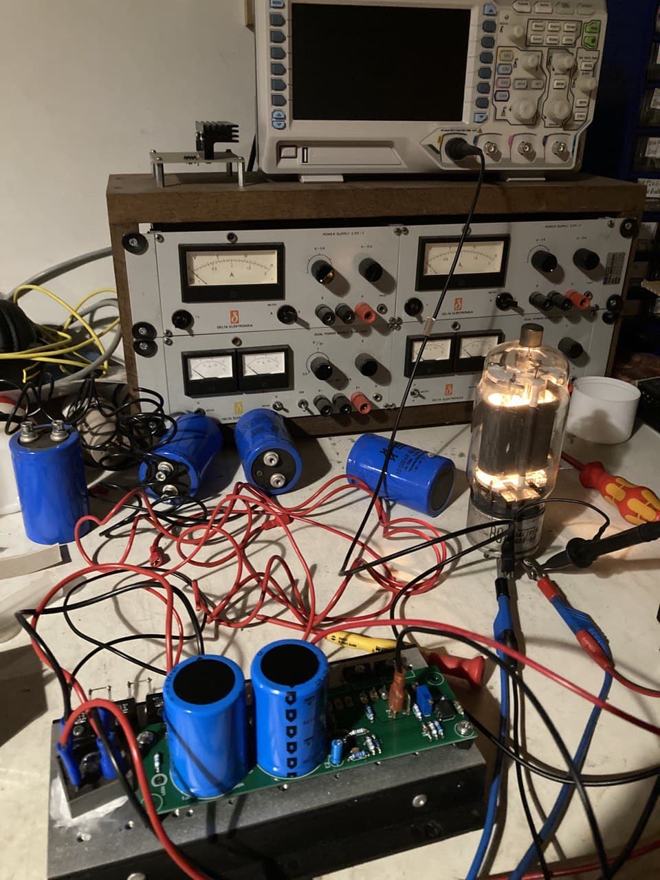

I've got some experience running the 327A (10.5V, 10.7A filament) with two Meanwell LRS-100-5 stacked. They start reliably within a few seconds and I have run them for many hours at a time with no issue while trying to cook gassy tubes. I'd imagine it would work just as well for an 833A filament, since it is lower power.

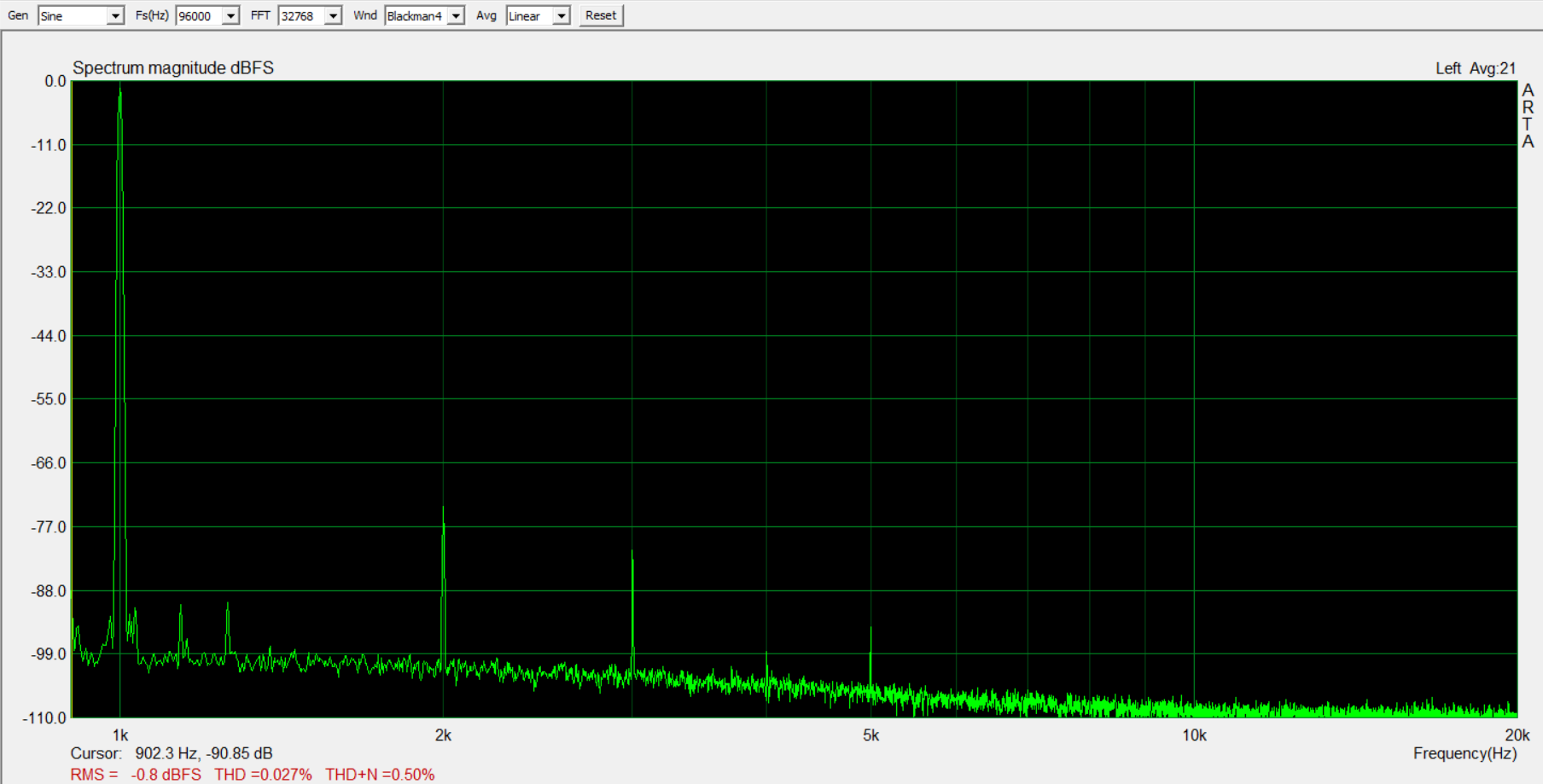

I've also been running the 826, a 7.5V filament tube from a Meanwell RSP-150-7.5 and I cannot detect any detrimental effect in measurements, nor can I hear any (1W distortion measurement attached).

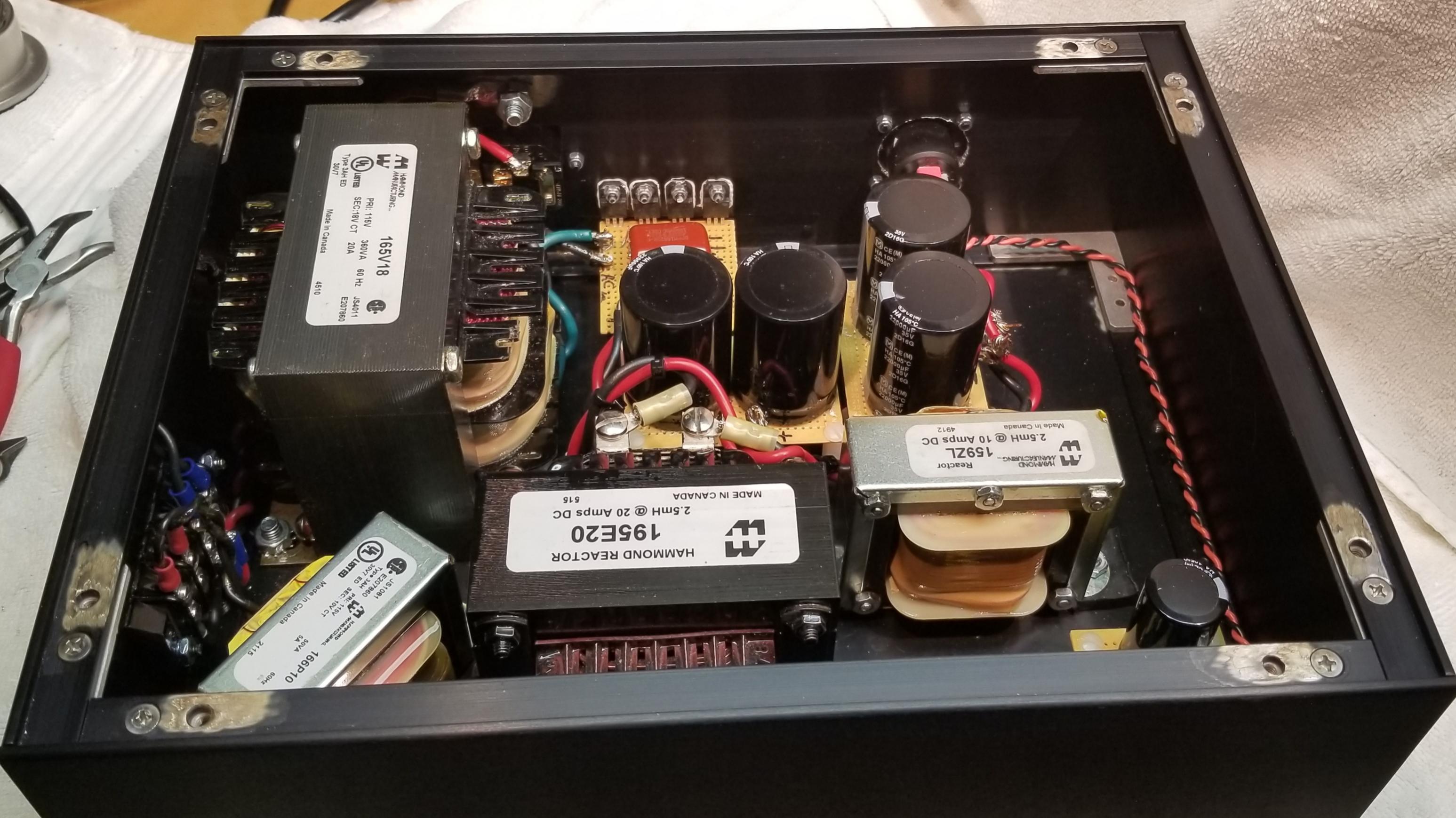

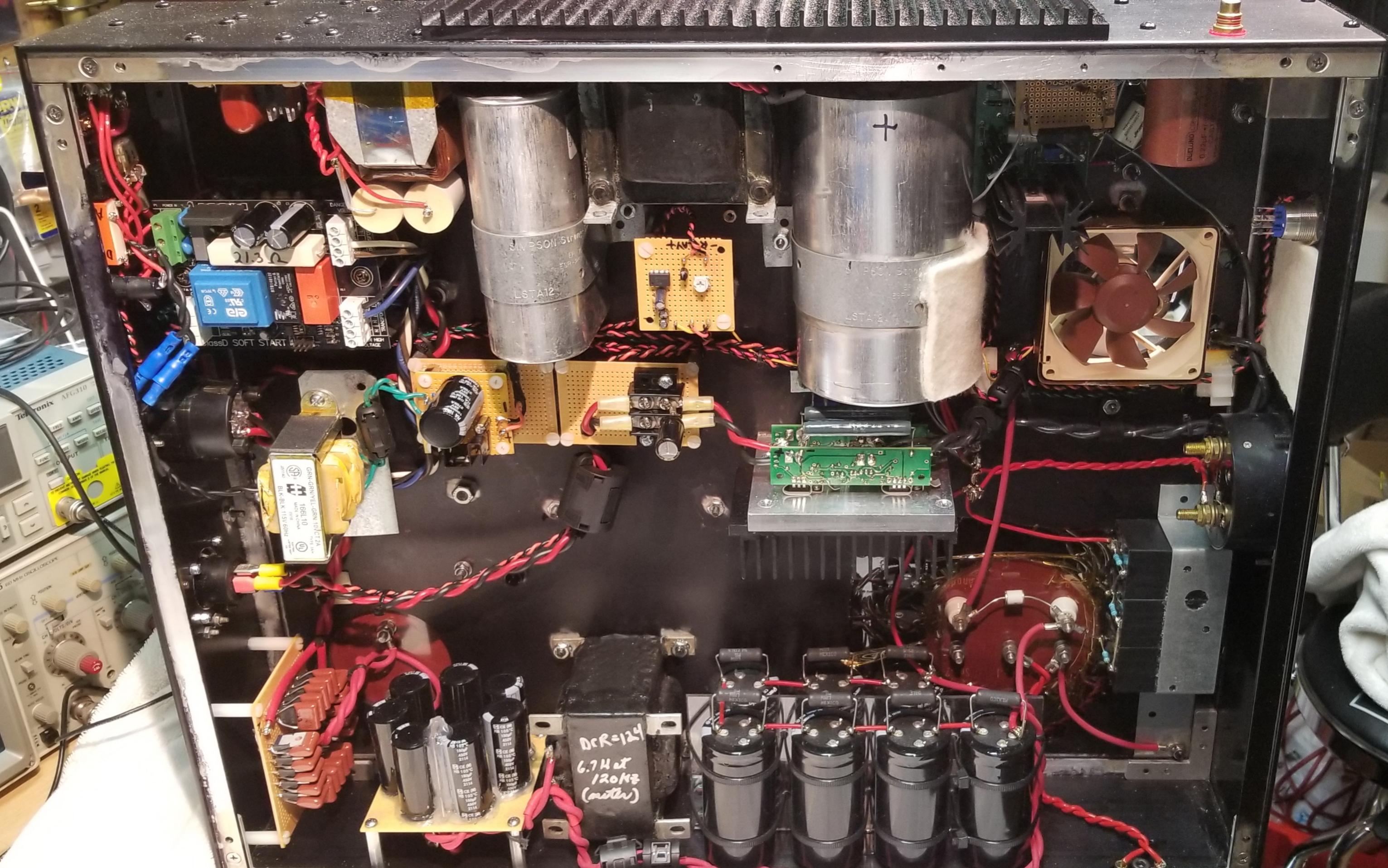

Filament and heater supply chassis for the right amp completed, along with the modifications to the amp. Just need to make the power cord and umbilical and we'll be ready to go, in stereo.

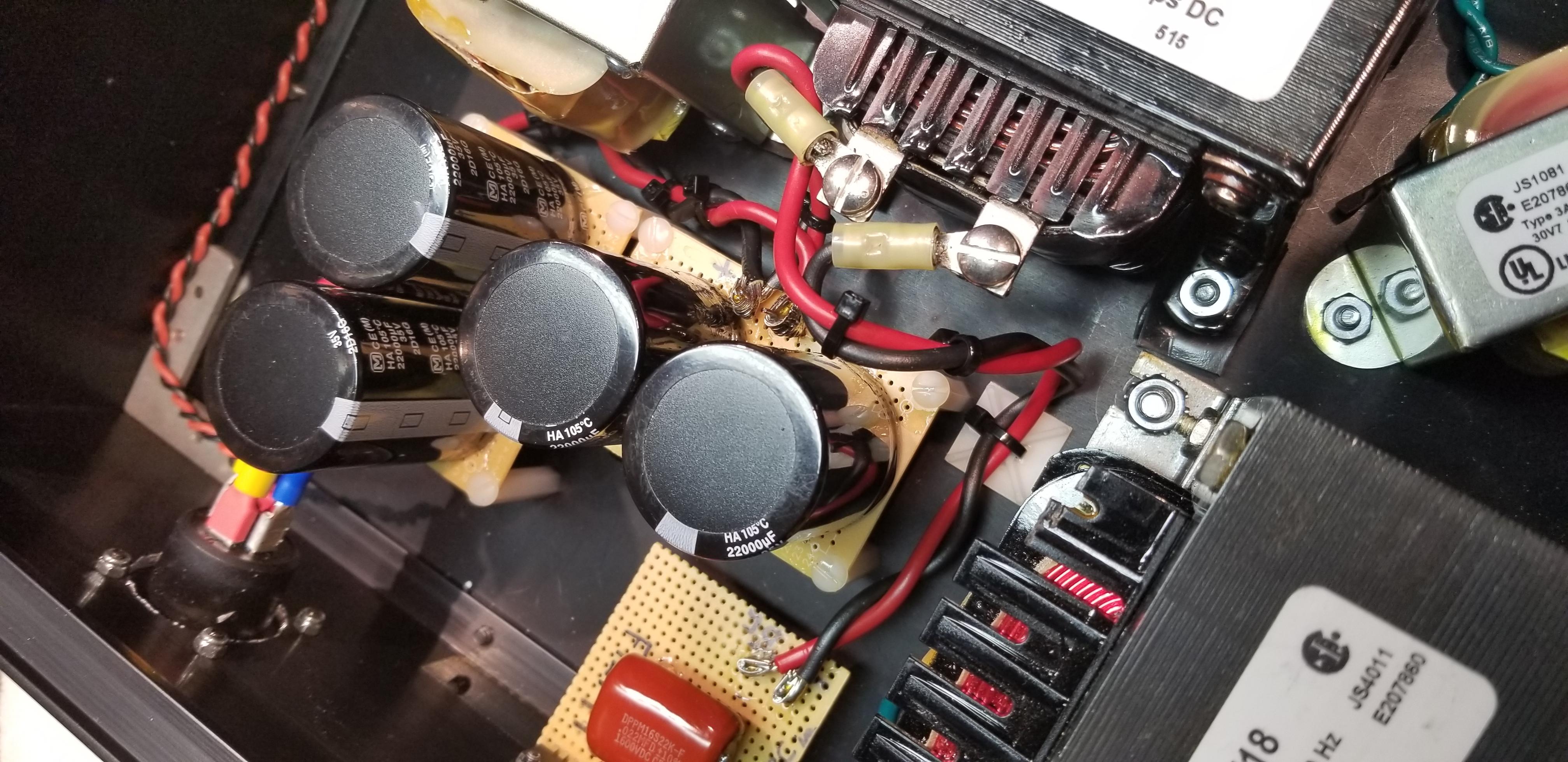

The filament filter is LCLC with the 20A choke before those snap-in caps. See close-up photo below.
The rectifier diodes are 100V, 30A schottkys, VF301005.
All those parts are the same ones that have been inside the amp for the last 7 years, except for the 20A choke which is replacing a 10A unit that was used initially due to size restrictions. Haven't had any issues with them.

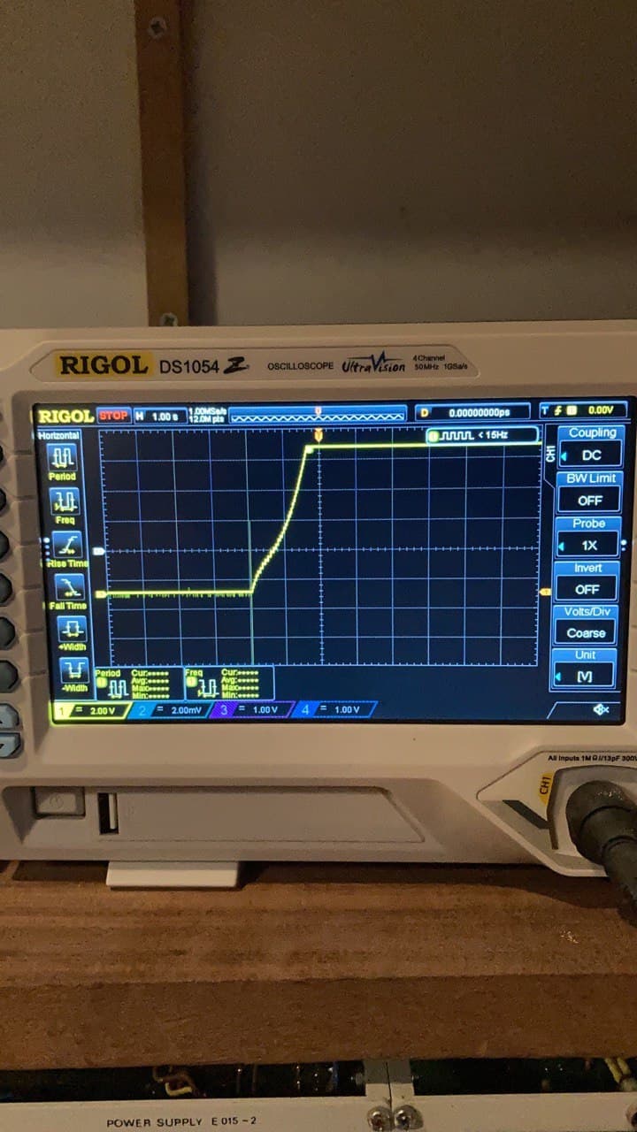

Heres a regulator i did for 3-10A of output current. Dropout is about 1V
There are some test pics from my phone, i dont have any boards left, tried selling them on the forum but found no takers.
The problem with SMPS is that some poorly designed SMPS flybacks will destroy the secondary diode if the supply overcurrents, or the shunt resistor for the primary switching fet.
Both amps are complete and operational with their separate filament and heater power supplies. I also swapped in the high dissipation IXYS ISOPLUS247 MOSFETs while I was at it in the 833 cathode regulators. That project is done but I may have stumbled across another modification for the future.
I'm learning more about MOSFETs and I found out that the ones I have been using (including the new ones I just installed) are actually not optimal for a regulator, they are optimized for switching operation - I should have known when there wasn't a safe DC operating area graph in the datasheets. The problem is that these power MOSFETs can fail in DC operation due to the formation of hotspots in the die. A MOSFET optimized for linear operation would have been a better choice.
So..at some point in the future I will most likely be switching the pass MOSFET in the cathode regulators to something like the IXYS IXTX22N100L:
Blocked
which should resolve the failure problems once and for all. In the SOA graph I can see that it is rated for DC operation at more than 1A at 250V, that will accommodate my 160mA idle current plus more grid current than I could possibly throw at it. Live and learn I guess.
For now, the amps are operating just fine and sound as good as ever, with an even quieter background due to the external filament supply, so I'm happy.
