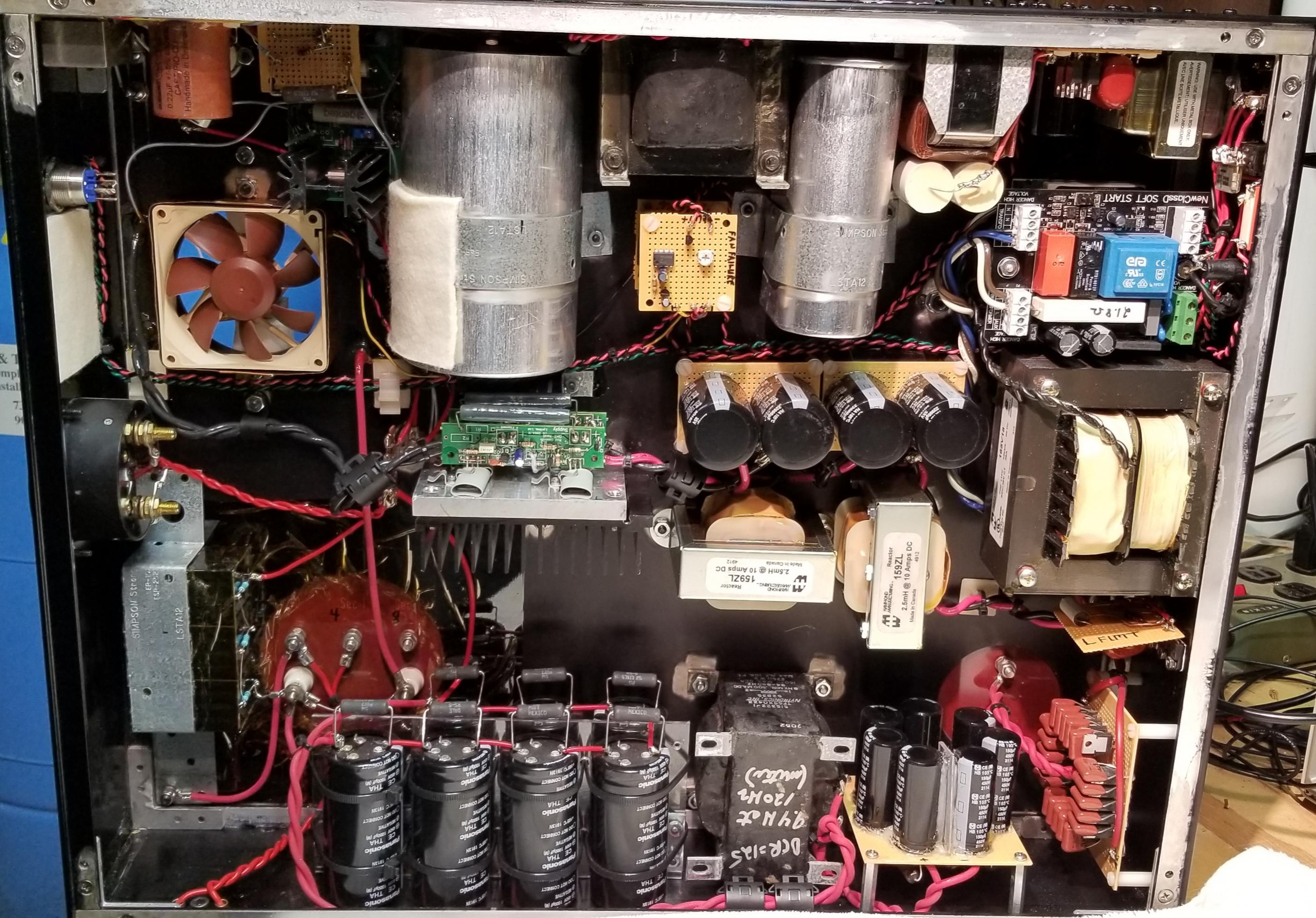

Well, after 7 years of hard labor, the pass MOSFET on the bias-setting shunt regulator under the 833C tube of my left amp gave up the ghost. I'm running it pretty hard under the 833C so I'm not really surprised. Shorted D-S. Bummer...BUT from lemons comes lemonade!
Since I have to lug the amp down to the basement (with help - definitely a 2-person job) to fix the MOSFET, I will take this opportunity to finally pull the 833C filament and 6E5P heater supplies out of the amp chassis and put them in a separate box - I bought Landfall boxes and all the parts for this several years ago and never got around to doing it; now I might as well follow-through. This ought to give me a quieter amp due to moving the 10V, 10A filament power supply and allow me to use a proper 20A first choke instead of the buzzing, noise-spewing 10A choke I was using (the 20A unit wouldn't fit in the box!). A side benefit is the behemoth will be 20-25lbs lighter...every little bit helps.
While I'm at it, I'm also upgrading the pass MOSFET to an IXYS HiPerFET IXFR48N60P. It's a 600V, 32A piece with 300W power dissipation (vs 190W for the current FET) and is in the Isoplus247 electrically isolated back surface package so I can just bolt it to the chassis heat sink instead of needing a SilPad, thus facilitating the heat dissipation a bit. This should help to bullet-proof this "weak link" in the system.

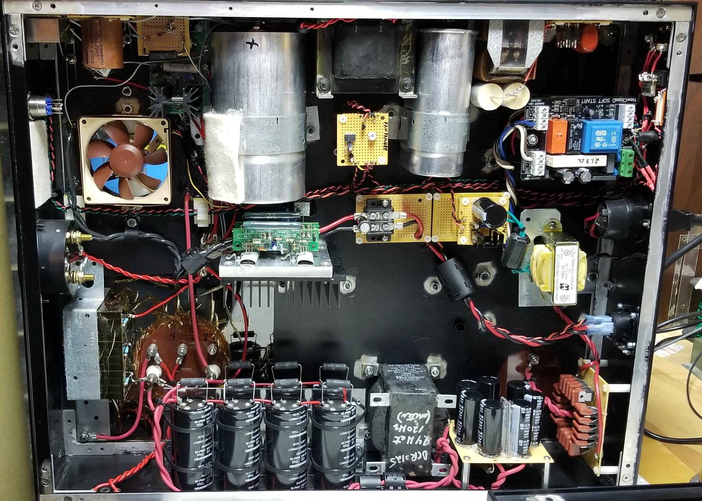

OK, the left amp is done. The entire 833C filament supply pre-regulator and 6E5P heater supply are now in the new box, connected to the amp via 4-pole right angle speakon connectors. I also moved the fan transformer and PS to where the filament supply was previously, and went to a split-bobbin transformer on the fan to keep as much fan hash out of the AC supply as possible. I still need to make a shorter power cord to connect the two boxes, but for now I'm using a spare power cord I had lying around.
It all fires up nicely and is dead quiet, even ear to the drivers quiet; previously you could hear some buzz with ear to drivers but not any more. Obviously the 10A filament supply was coupling to the OPT when they were both in the same box. Also, the physical buzz from the too-small first choke is completely gone with the new 20A choke in place.
I will make some measurements later but my ears tell me this is well worth the work.
First pic is the amp pre-mods, second is post-mods.
Now on to the right amp!

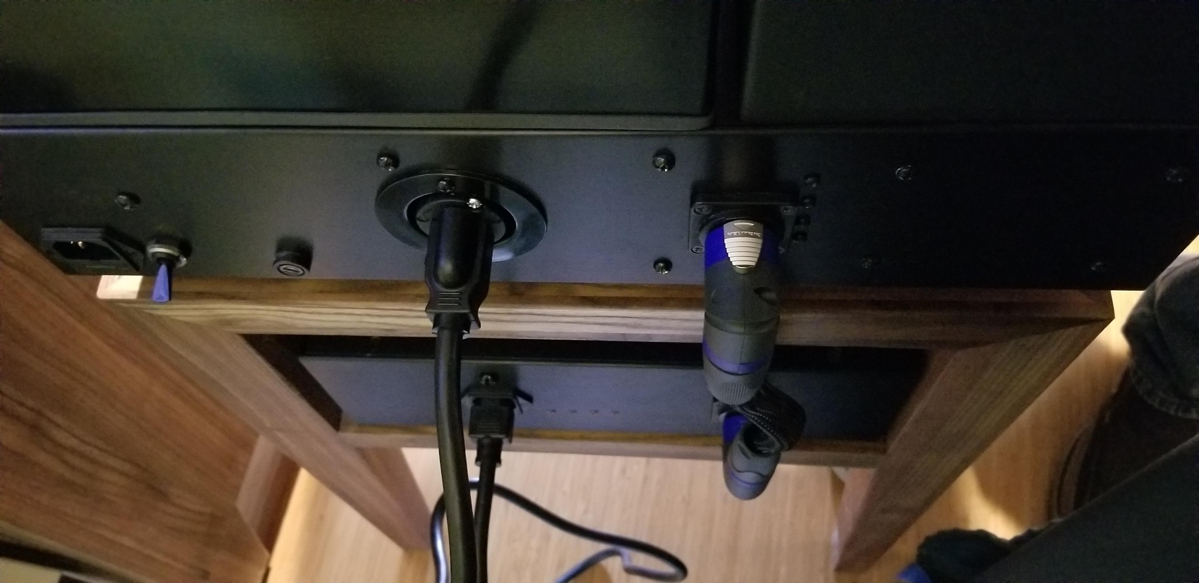

Here's a pic of the inside of the new PS box and a shot of how it's all connected up in my listening room. I put a switched AC outlet on the back of the amp to supply the AC to the new PS box when the amp is switched on, so no extra switches to throw, and still using the same soft-start board in the amp.
