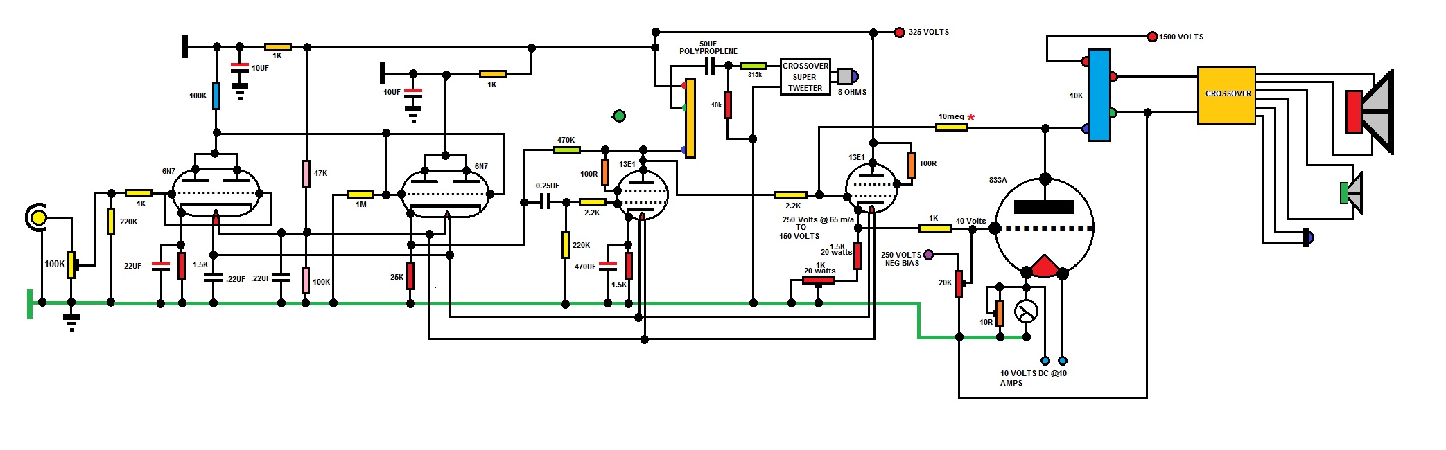

Hello everybody, I am building an 833A amp. pointless going into detail, so I have posted my circuit diagram...any questions comments and or observations then I am all ears and will respond.
Why use the ultra rare 13E1 in your design?.. Do you have a large stock of them or something?
13E1
Hi sorry for the late reply. Your question as to why I am using the 13E1. The front end of the amp using 6N7 into 13E1 is the best sounding amp I have ever built in 66 years. So I decided to use that tested design to drive the 833A. I had originally thought about using a GM70 but then decided to stick with what I knew would work. So the 8 pieces of GM70 that I have are now redundant and I will probably sell them as the 833 Amp will be the last one that I build. Do I have a stock of 13E1's.....I do have 20 pieces which I have had for a number of years, and again I had better get round to doing something with them before I am too old to use a soldering iron

On slight problem - you have semiconductors in the amp - so it's hybrid not tube; otherwise I like it.-My wife, upon seeing the 833C triodes in person - "That's not an amp, that's a Midlife Crisis!"

So was born my 833C SET monoblock project.
The 833C is a ruggedized version of the 833A, with thick graphite plates capable of 400W dissipation with forced air cooling to prevent melting of the glass envelope. See picture #1. It's a BIG tube, and I'll need some sort of containment vessel due to the exposed ultra-HV plate caps...I'm thinking a tempered glass cylinder on each mono.
This tube loves voltage, so I'm building with a B+ of 2300VDC, using a choke input supply. To do this I need a very high voltage PT, and a custom made first choke that can take the pounding of thousand of volts from the rectifiers; more on that in a minute. I've chosen the Hammond 733A for the 833 supply, bridge rectified with 16 Cree 1200V SiC schottky diodes per bridge, and the Hammond 369KX for the input/driver supply. One of the 733A is on backorder from Digikey until early April, but there's plenty to do before that gets here. Seven Panasonic T-HA and TS-HB caps in series will handle the C2 and C1 duties, respectively, with the appropriate balancing resistors.
The schematic is in picture #2. It borrows a bit from Michael Koster's Meteor, with a few differences, especially in the power supplies. I'll be using the K&K Audio versions of the Salas HV regulator to supply the bias voltages. Rod Coleman filament regulators (2 in parallel per 833C) will handle the 10V@10A filaments on each side. Driver is the 6E5P, triode strapped.
The key to all this is, of course, the 12K:4 series feed OPT. It will be custom made by Monolith Magnetics, with a 15kg amorphous core! They are also building the custom first PS chokes to withstand the pounding of the HT. They have guaranteed 8Hz to 60kHz small signal response and full power saturation at 35Hz max.
Full power, by the way, sims to be 195W at 2.5V input.
All this does not come cheaply. Total cost for parts will be ~$10K...but it's not a Midlife Crisis if it doesn't cost at least 5 figures, right!
Stay tuned.
How would you feed hungry grid? Maybe with 6c33, creating more problems..
Using a driver transformer if you can't find the right tube. That's what their job is - to supply current to loads like greedy grids.
I've also got an RCA 807 push pull modulator amp using 807 cathode drive that seems to work quite well. 6 tubes used in all. But a transformer would be another option.
As much as I like the amp you have - the minute I see semiconductors especially in the audio path, I call that cheating ! It's way too common these days.
If it sounds good (arguably better than the options you've suggested), what's wrong with taking the easy way utilizing modern technology?
If it's not your preference, than I understand that, but to call it cheating isn't really fair in my opinion. I think we're all after creating amplifiers that sound good to us, whether that's using a semiconductor or not.
