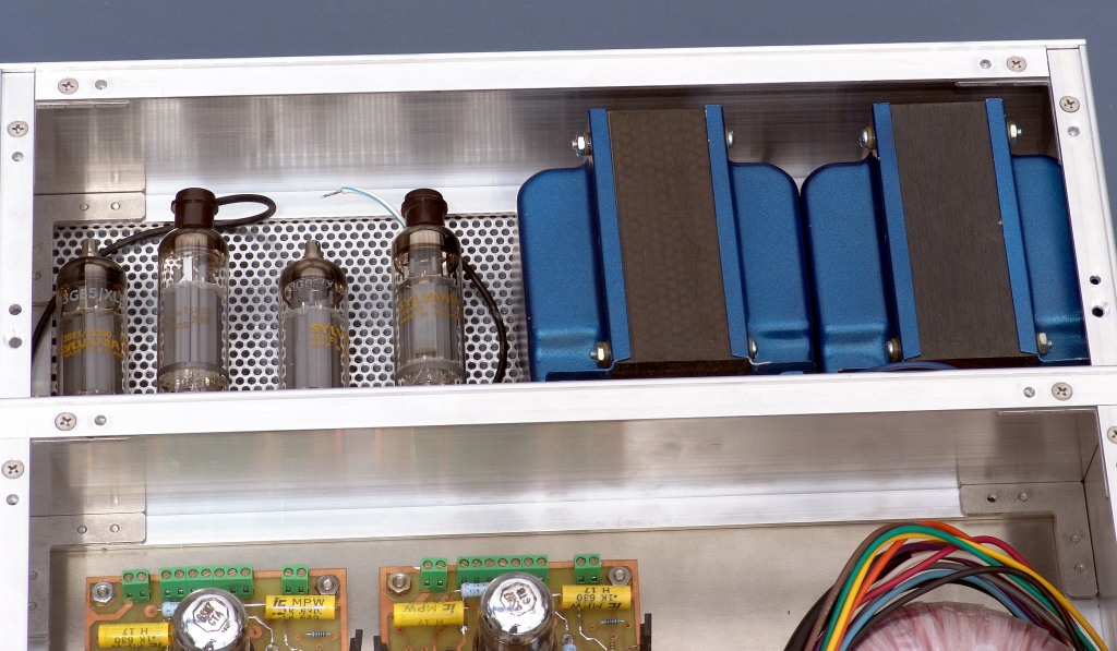

Hey Magz, I've read through this thread a few times, and I think I remember somewhere you talking about drilling the frames of the chokes in your filaments a little bit to be able to insert a bolt to tighten everything up.. Am I right?
If so, was there any trick to that? I can see that there are already holes through the choke that are just kind of blocked by the frame that holds things together.
One of my filament supplies has a fairly noisy Hammond 159ZJ choke, and I thought maybe it would be worth tightening up both chokes a bit.
The trick is to be careful when drilling so that you drill the frame and not the laminations. What I did was to make an indentation in the frame with a punch to center the drill bit, then drill slowly and carefully with a small diameter drill, then follow up with the diameter needed for the bolts. Before drilling I squeezed the frame with big channel lock pliers to bend it against the laminations as much as possible. After drilling I coated the holes with an acrylic conformal coating just in case I scraped any of the lams, then bolted it all together.
I also jammed thin pieces of wood (such as popsicle stick wood) coated with conformal coating (you can use varnish, too) between the center lams and the bobbins wherever there was space.
That helped quite a bit, but I still needed to mount them inside the chassis on Deflex bushings to minimize the vibration transfer to the chassis top.
If you can fit them in the chassis, go for chokes rated twice what your current draw is - I would have used 20A if I could have fit them!

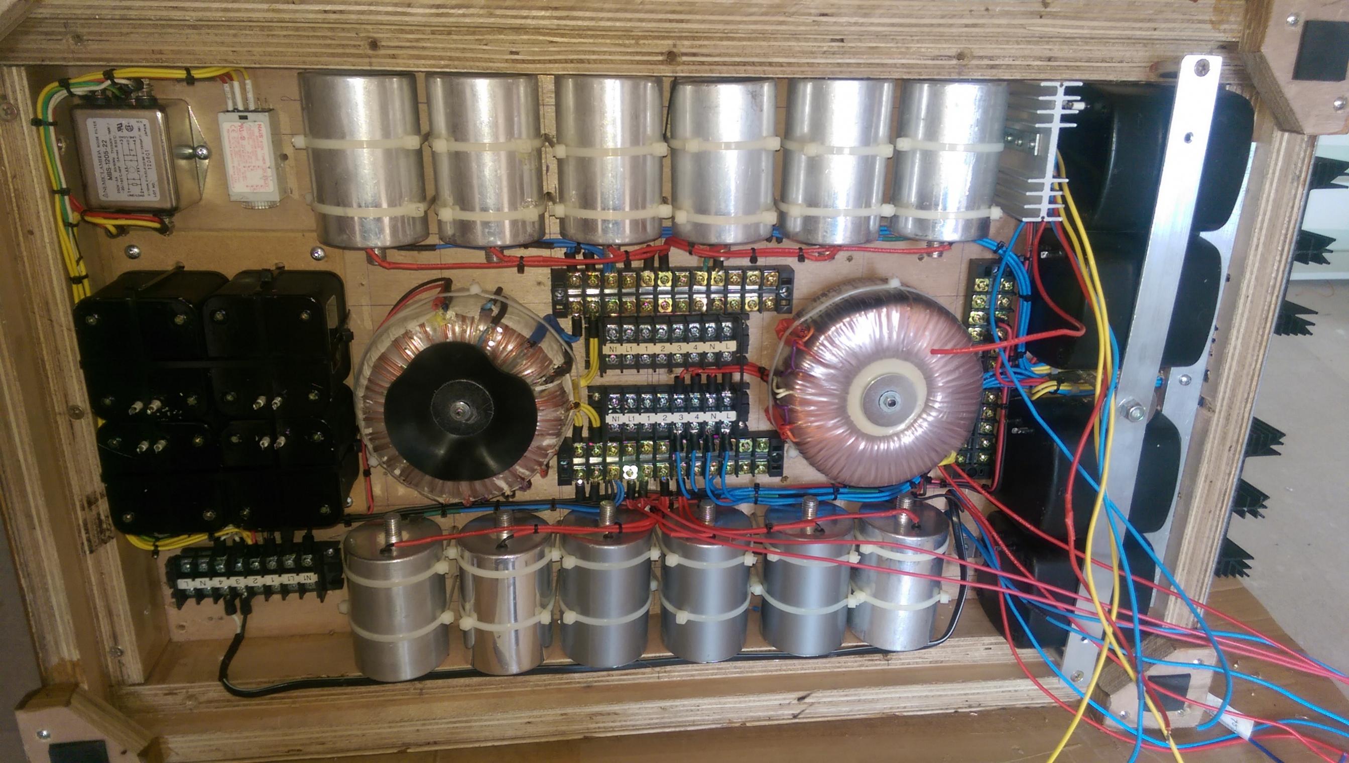

Its been quite a while since I have posted anything here so I thought I would take sometime out to make a contribution. I have been working on building a 100 watt per ch SE Amp....it has proved to be difficult for me as I kept on changing the design and layout. The situation now is that the PSU has become so massive that its getting impossible for me to single handedly move the chassis around. Anyway see the pics....I am almost finished and hope to be powering up (the PSU only) over this coming weekend. If its all okay I will soak test it under load for a few days before moving on to making the actual amplifier..... schematics and more pictures to follow later

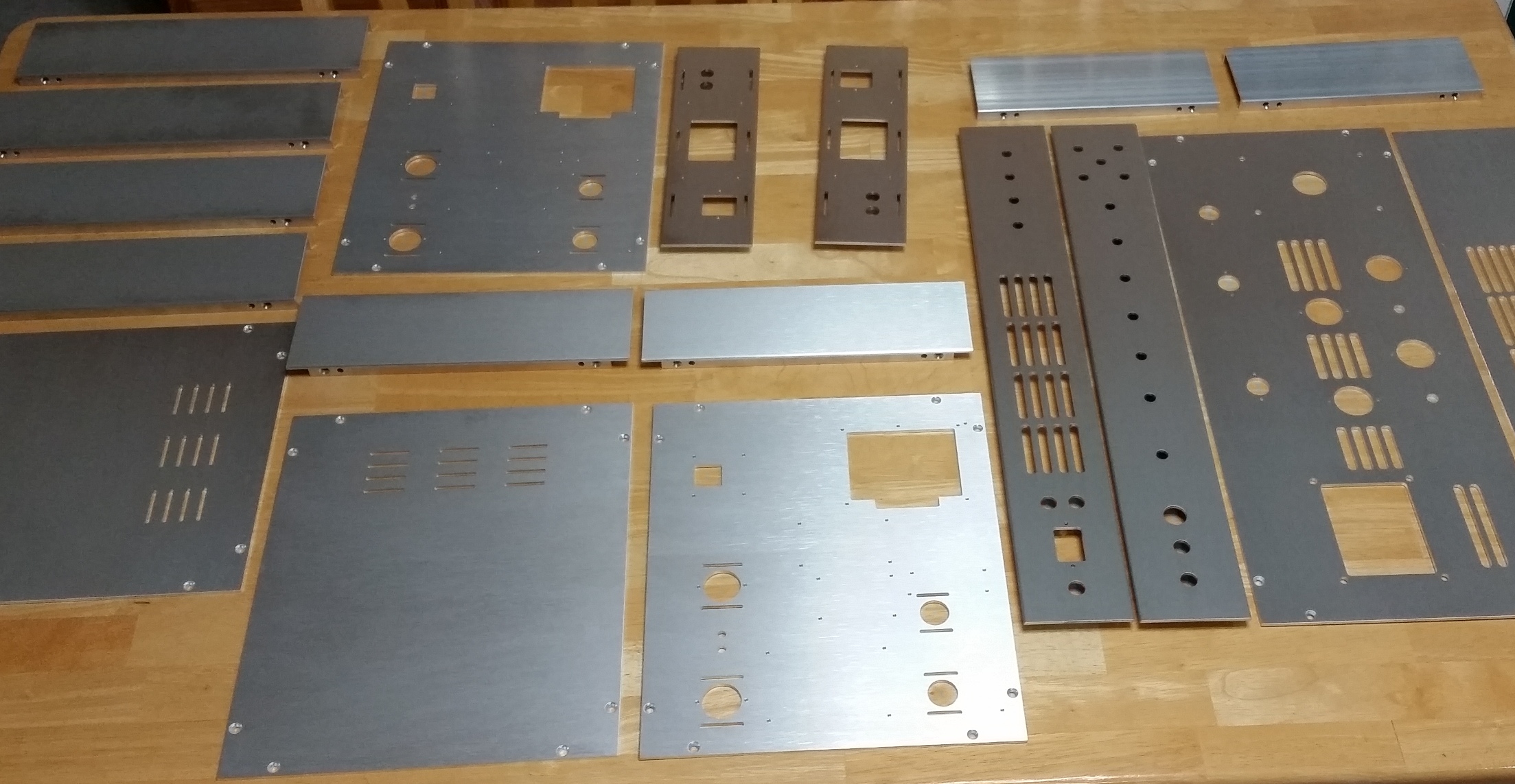

It's not mentioned on our website, but we have a CNC router and can machine holes now too. We need at least a good sketch with hole size and placement dimensions. Though dwg or dxf files are preferred, a pdf or picture of your layout will suffice. Below is a picture of some work we did one weekend.

Well, sort of. There's an "export to dxf" function that generates usable files. Several other drawing packages do the same as well. An accurate dxf file is all we need.
Cool, then you can make the IEC connector cutouts for me. I hate those...

Magz, we can certainly make the rectangular cutouts. No worries.
