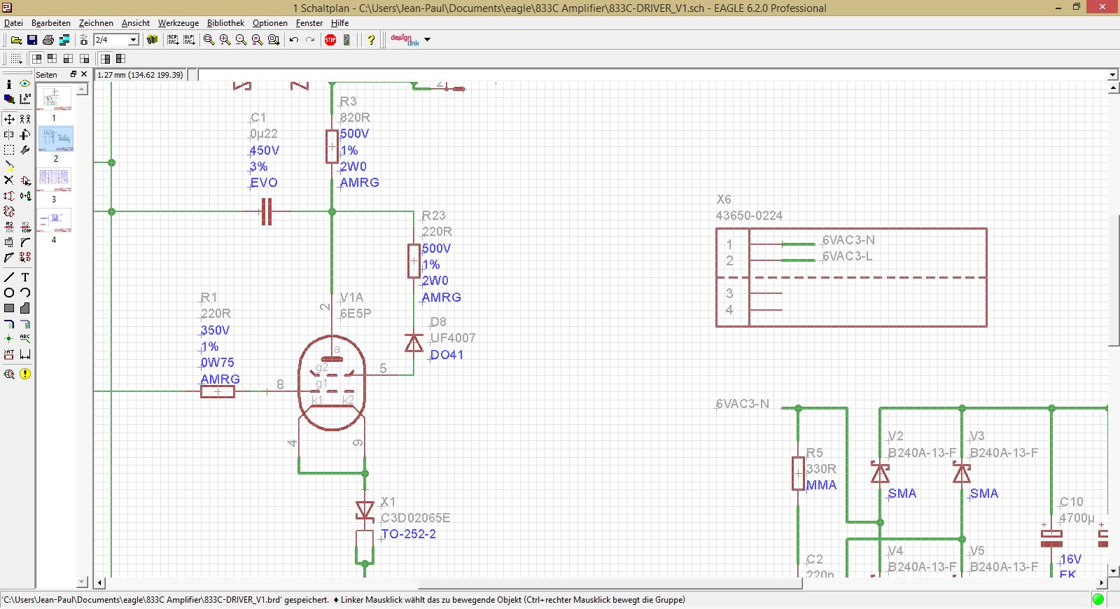

I strapped the 6E5P screen grid to the plate using a 200R resistor plus a
UF4007 diode (cathode away from the plate).
I haven't seen a screen connected this way before.. Does the diode make it basically a DC supply, so it's pentode-like. But super easy way to get a screen voltage?
Nah, it's a controversial subject...some swear it sounds better with the diode there because it prevents plate currents from interacting with the screen grid; others say it makes no difference whatsoever from an engineering perspective. I put it in because someone whose opinion I respect said he hears an improvement that way.

In the case of connecting a Tetrode or Pentode as a Triode, by strapping the Screen Grid to the Plate, the valve behaves as a Triode. Inserting the Diode as described has a similar effect on the electron/current flow but the sound will still remain the "triode" sound - albeit it cleaner and brighter.
... this way?
No the opposite way. Cathode toward the screen. I'd also make sure that the resistor is right next to the screen connection.

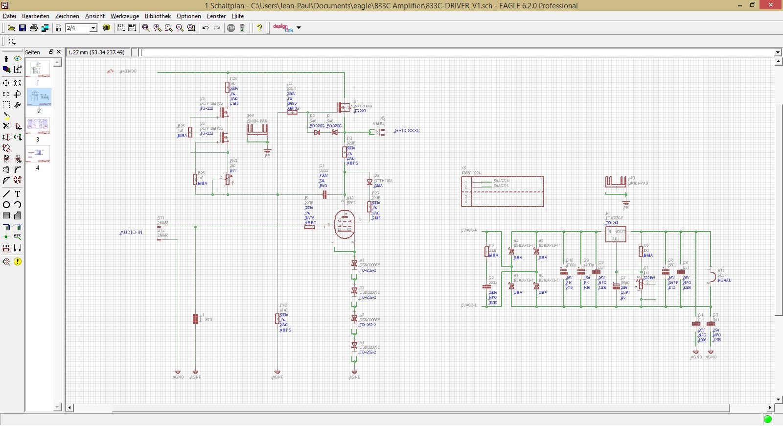

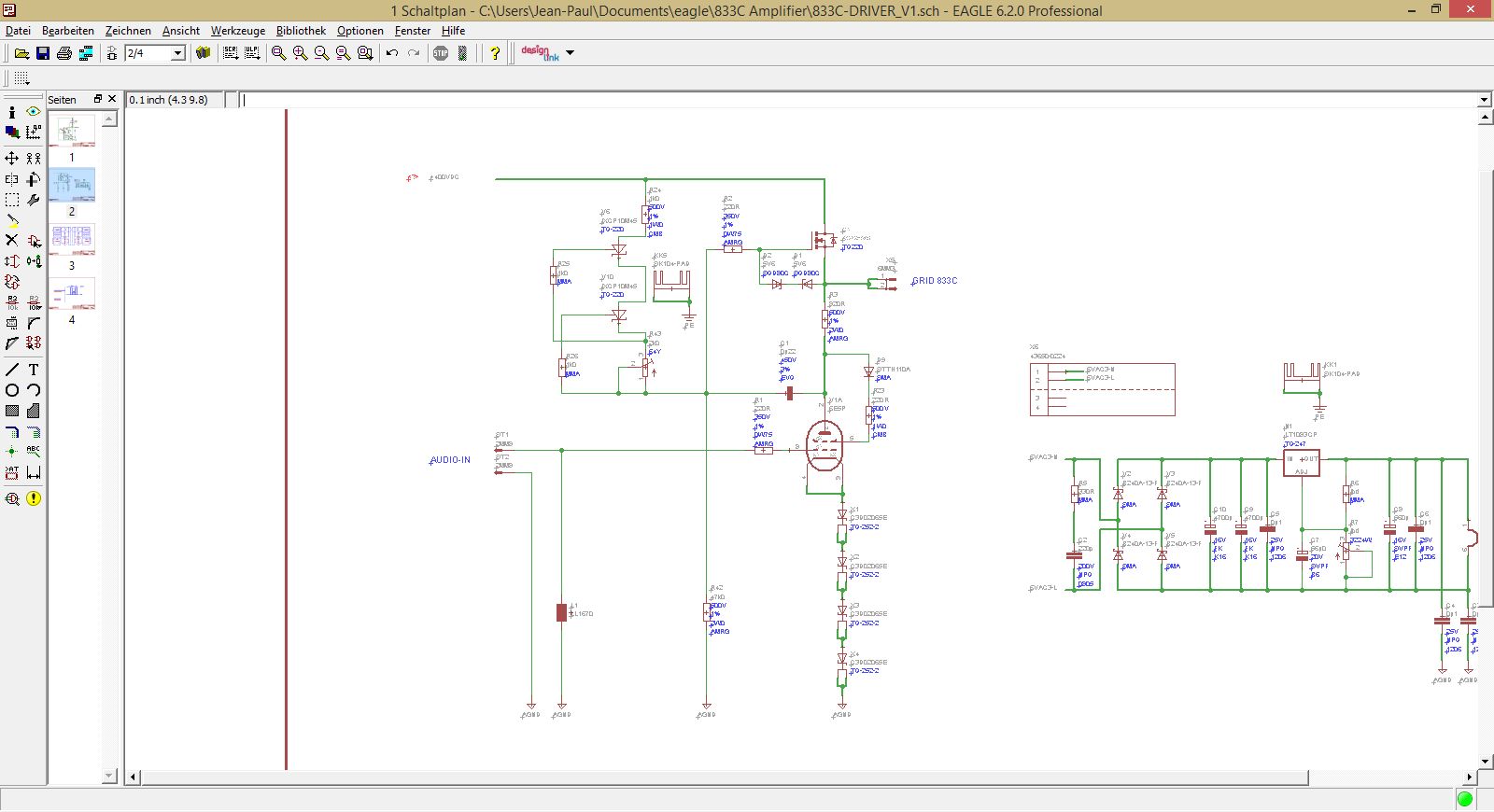

I will post later the last schematics with all the corrections...

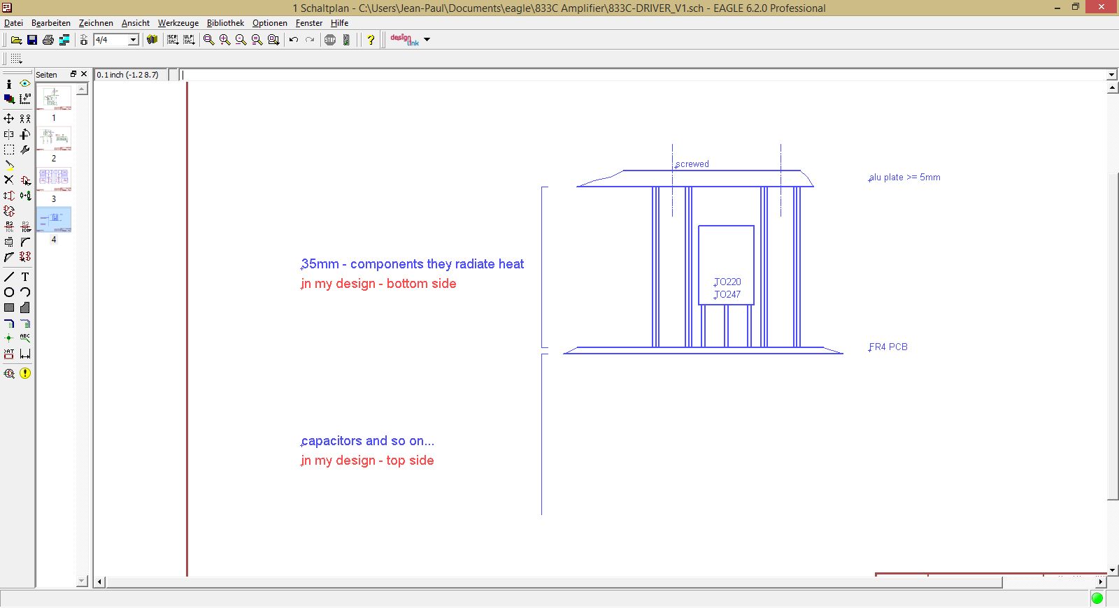

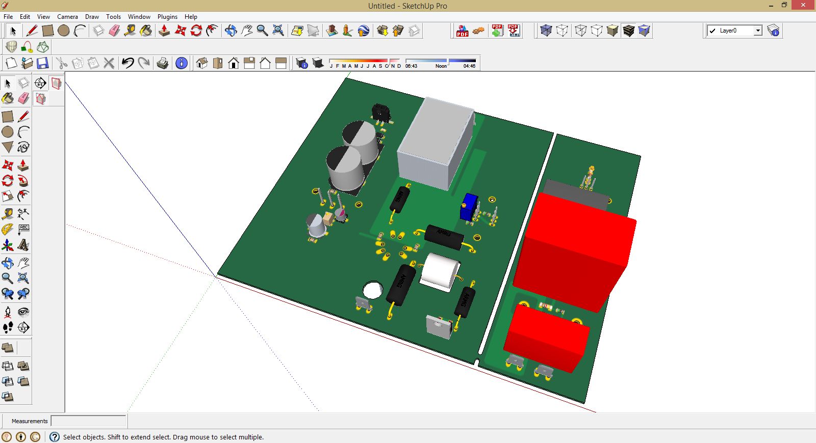

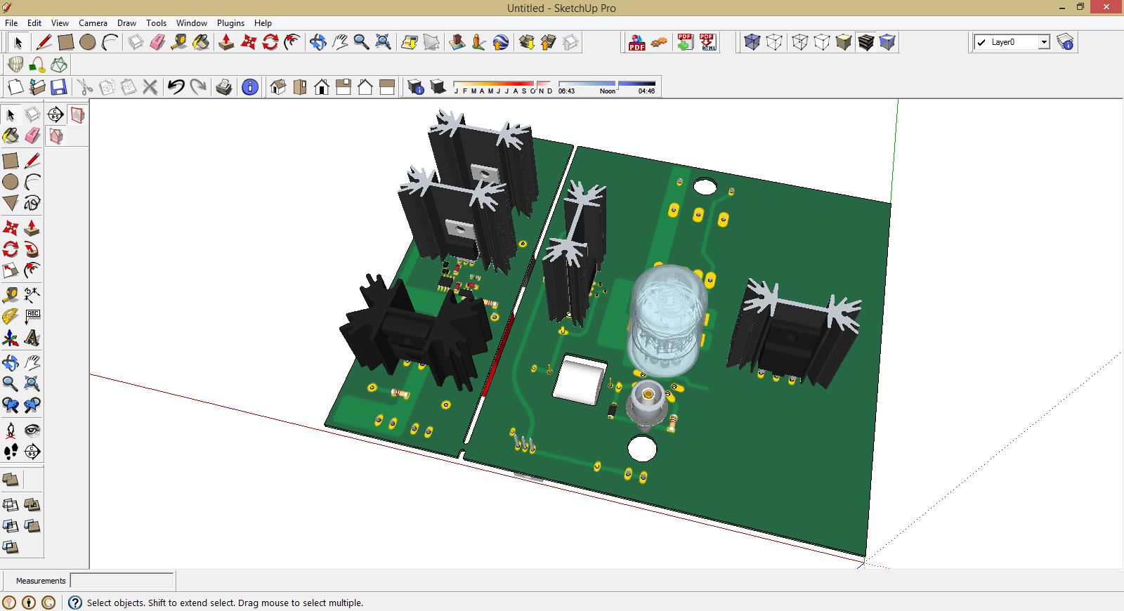

What do you think about puting the 833C tube with fan in an own case?
High voltage connection with LEMO ERA (or SubD high voltage contacts) and heating supply with power connector?

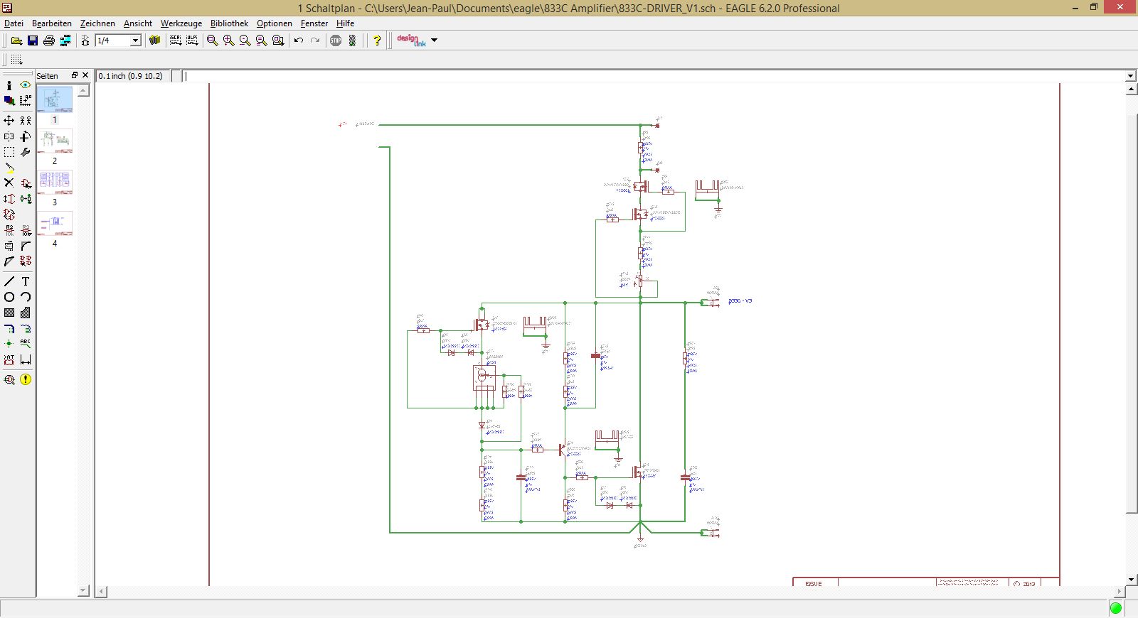

as promised...
It's very hard for me to read those schematics, but why do you have zener diodes where the MOSFETs are supposed to be in the voltage reference for the AOT2N60?

There are no doubt many ways to skin this cat. You will have to decide what works best for you. I preferred to keep all the ultra-high voltages in the same chassis as close as possible together; you may feel differently.
Whatever you do, be VERY CAREFUL! These voltages will kill you very easily.
they are switchable current regulators and the many peoples use this symbol!
correction done!
correction done!
