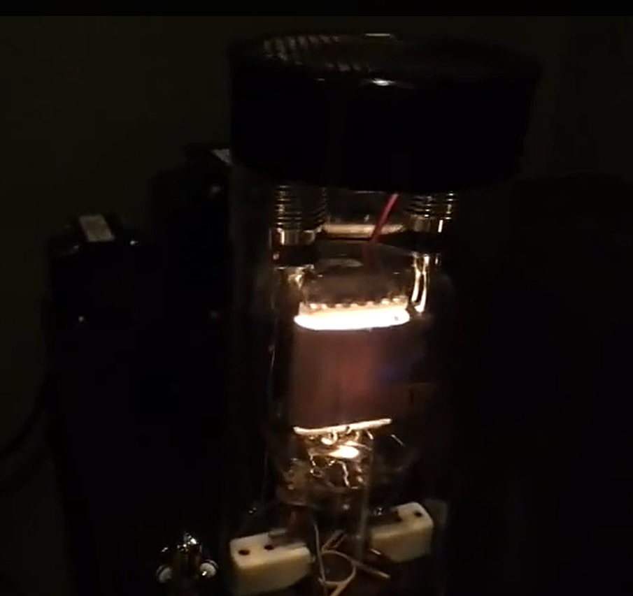

Talking of photos, any chance of a series of low light shots to show off the 833c glow?
If you watch the video in post #707, there's a point in the middle where I turn the lights down - you can see the glow then.

The metal plate 833a has its getter deposited on the plate and it needs to be at a minimum temperature to function. If the plate is not at least glowing dull red, the 833 is effectively running without a getter. Not good for tube life.

Because the sensor of your camera isn't corrected for human eyes. Maybe an infrared filter helps.

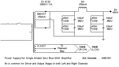

...anyone know of a good 2300V regulator???!!!
Being from Central NJ, you might know pppl.gov. We built 40kv 60A series regulators (gated) using Eimac 8973, as well as some mighty big amps using 8974 and others. The 2300V regulator would force you to use another chassis, cooling system, etc. It's not like a 400-500v 6880 regulator because of the clearances for HV. We used a floating (at the output voltage) tube deck, 450V on the screens, and grid drive via fiber optic cable from a regulator board running at ground potential.
Shunt, primary, or negative leg regulation would be better, but still won't fit your current volume. 🙂
My recommendation would be leave 'em alone and kick back and enjoy the music!

I solved the regulation issue by regulating the AC itself, instead of the B+. Each monoblock runs off a PS Audio P5 regenerator, set to a regulated 117V output, which is the rating of the 2500V power transformer. Output tube current is solid as a rock now wherever I set it. I already had one of the P5s, so I bought another and balanced the loads (source, tube preamp and mono amps) so that both P5s are under close to the same load. Both are running at ~84% of capacity.
I thought I had read the whole thread but I must have missed that. Perfect.

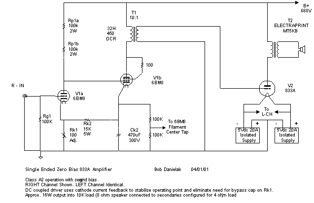

I try to find the UPSC600 diodes for cathode bias, but I can not find, I can use this model CREE CSD20060, any more?.
Actually, my schematic only shows those UPSC diodes because I had a spice model for them. I actually used Cree 600V, 1A SiC diodes in the build.
