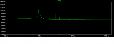

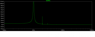

However, I did simulate the amp in LTSpice. Below are the FFT results at 38W (just before the onset of A2 operation) and at 84W (well into A2). At 38W I get about 0.45% second harmonic and less third. At 84W I get about .76% third harmonic.

Wow, 2KHz and you get that? Pretty dire...

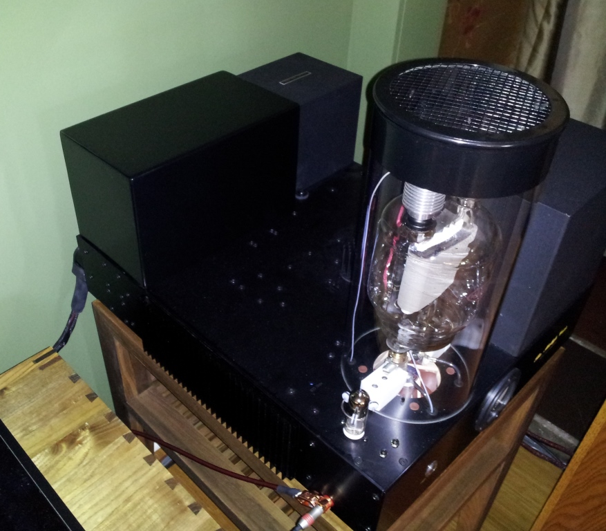

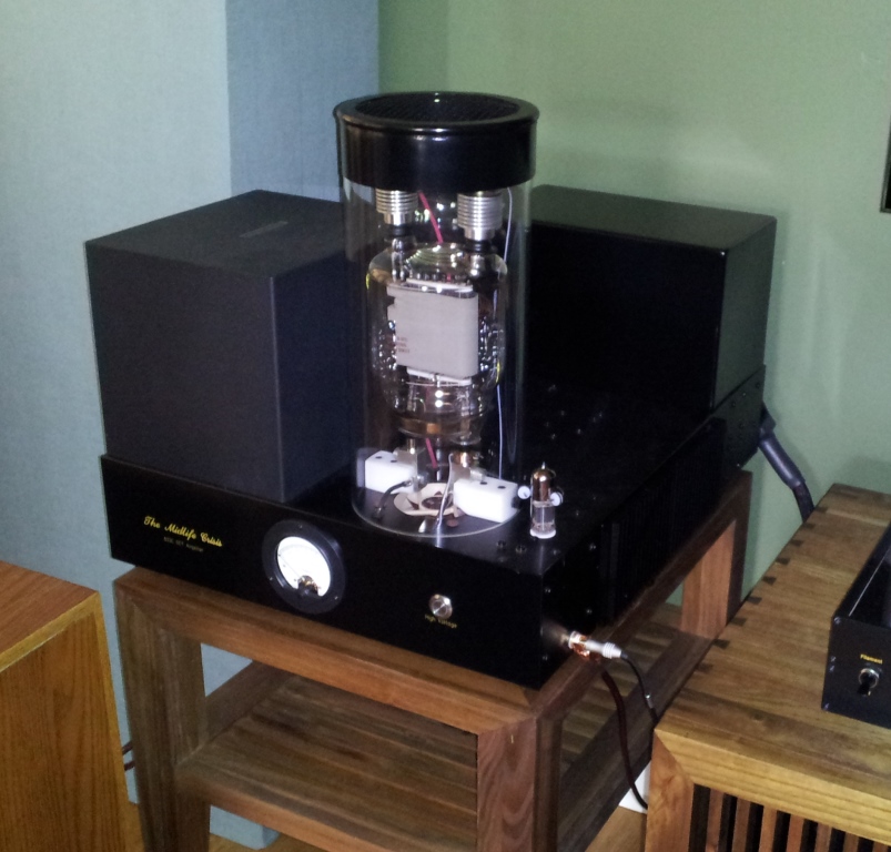

I was a little bit unhappy with the appearance of the Hammond 733A transformers, with the lumpy, uneven black spray paint job they came with, so I had a pair of aluminum covers welded up and then had them powder coated satin black (see pictures). They cover both the 733A and the 369KX transformers and give each mono a more finished look, I think.
Beauty, I like how alloy can be TIG welded and have enough meat in the weld to be rounded off with a flap disk. Top notch!
They are lovely looking amps. 6E5P is a cracking driver😉
Cheers
Matt.
Cheers
Matt.
Love the 6E5P - I bought 50 of them so I don't run out.
Funny thing is, the Monolith OPT and choke are actually black, a black metallic that in normal light looks pretty close to the new covers in color. Whenever I take a picture, though, the metallic particles seem to catch the light and make them look grey...they're most definitely not.
I guess the best description would be charcoal black for the Monolith coating color in typical room light.
