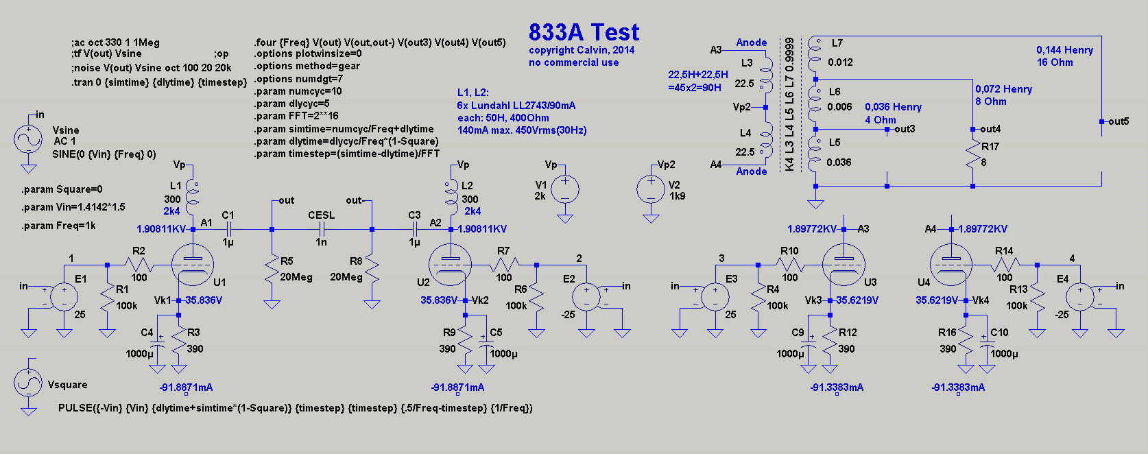

Attached is the basic sim file.
The model of the 833 seems to follow quite well the DS graphs and gave the expected (at least from me) results.
The circuit idea is as follows.
As input I´d like to use a audio transformer 1:1:1 to allow for balanced and unbalanced input, to achieve galvanic isolation against hum loops, and to achieve the required phase splitting, as a symmetrical ESL needs a pushpull drive.
The driver is modeled here as vcvs with a gain of appr. 25 times.
The DS graphs of the 833 indicate a plate current of ~90mA at a anode voltage of 1900V and a grid-cathode voltage of -35V.
If the grid is ground referenced a 390Ohm resistor would set the required bias points automatically.
As anode load I thought of using a choke, to achieve double the voltage swing.
I found the LL2743 anode choke by Lundahl, with following values:
Ibias: 90mA, Imax: 140mA, 50H, 400Ohm, 450Vrms(@30Hz).
Could a series connected sixpack of chokes suffice?
The values would be 300H, 2k4, 2700Vrms (capacitive load reduced to ~1/6)
Apart from the voltage drop due to the 2k4 copper resistance it seems well suited for the task.
It´d spare the hassle to have a specialized anode choke wound.
Up to +35Vpeak signal voltage (equalling ~25Vrms) there´d be no grid current and the output would be 1.78kVrms (pushpull).
The KR Kronzilla driving through the 1:50 step up transformer gives 1,2kVrms, which is already close to the limit of the panel (its a highly efficient panel, playing at appr. 105dB@4m at this voltage level).
The triode would limit at around +-50Vpp input, the last +15V signal overhead requiring up to 20mA grid current, which is the point the tube glides into A2 mode and THD rises.
For lab experiments I could use any power amplifier of the 100W/8Ohm class as it could supply for 28Vrms grid signal.
So far it seems that the 833 presents just the right set of parameters for a simple to drive ground referenced grid, cathode resistor biased Tube stage.
Would it also be possible to replace the anode chokes and output coupling caps by a pushpull transformer 10k:8:4Ohms directly?
After the sim this should give around 80W of power, without changing anything els in the ircuit.
If it has been too offtopic just delete the post.

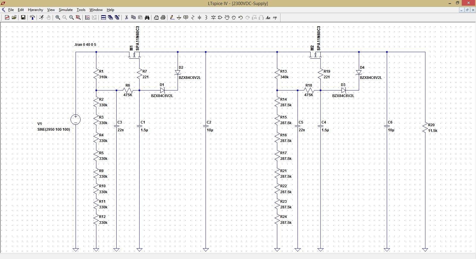

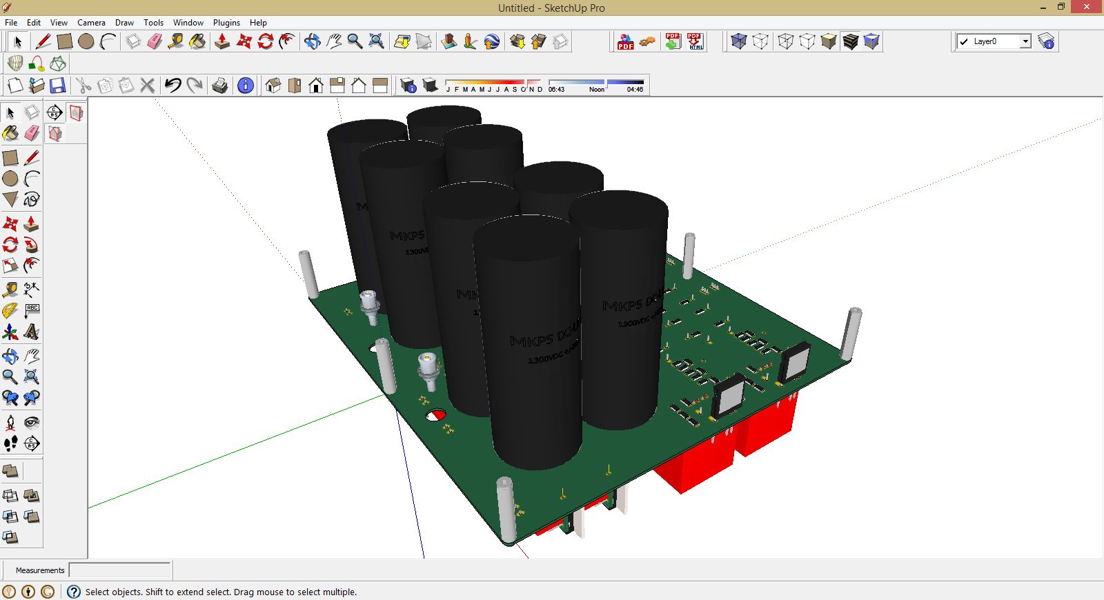

why not a cascaded mosfet (IXTF1N400) stage for the HV?
HV transformer 2692Vrms + Bridge (4x 8xC3D10170H+2M0/RNX075-0µ01/3000VDC/MKP10) + capacitor (series of 8x 260µ/MKP5+bleeder resistors) + electronic choke for 2300VDC@200mA.
Sure, I guess one could do that. Right now the amps sound so good I'm not touching them, though; I can't imagine being more pleased. I've moved on to shoehorning a DAC into my 26 preamp as my winter project for this year.

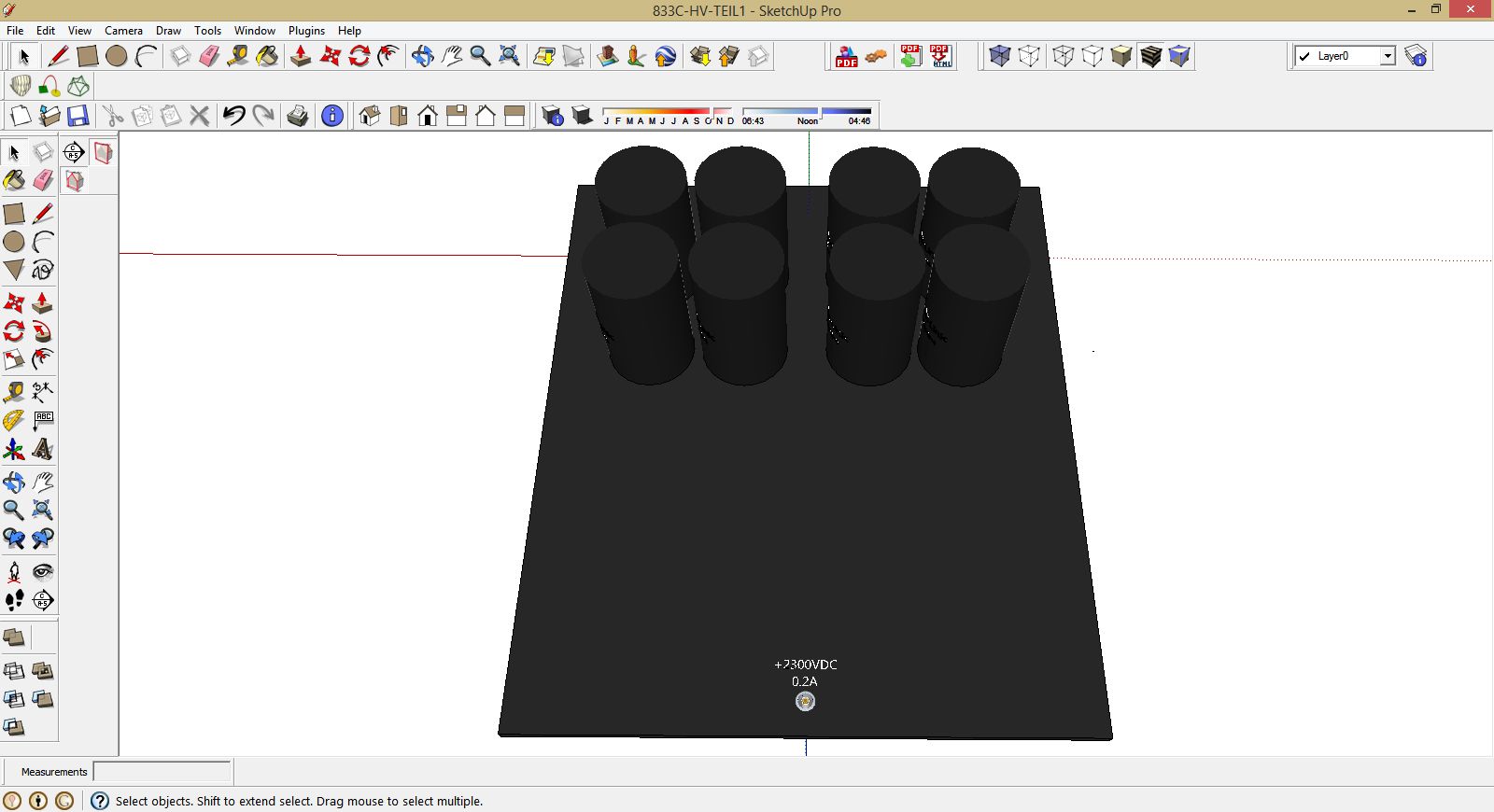

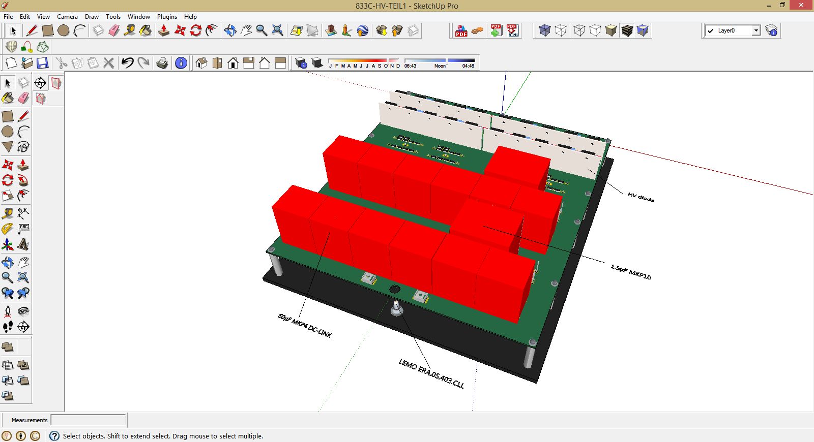

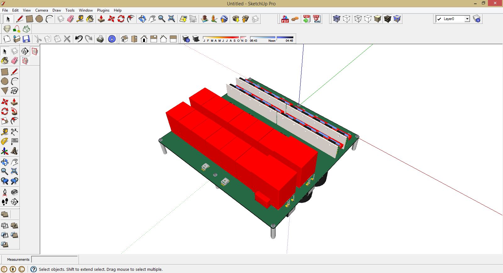

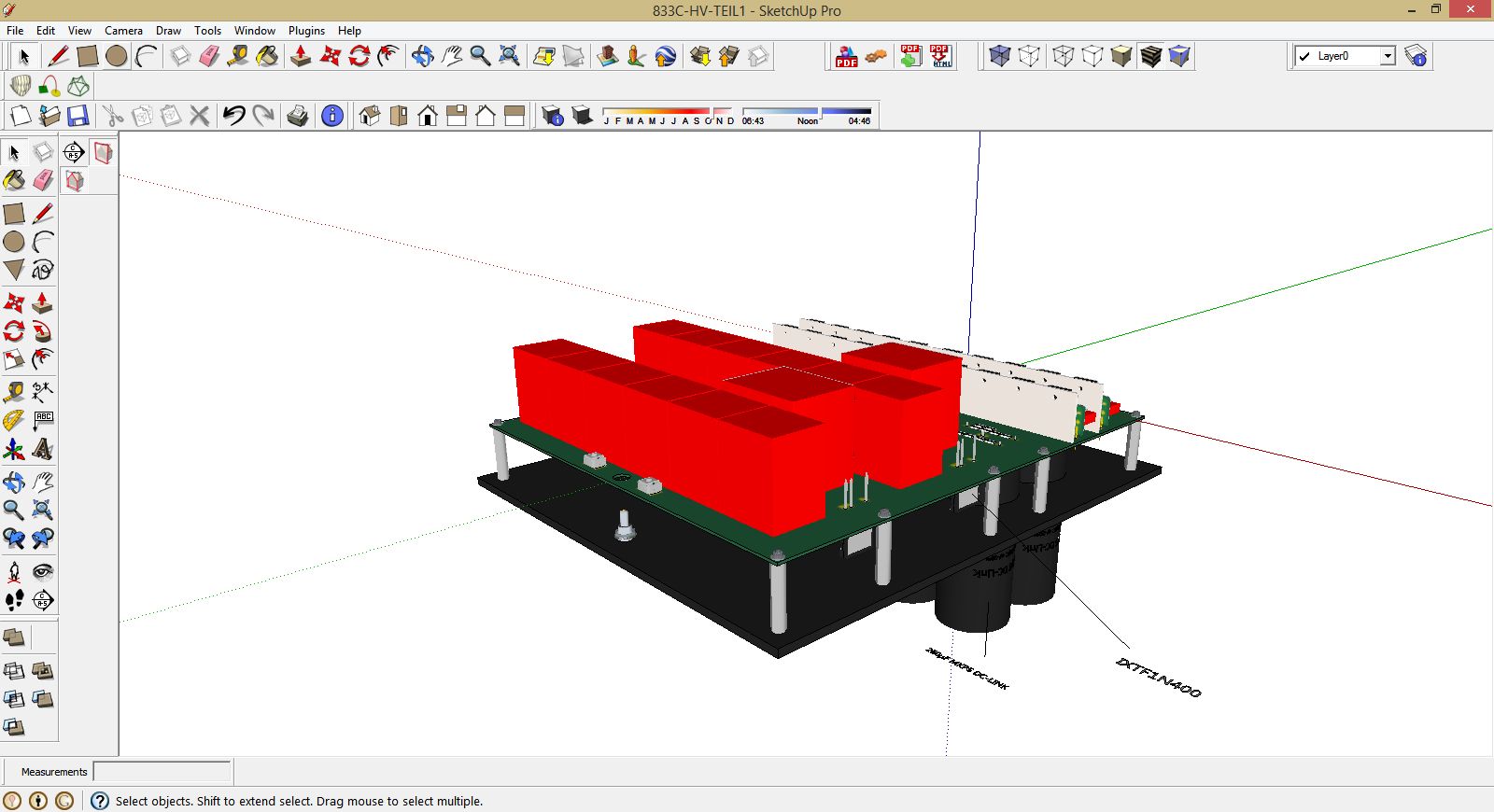

... the high voltage PCB placement finished. Switching to the driver stage.
The PCB is 4 layers (FR4 --> 10kV/mm); faston 6.3mm for the microwave ofen fuse onboard; no electrolyt, M3 faston for central ground and high voltage for the OT.

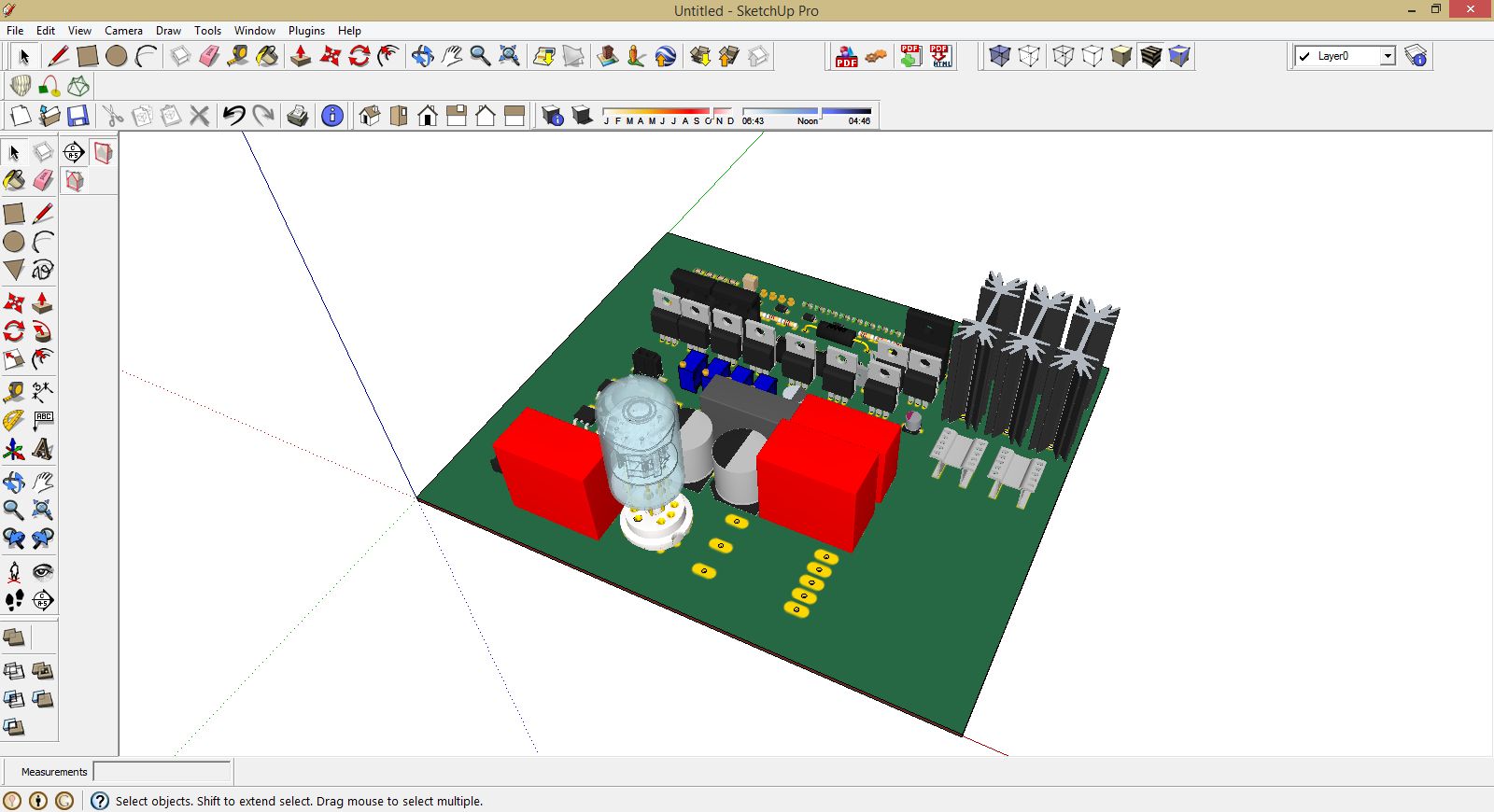

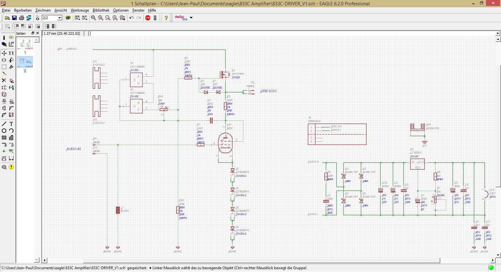

... the components for the driver stage (last post to clarify the wiring of the MOSFET voltage reference)...

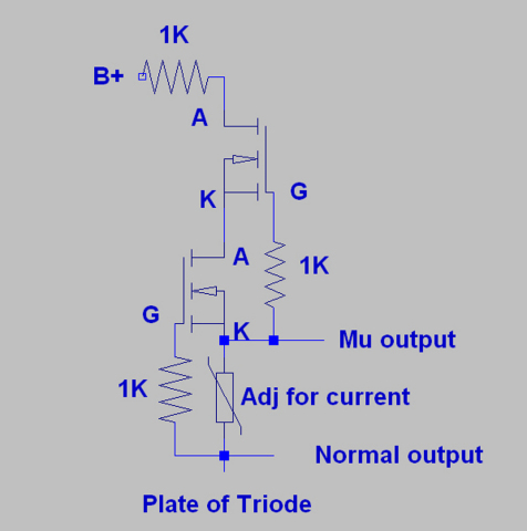

is this correct (V8, V9, R43 and R42)?
If you're asking me...
I didn't use R42, just a grid choke with no additional resistor (it's optional).
I strapped the 6E5P screen grid to the plate using a 200R resistor plus a
UF4007 diode (cathode away from the plate).
I'm not sure what you're doing with that Vref...it should be a cascoded CCS set to few mA, feeding a resistor, with an adjustment pot. The only connection to the driver circuit is to the gate of the AOT2N60 (from the point between the pot and the resistor).
CCS looks like the attached. Connect a suitable V source to the top, add the resistor at the bottom (where it says "Plate of Triode") and connect the "Normal output" to the circuit in my schematic in post #1, where V7 is connected. If you want 216V, and use a 47k resistor, you'll want the CCS set to about 4.6mA. You can then adjust the current through the CCS using the pot to get the voltage you want on the gate of the AOT2N60.

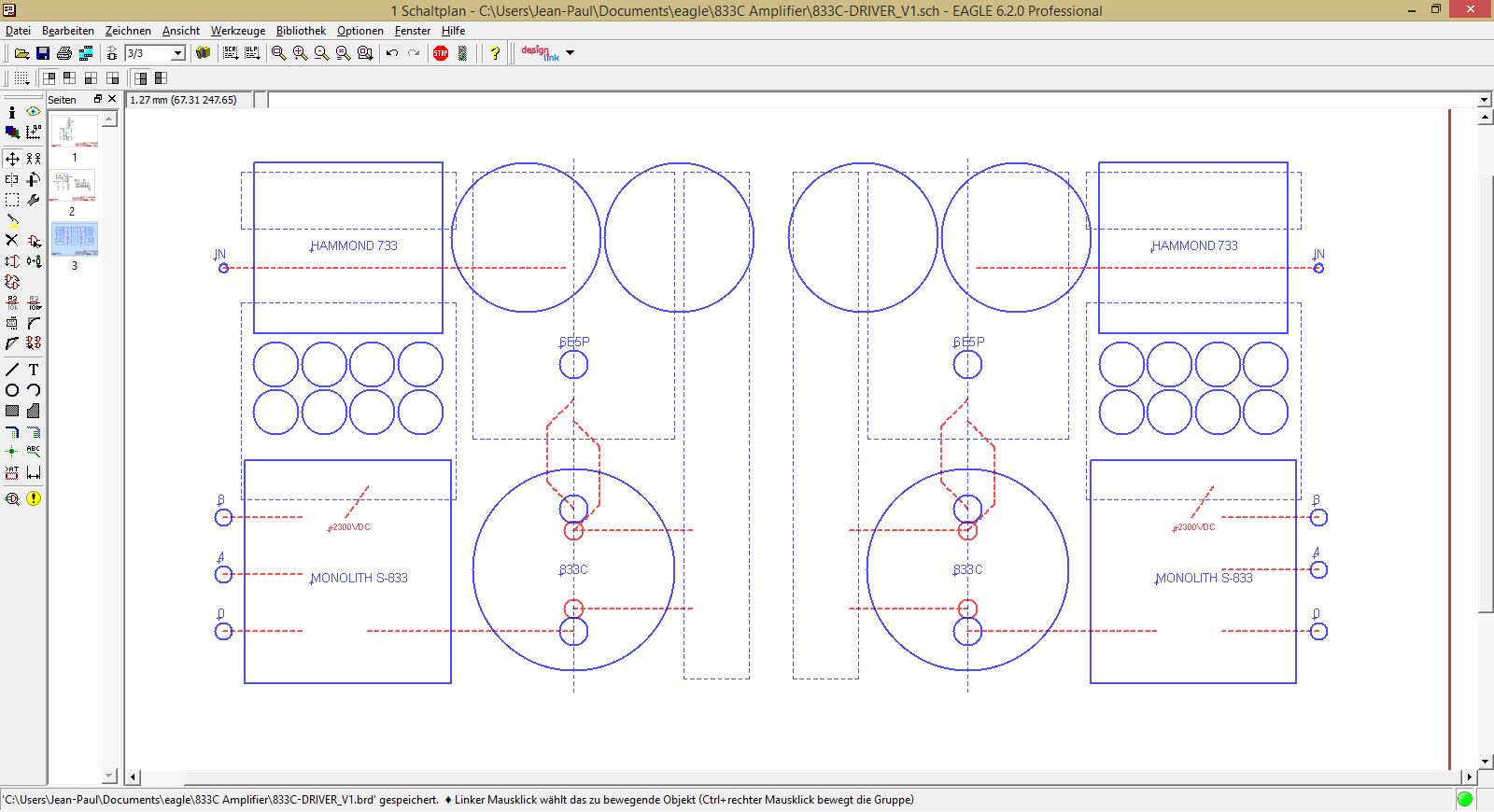

... preliminary left and right symetrical placement...
Nice and symmetrical, but I'd try to get the signal as far away from the power supply as possible. In my amps the PS is in the back of the amps and all the signal wires are in the front 25%. Layout is key; the noise floor in my amps is 300uV, without using any shielded wires for the signal.
