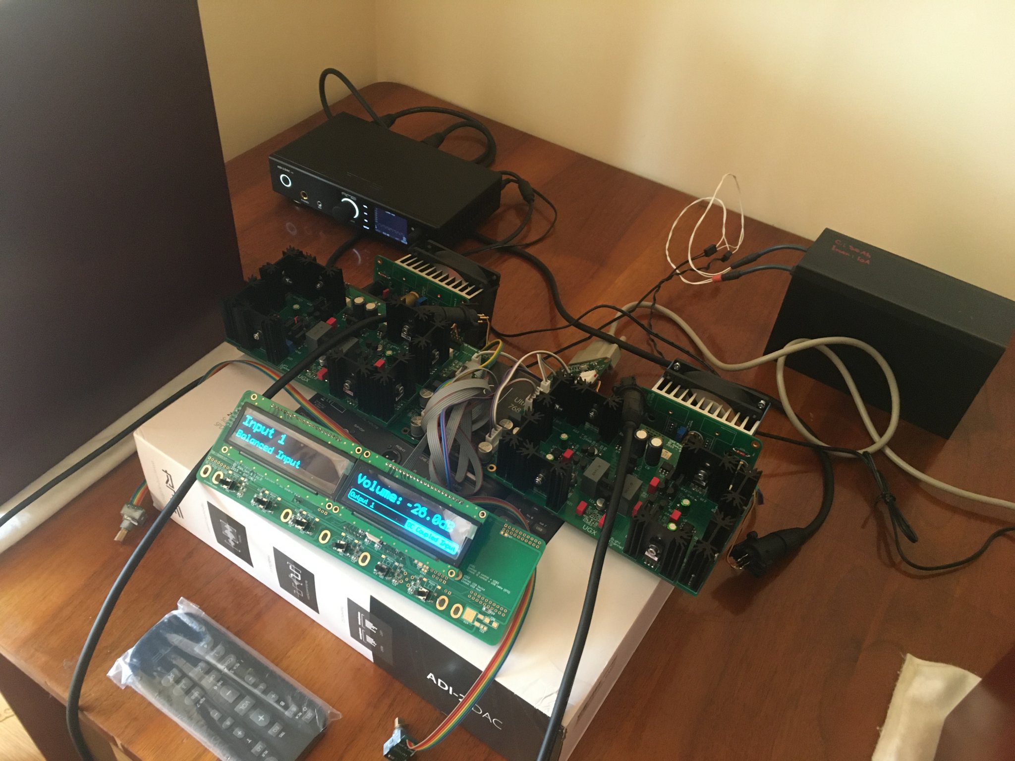

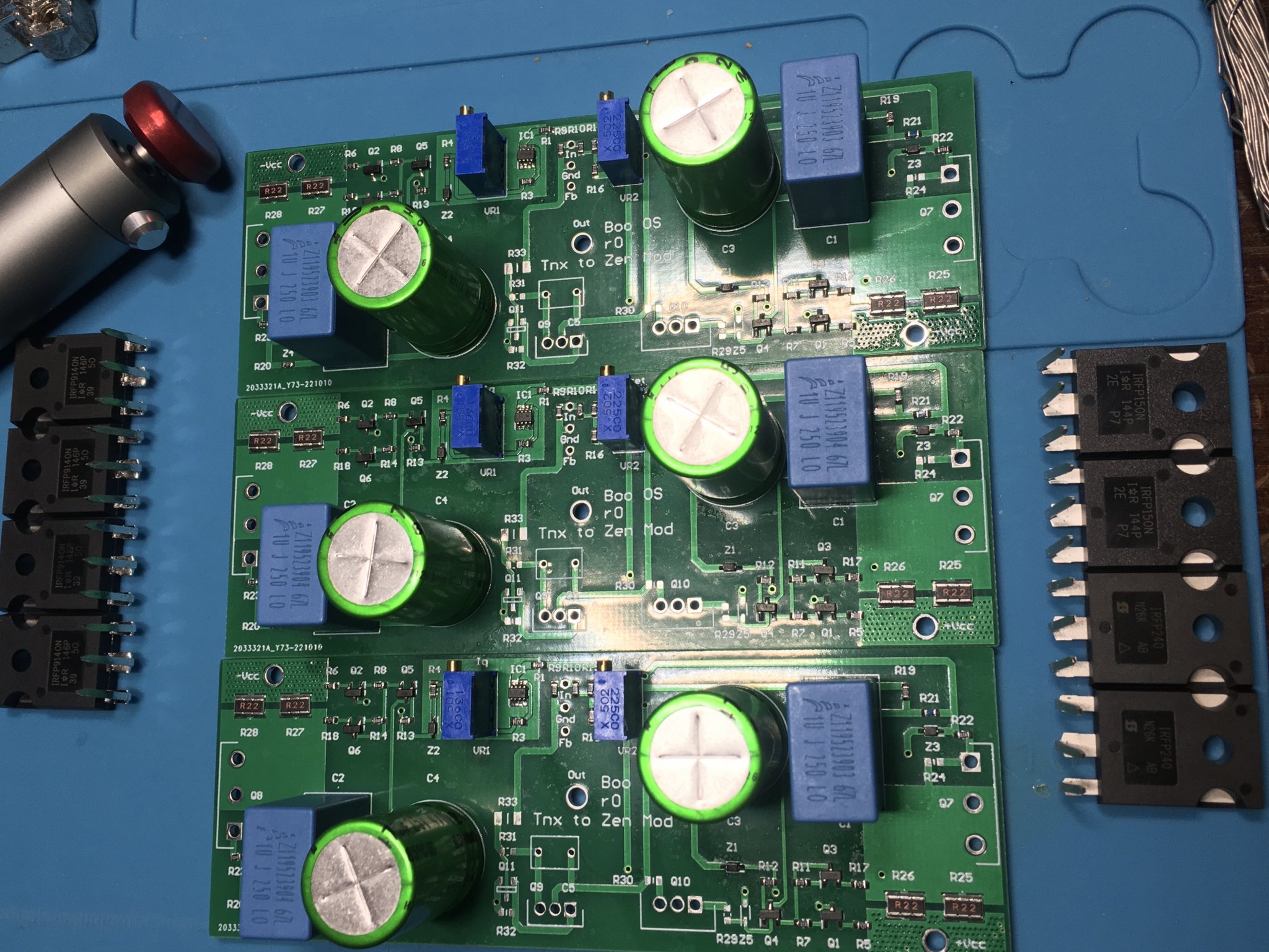

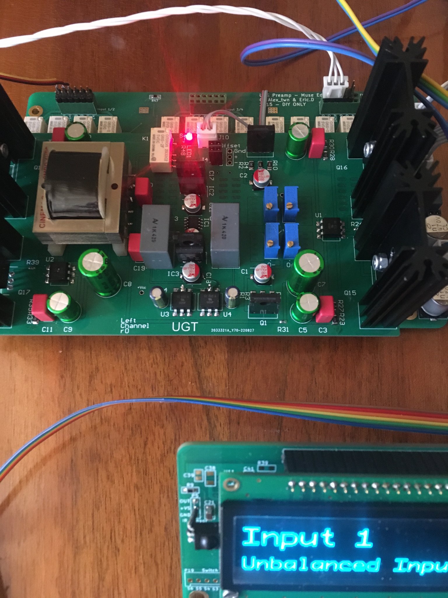

I attached a few photos meanwhile I replaced the Aleph J boards inside my amps.

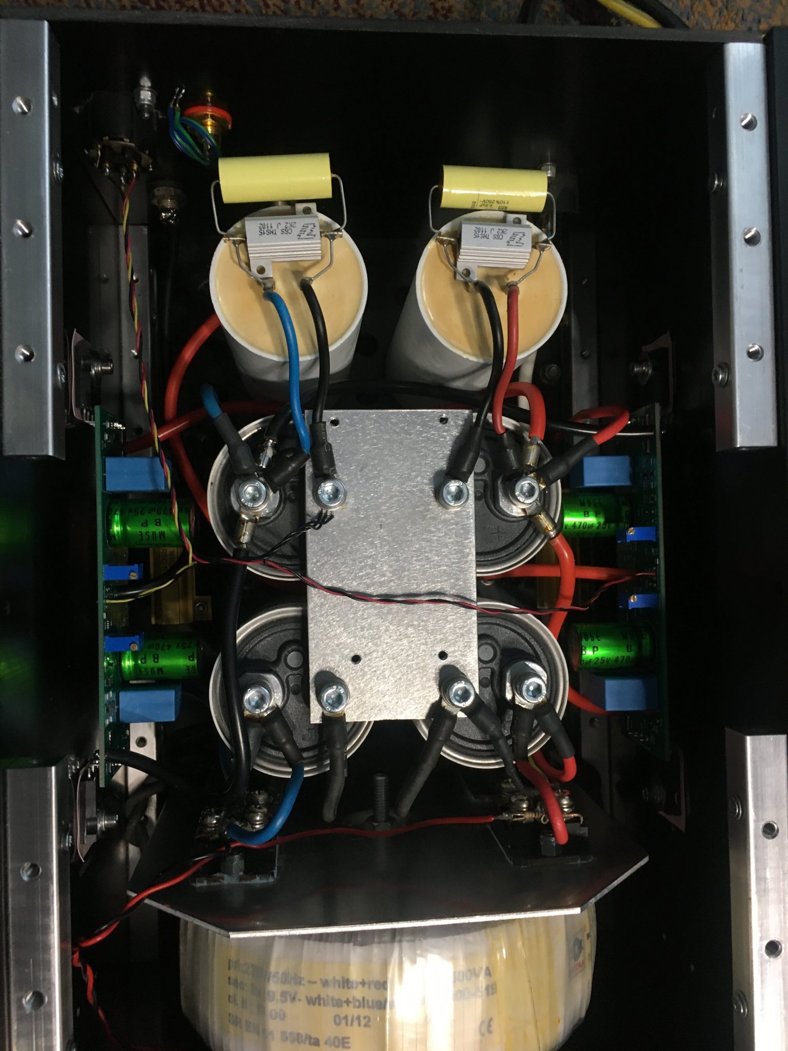

Since I was there I measured also the impedance of the ps caps and got ~5milis for the 47000uf ones and 10milis for the motor run ones.
Don’t know what values these had initially but now after 10y they are better than the specs in the datasheet this if my tool measured ok.
I used for the measurement a battery impedance tester which works at 1khz and measures fine lithium cells.

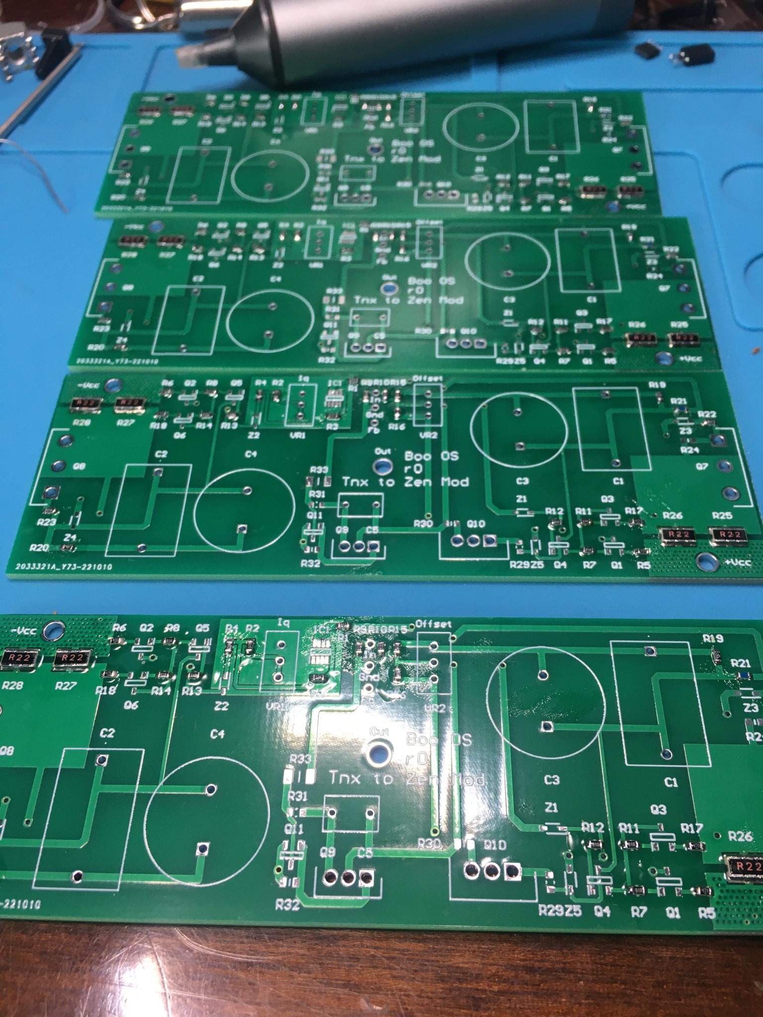

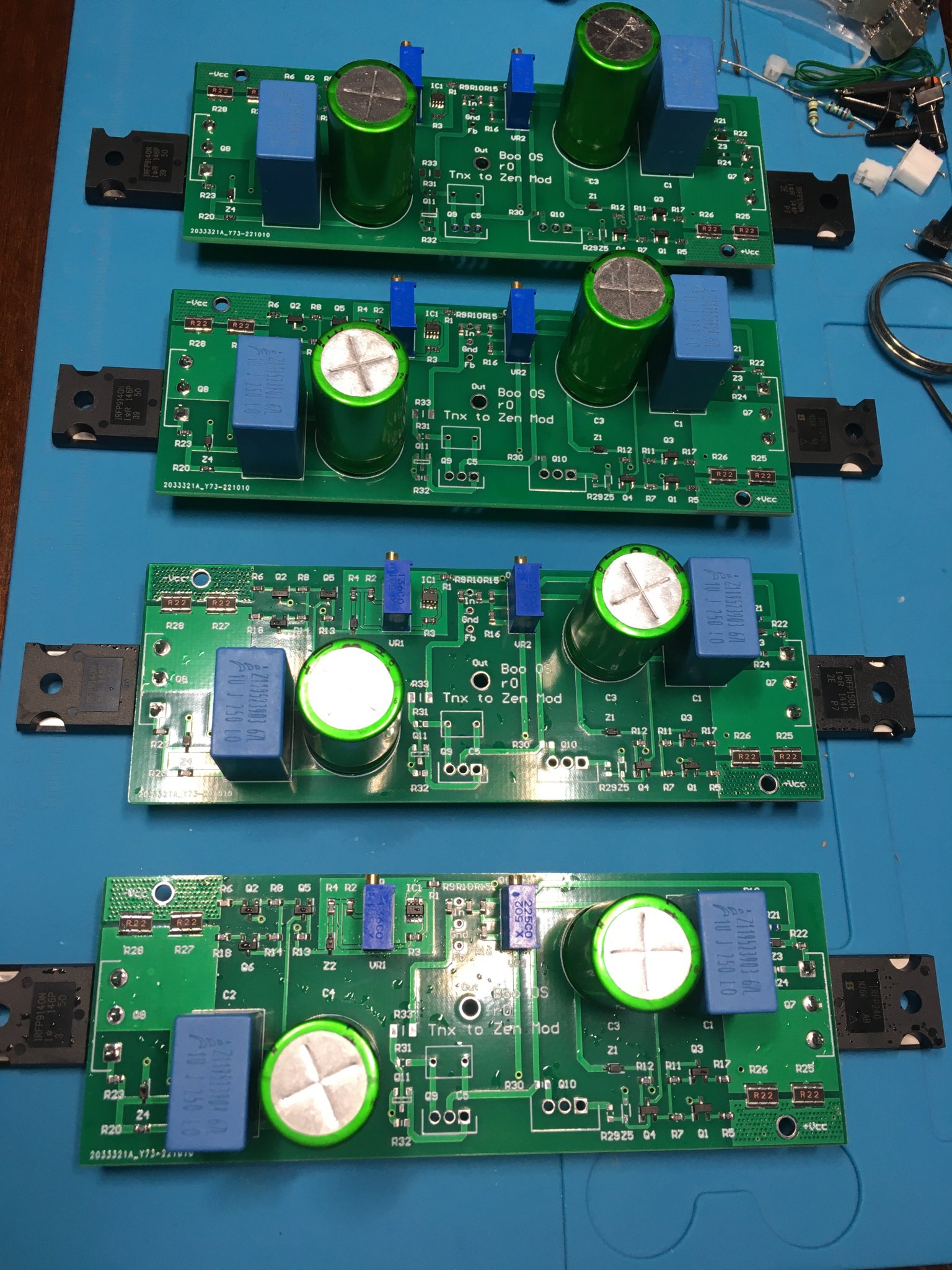

I didn’t encounter much trouble putting together the amp pcbs. I had a few unsoldered resistor pads that I spotted first of mounting the amp pcbs to the heatsinks.
The real trouble that I encountered was when I mounted the pcbs to the heatsinks because the space there is very tight. The reason about the space forced me to draw my own pcbs.
First of starting the amps I set the bias trimpots for the minimum bias. When I powered them on the bias was ~750ma cold .
Then I slowly set to 1amp, it increased a bit as the amps warmed up.
I didn’t touch the offset trimpots initially, left them in the middle position as they came from the producer.
At first power on the offset was less than 200mv which I trimmed easily to 0mv.
When you turn them on after first setup you get 160mv offset that goes to 0mv in a few secs.
When you turn the amps on/off there is no turn on/off thump.
At power on you can hear the sound “going on” with this I mean that initially the sound is weak and distorted and in a few seconds it goes ok, like with vales until they heat up. You get same behavior at power off.

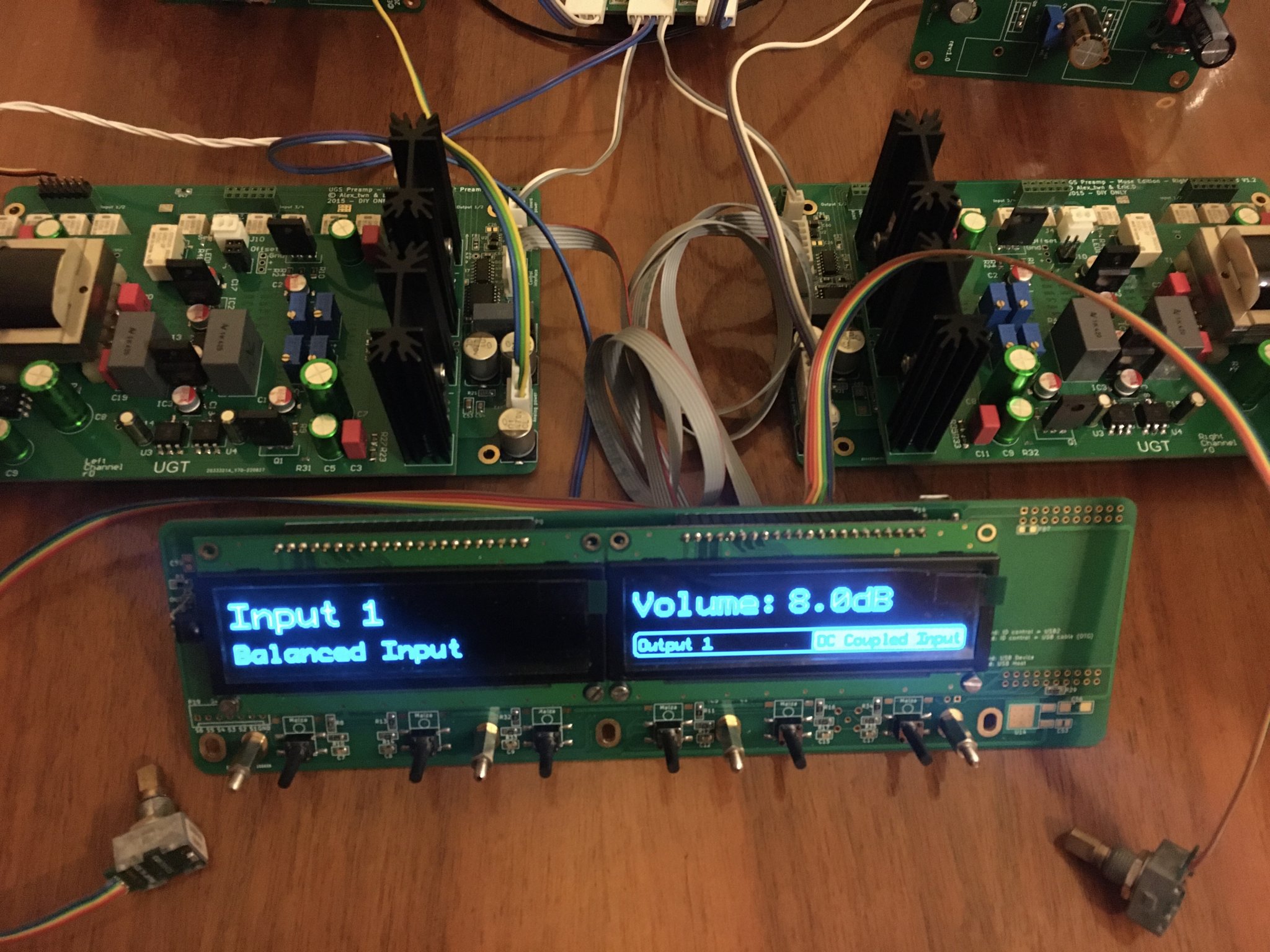

To drive them I have a ugs muse preamp that fits 2 different topologies of gain stages, one uses the Iron Pre(thanks again to @Zen Mod who helped me with tips to implement the transformers) with no global feedback, the other one uses fets to amplify the voltage and has global feedback.
With the Iron Pre I can get 5db of gain and with the other 10db.
For now I am using the amps with the active gain stage and the combo sounds nice. I still have to try it with the IP which I will do the next days.
In front of the preamp I have a rme dac that is able to put out close to 7vrms.
Forgot to mention but the amps work at 24v.
At this time what I can tell about the sound is that clearly has more bottom control than the aleph j on my 3.4ohm speakers.
