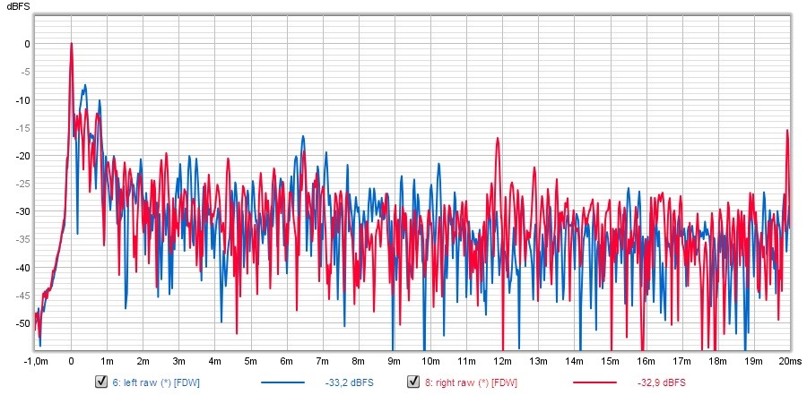

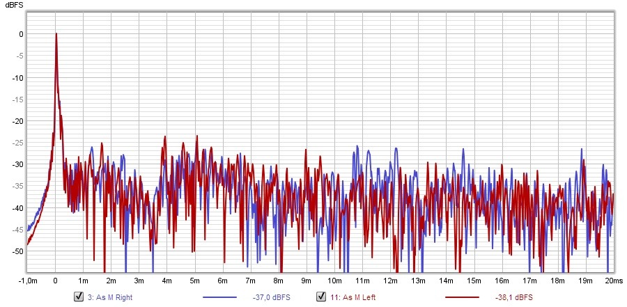

A quick comparison, not completely honest, due to my living room remodel, but interesting...
Raw measurement graphs, no DSP applied, I'll compare the ETC of the unshaded arrays with their frequency shaded counterpart:
The pure raw unshaded arrays as measured in June 2018:
And their pure raw frequency shaded counterparts, as measured in August this year:
While the reflection at 6.5 ms in the first graph could very well be a misplaced cushion between my poster and the couch, the most notable thing is the sudden drop after the peak of the frequency shaded arrays. The living room renovation helped, as I got rid of that awful metal ceiling we had before, plus I could center the damping panel/poster a bit more precise to go between both arrays (making it act similar left and right). Different drivers, different room characteristics and added filters, but it does seem to do something ;).
Just now looking at it I notice the switch in colors Left and Right, but heck, so much have changed, it isn't even a valid comparison anyway :D.
Reactions: 1 user

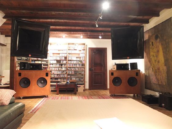

My wife didn't mind my phy open baffle.
It was 6' tall which made it seem not as room dominating as 39" tall x 24" wide double 15 cabinet, let alone the 2384 horn on top.
Center panel of the open baffle was 16" wide with piano hinges. Wings were angled 45 degrees back but 24" deep.
My jbls now are room friendly, at 14.5" wide and 28" tall.
