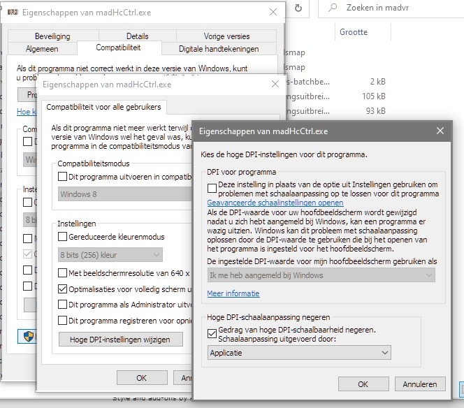

I've made the switch to Windows 10 (yeah I know, still one version behind) from Windows 7 and thoroughly regret the move. It doesn't hurt me on the audio side, but I have to find several cures on the movie side where, despite my use of a powerful enough RTX 3060 TI, I suddenly can't run 4K of MadVR madness anymore without weird hick-ups. It looks beautiful picture wise, but I get sudden dropped frames and strange render times etc. Never had that problem with Win 7 Pro.
Found the cure(s)... first step: disable all the extra stuff that Windows 10 does to video:
While I hate a Dutch OS, it's what I got when I bought this system. Anyway, the high dpi scaling override must be set to "Application" and Optimizations for full screen set to "off" for both MadVR's exe as well as Jriver's exe file. Next I disabled some gaming options within Windows for recording the screen and set Nvidia's VSync to "On" for both JRiver and MadVR. Now I can have my cake and eat it too! The quality of the rendered images by MadVR is awesome, I get to set the black and while limits to match the screen which makes the images "pop" and look real good. That's why I bought the Oled screen, deep blacks and good dynamic range...
If I ever go to Windows 11, this post will remind me what to look for 😀.
All is well again, almost... still need to re-install a boat load of apps that didn't make it trough the win7 -> Win10 upgrade. Like all my 3D design software etc.
Audio and Video is working again, so playtime can begin....
Now running on Win 10 (pretty current, while not quite current) and JRiver 64 bit with audio working as well as before. Well worth the troubles, the last big upgrade was years ago. Fabfilter does as good as the previous linear phase EQ and can set an even bigger number of tabs (good for low frequency resolution in higher sample rates) with the penalty of more delay. That isn't a problem though, as Audio/Video sync is done by JRiver.
Watched a couple of movies with the above tweaks in place... running on Win 10 and playing HT is now officially working.
Still have to reinstall a lot of apps, but music and Home Theater is working, just in time for the Holiday season.
