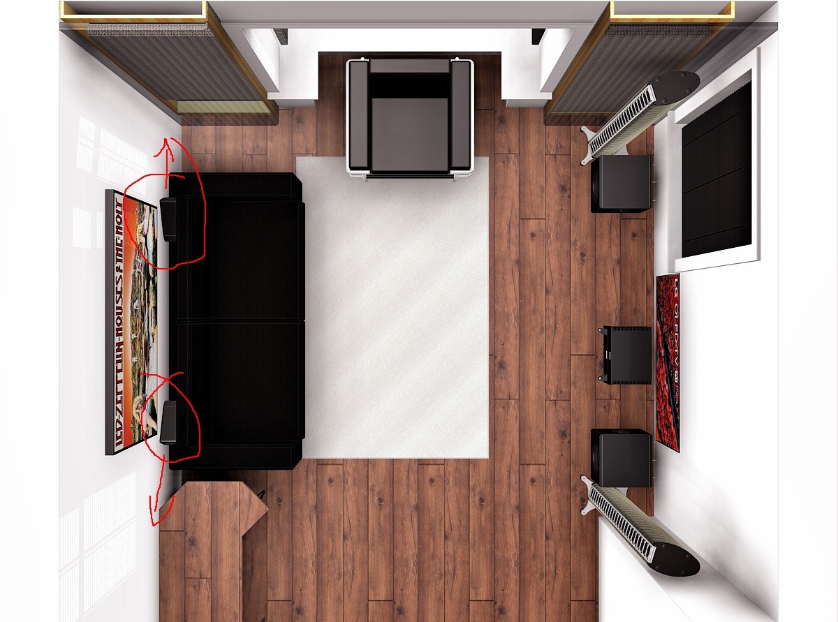

What came as a shock to me is the timing of that reflection in the "bad seat" and it's outcome. For our living room I'd hardly call it an early reflection, but it seems under different circumstances it is 🙂. It made me do a test where I changed the Haas kicker I have for the center part. Sure enough if I remove the Haas kicker (that was set at about 17 ms) and leave just a hint of reverb, perception changes. I can get the vocal parts on certain songs "to feel closer".
I added the hint of center to my ambience, which was consisting of band passed and delayed L-R and R-L before that, because I noticed a large difference in the "dry" center channel and the more "wet" side channels. I also believed it would help intelligibility. I had read that reflections can help with that, and with the cross talk already eating away it's tonal balance, I figured it needs more help. However, watching Griesinger made me rethink that part. Yes, I had read those notes before, but his story (and subsequent tests)was much more convincing. I'll try and test this on my son, won't tell him what to listen for and let him hear both. Probably will happen on Monday.
This line of thinking was also triggered by knowing how good intelligibility I get with phantom center in movies without a hint of center in the back channels. The slight reverb is to get the dry/wet feel in check. It just sounds better slightly wet, as I did rob a lot of reflections out of the room. No reverb like that on main channels, I'll have to make that clear.

The tweak I mentioned above was all I needed. I let my son listen and he was thrown off guard... he was smiling and looking around him and to me (I was standing in the doorway across the room) and back into the music. He immediately went to choose a couple of songs he knew would take advantage....
For your information, this was one of them:
All music is influenced by it. I realize now that I've been "off track" for quite a while. Even though the tweak is relatively small, it does have quite a bit of impact on perception. Like Mr. Griesinger put it: if you have the L-R and R-L envelopment working, the backdrop of the music, which we can't quite localize, becomes enveloping in nature. Hard to determine where it comes from, while the localization of the main features in the music become much more clear.
A long time ago I added a hint of stereo in my Haas kicker. Based upon the fact that it would happen in real life, as true reflections, and I was confident it would help with the crosstalk problem. I added it for another reason. I was enjoying my Haas Kicker 1.0, the one with band passed and delayed L-R and R-L. But I did notice the side channels sounding "wet" and the phantom center sounding "dry". So that needed some rectifying. What I didn't have back then was that hint of reverb tail.
Even though the change seems minimal, if you listen to the back-drop by itself, the change is rather big. So how does that work? Without any center part added, the back drop channels become 'out of phase' for the listener. 'Out of phase' means hard to place in perception. Just try it with your mains, connect one speaker out of phase. It's like listening to an undefined cloud of music. Its sort of surrounding you if the stereo triangle does it's job. Quite comparable to what happens here. Add just a whim of center to that back-drop mix and... boom... you created the start of Stereo, you now have a defined center in a slightly differing cloud of music, as it has become more focused. The reason for that is that the center mix or "mid" (from mid/side) information still contains both side channels in a positive polarity. Meaning it gets added to the L-R (and R-L) making the sum of those values more positive (less -R and -L influence). So now that I removed the phantom part from the Haas Kicker, the back drop is all fuzzy again. Adding a hint of reverb to that center, timed a little later (starting at about 25 ms total delay) still makes me perceive the center as "wet" or at least as "wet" as I'd like it to be. Less dry than in a room where all early reflections are removed/absorbed 😉. In line with the sides.
So now I do 'get' more of what Mr. Griesinger wanted to get across. A back drop, that feels enveloping while the main's focused sounds actually are more focused and attention grabbing. The back drop isn't as "2D" anymore, but seems to behave like a living entity. Varying in each song, never boring or the same sauce over everything. Some songs have strong effects, others are more gentle, but all are more "3D".
I didn't loose it all, but most visitors had never heard that full effect of the envelopment. Like I said, I added a whim of center, so there still was some level of L-R and R-L left for the effect to happen. Just not as "breathing" as it now is again. It still enhanced the frontal Stereo effect, but had less envelopment, it's what a room can do as the teachings of Toole has told us, but this way (as Griesinger tried to tell us) you can have your cake (great imaging) and eat it too (plus the envelopment).
I have been searching for it (that stronger version of envelopment) for quite a while as I had heard it at some point in my experiments. I have even had it more extreme, but every now and then, I would hear the back speakers draw attention to themselves. It's a delicate mix of levels to get the best out of it. But huge fun!
