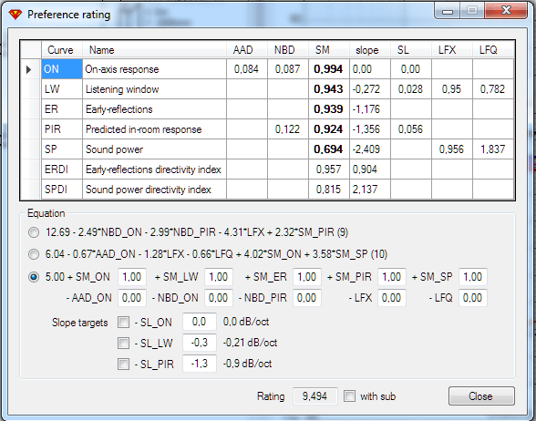

I never knew this, but Vituixcad has a build in preference score check. Never used or needed it but I noticed it's use in a post.
I haven't ever tried or used the optimizer, but I figured it might be cute to see the predicted preference score from the sim results I've shown of my array of 10F's and it's filters:
Hope I did this calculation right, it doesn't look like a bad score, does it? I do get that it doesn't say all that much by itself. Personally I think there's more use in all the work I did to adjust my room plus speakers as a combined result instead of looking blindly for or at a preference rating like this and expecting the world. I still believe that is the key to succes for us DIY builders. We can control the room + speakers by choice. A speaker company needs to hope for the best, once they designed it and sell the speaker to the public, they do not control it's end use in the homes of their fresh new owners (even though I'm sure they would like to).
It's the combination that counts. But it can't hurt that a speaker like this is scoring pretty good. 😀
It still is a compromise, like all speakers are. I'm just chasing after the best results despite the compromise I've made.
