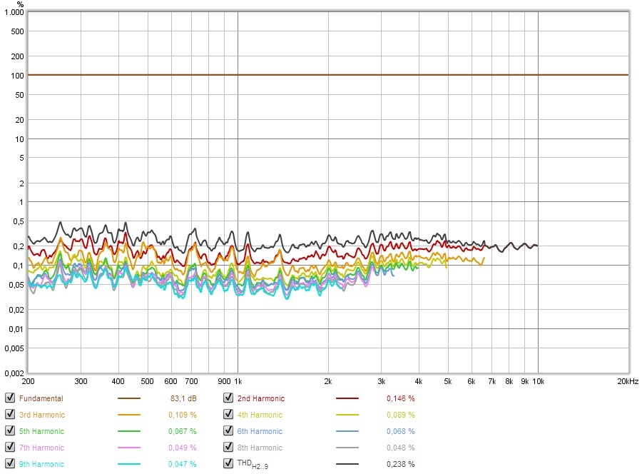

That's a nice result! Do you have a comparable measurement with the TC9's ?
TC9 in Stereo, about a year ago, about the same SPL level except at the top end (which was lower in this measurement).
Clearly these drivers are related
Can you also sweep from 20Hz?
I do sweep from 10 to 20000, but I won't show them just yet. Still need to clear up some room issues to give the 10F the same circumstances
as the TC9's. I don't want to give the wrong impression and I just need more time and clean sweeps without traffic. All in all it is comparable to what the TC9's showed, which isn't surprising. The 10F needs less bost down low, and is cleaner in frequency output before EQ. Also no surprise.
In time I'll show the results. But I need them to be clean and representative.

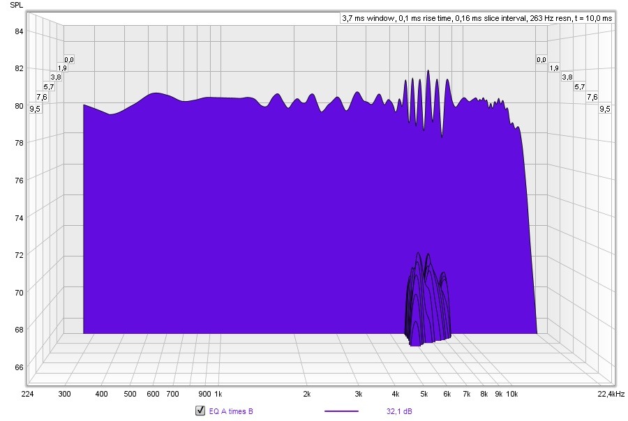

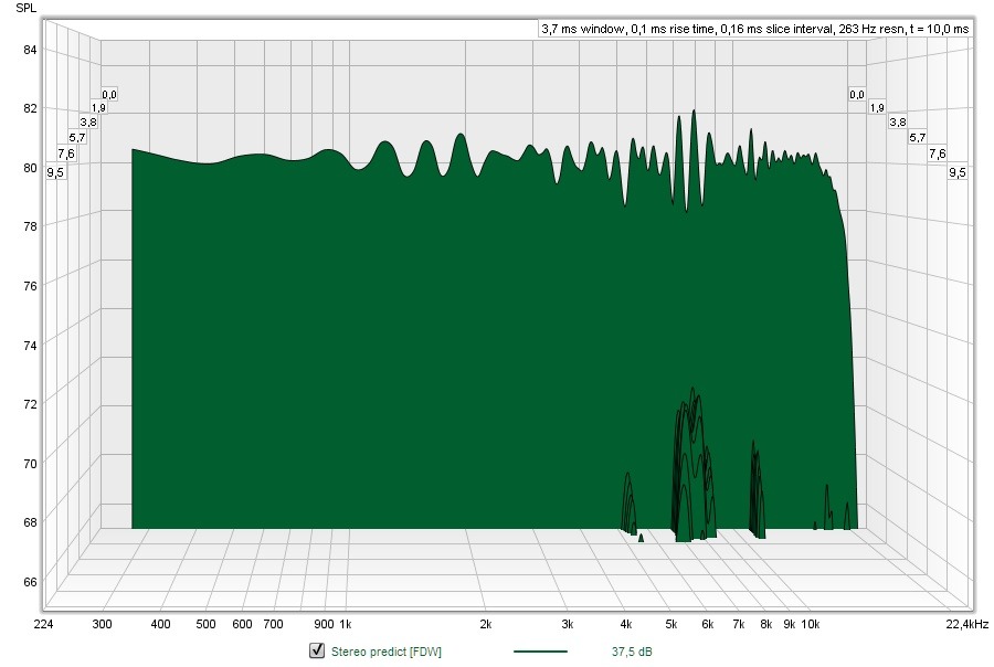

An example of why I came to trust the Vituix predictions,
When modeling the array with floor and ceiling mirrors (using actual modeled drivers) I get to save an IR that might resemble what I measure
in my room. As it would include those room effects. First time we did that on the thread of @nc535 it made me sit up straight and take notice!
So here's an early waterfall result of an IR like that from Vituixcad:
Don't mind the flatness of the curve, just look for general trends, I EQ-ed this quickly with a 6 cycle FWD at ~80 dB....
If I look at my measured results, and EQ it similarly, I get this in reality (it's a Stereo sum, set at 80 dB and EQ-ed):
Not bad eh? Yes, there are some differences, but based on what I saw at the time, I could make the decision to trust the predictions
of Vituix, and rely on it to be close to reality, so if I could book improved results with filter tweaks, it would translate to my real in-room results.
That's what I meant a while ago when I said, if you want to know what it does in the room, with regards to floor and ceiling reflections,
model the speaker mirrors of the floor and ceiling reflections. That way you get to save the IR and compare it too real in-room results.
I found it useful, because with these arrays, this type of in-room measurements is all I'm gonna get. I can't measure at close range as to
not include the room as much, so I can only rely on what I get at the listening spot. Knowing what part is caused by what effect just became
a lot easier with a tool like Vituixcad on hand. I bet it would help with other type of speakers too, if you'd want to know
(notice the high frequency extension actually being higher up in real life, -3 dB at 19.5 KHz)
