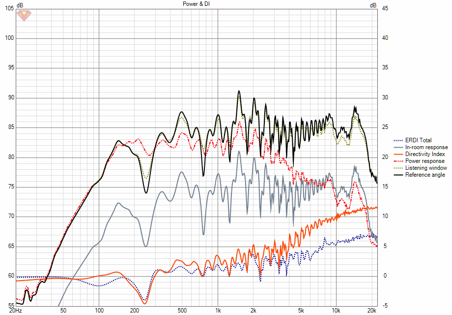

After the simple but effective correction that TNT suggested, I do think it was worth it to create this Deluxe series ©Vandermill 2022.
They do seem to tell a compelling story that would otherwise take a lot of words to express. So I figured: what the heck,
I'll take the time and create these, I can upload them to my website to try and create a better understanding of these arrays.
I think these three graphs do tell a convincing story of what an array like this is all about. The headroom for EQ, the way it interacts
with the room... it's all there... these texts sure make it easier to understand, good call @TNT!

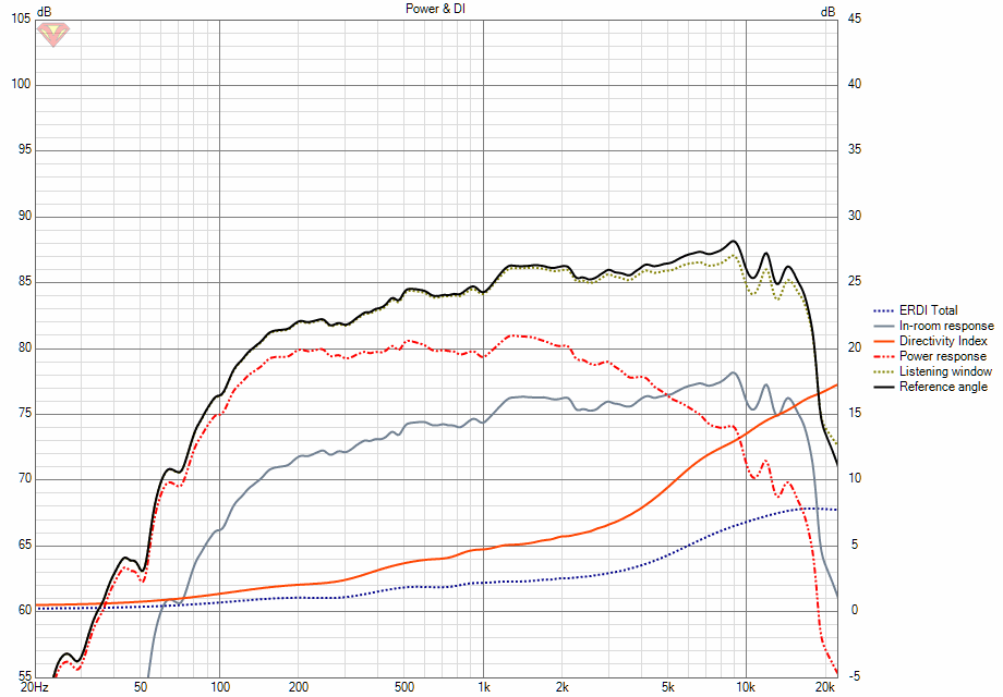

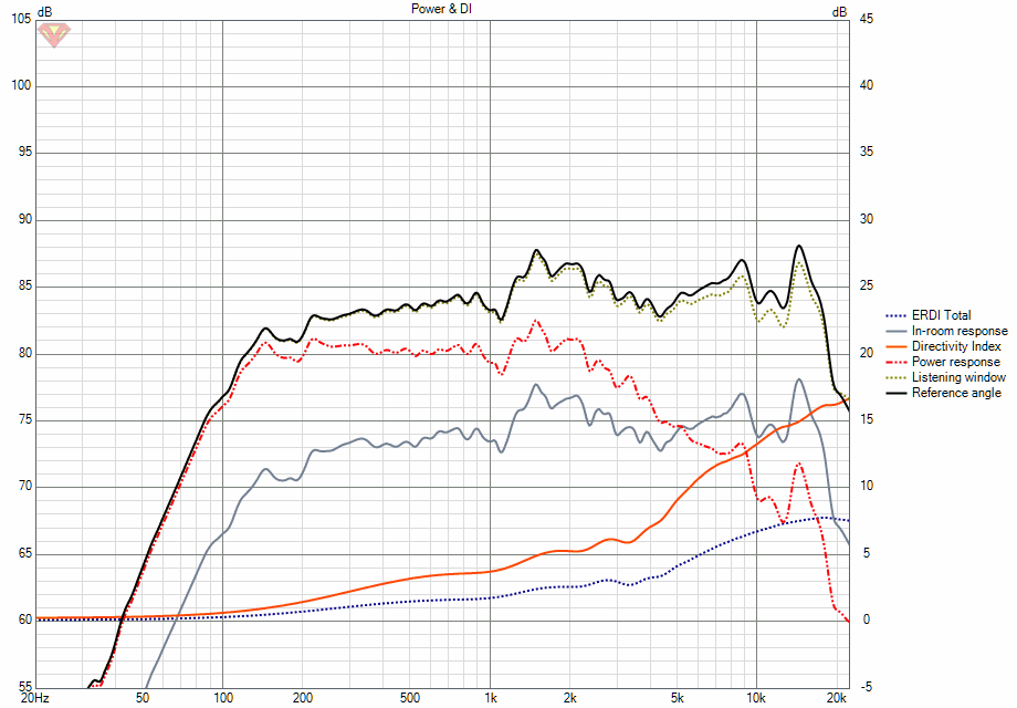

So, after all these new graphs, I just might have to introduce yet another exclusive series. First installment:
I think it's pretty self explanatory, don't you? I've created a set of 360 degree measurements for the Scan Speak 10F 8414G10 driver.
It has a few small differences, like the impedance curve, so it's going to react a bit different too. I made this one in the diffraction tool
of Vituixcad, just because I had not done that before. I've used driver properties that nc535 made and ABEC simulations from fluid.
I figured it was time to learn how to trace an SPL graph and make a set on my own. I did use my baffle dimensions with round-overs
so it's bound to be a bit different from the TC9 model. It's close but not quite the same as the ABEC model. Close enough for this.
It's clear that this driver does look quite a bit different in Frequency response. Maybe I should compare the TC9 and 10F graphs as well 😀.

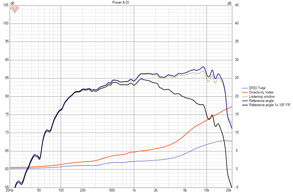

I hope so. For me, it was an exercise if I could make the diffraction model within Vituixcad. I had not done that before, using a factory provided
SPL sheet.
So I traced the SPL graph in Vituixcad and used the diffraction tool to get a set of 360 degree measurements. Pure curiosity to find out what it takes.
I don't need these, but it was fun to be able to walk trough the entire proces like this. I must say, Vituixcad is very versatile and complete.
I'm glad we have these generous people like Kimmo providing us with tools like this. It's awesome, really.

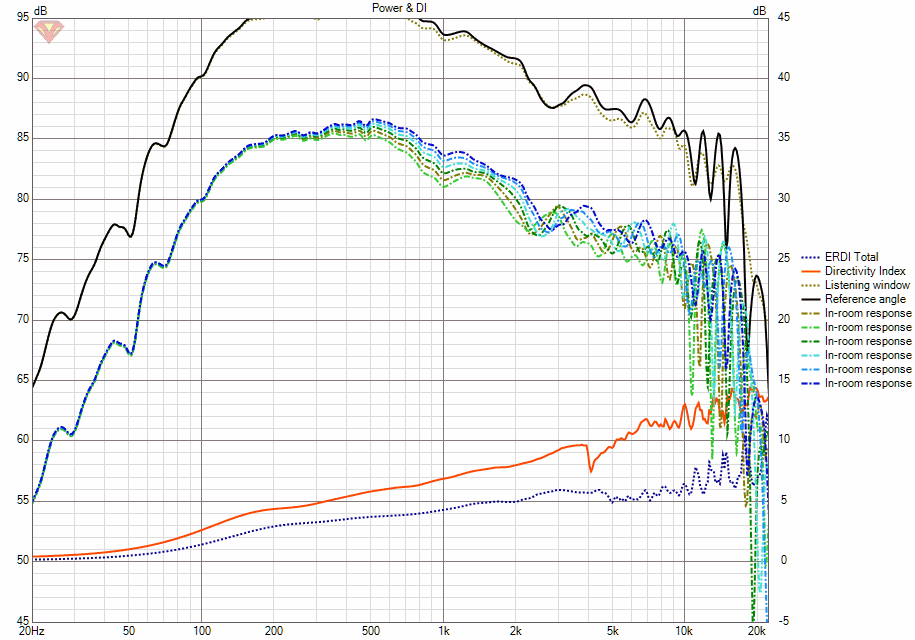

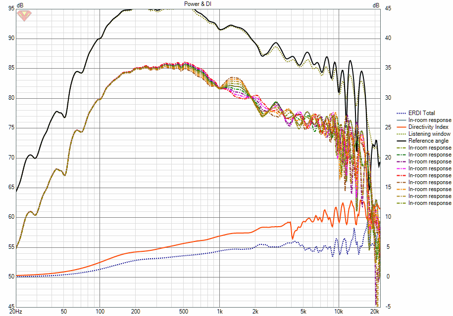

Some more simulations, basically to show why I moved forward by adding the filters to the straight array.
First up, vertical movement at listening distance:
Vertical set of predicted in-room curves spanning from -100 mm up to + 100 mm around the sweetspot. No EQ applied.
After creating filters that had the most even vertical response I was happy to see that the predicted improvement went
all the way down to 200 Hz. The frequency variation is notably improved due to the more bundled vertical output of the
array. The combing is highly reduced, almost eliminated completely. The variation left even on the top end is no more
than plus/minus 2 dB. Below 5K it is reduced to plus/minus 1 dB.
Results when moving closer or further away:
A set of in-room predictions spanning a distance of 2.5 to 3.5 m from the array. No EQ. What can be seen here that moving closer
or further from the array has less variation for the shaded array. When I saw this result (after trying countless versions 😀) I figured
I had nothing to loose by going forward with these plans to add the filters. The filtered array was acting more well behaved under all
use-cases. The cost of it all is about 2 dB less sensitivity that gets burned off in the filters itself.

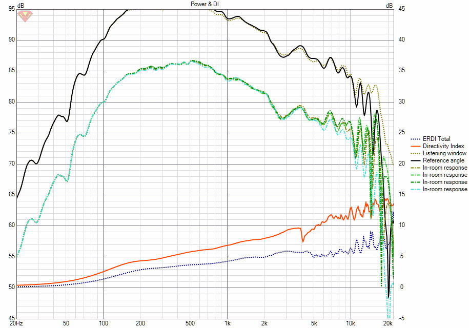

Under angle:
In-room prediction of the angles 0 to 15 degree at a listening distance of 2.7 m. No EQ applied.
Here we see similar behavior between both arrays. As there's no vertical change and the horizontal span is all
that has changed. The filtered array still shows a benefit of a more linear drop/octave with less swings.
I hope that illustrates the differences in behavior that can be seen between a filtered and unfiltered straight array of 25 drivers.

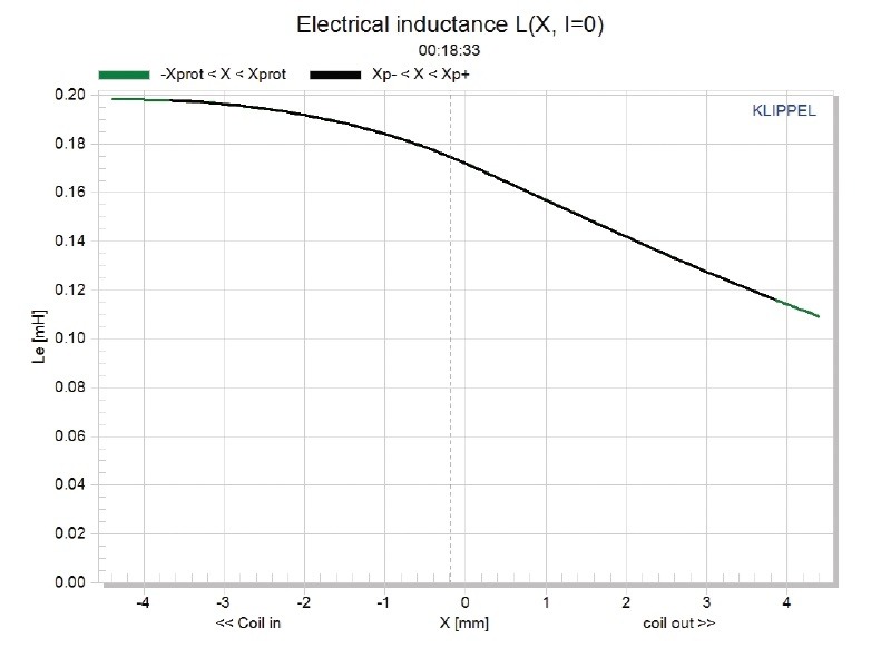

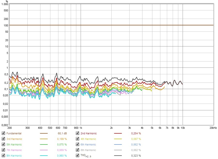

I've been on a quest to find out if adding the coils to the arrays had a pleasant by-product. For a long time I had been
following Joe Rasmussen's Elsinore thread, and his vision on lowering what he called current distortion. The theory is
understandable enough, if you look at a few of his posts. The distortion originates from the fact that drivers vary in
impedance with the movement of the cone. For instance, here's the impedance change per cone position for the Scan
Speak 10F 8414G10:
Joe's suggestion is adding an inductor in series with the "woofer" as this makes the swing in impedance seem smaller
as seen by the amplifier. When playing two notes, one lower note that makes the cone swing and the one higher up
will be modulated by the reaction from the amp, as the inductance will vary due to playing that lower note. Much
saver to just read what Joe says here...
I've added a lot of coils to my series/parallel schematics, so I figured to check if it would lower my current distortion as
a pleasant by-product. If I read the above graph, and use the 2.3 mm x-max of this driver, the swing or variation of
the impedance in my array (will be similar to that of a single driver) is just over 30%.
As the added inductance is in the parallel legs of my circuitry, I had to figure out how that changes the numbers. If I
did it right, there will be about a 7% improvement in the induction swing. Not spectacular, but an improvement non the
less. Should I add a single 0.5 mH coil with the (total) array, that improvement would grow to 20+%, but it would shave

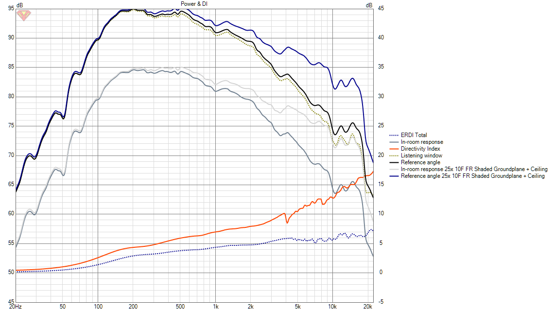

off 7 to 8 dB on the top end SPL (gradually). See:
Dark blue and light gray are without 0.5 mH inductor, black and gray are with the series inductor.
I do doubt if dropping the top end by another 8 dB and making up for that with EQ would be a way forward to
lower total IMD distortion. Limiting the cone movement needed on the bottom end would be a quicker way to
do that. But doing that introduces yet another compromise, one that got me in an argument a few times. Not
going there again. I already lowered the low end movement with the introduction of the subs. Once I find the
time to dial in everything once more, I'll try and maximize what's possible without creating new compromises.
Anyway, I did get my answer to this question: yes, the induction of the coils does bring an ever so slight
advantage. An IMD test could tell us, but I did not run any prior test to compare with... Anyone with an array,(*)
try adding a series inductor, value of about 0.5 uH and enough wire thickness, and run an IMD test to find out!
Run it with and without the inductor in series, EQ it back into shape. One should see up to 20+% reduction of
distortion if the added EQ doesn't steal most of it away again. I don't have spare coils and not about to get
them for this test just yet. Maybe some day I'll be curious enough.

(*) sadly, I've never seen an 'Le' graph of a TC9. The graph for the Scan Speak 10F comes from audioXpress.

I do, I only order the stuff I need. This graph shows the 10F is a likely candidate for a test like this, as it has a nice and low
Le. So even a relatively small coil in series will have an impact and change the balance as seen by the amplifier.
Obviously, the effect of that same coil on a single driver is going to be a bit different:

Don't get your hopes up too quick, but a first brief measurement session took place. Just trying to get a feel for all of the changes.
The last EQ I did for the 10F's was a quick job, I don't want to do that with these drivers. I made a couple of changes to the pré-EQ to shape it for these new drivers. They produce more bass than the TC9's for the same output of the amp. I still need to tweak the results below 200Hz, as I did for the TC9's, but here's a distortion graph for the 10F array above 200 Hz, taken at listening position (2.7 meter) and at 80 dB:
Pretty sure it will get a bit better, I usually suffer from traffic messing with the results. I've run the first DRC corrections after which I need

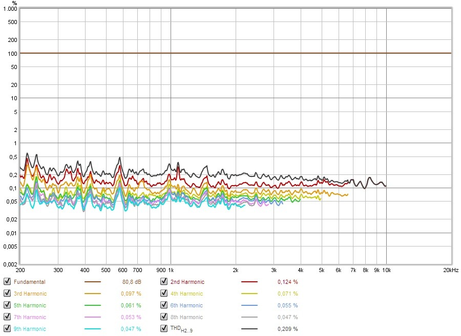

to do some manual tweaks. Here's a Stereo result showing lower distortion at 82 Hz:
Nothing to be ashamed about, good to go I'd say. I have limited the SPL levels as not to include various household items into the graphs. 😀
It it's a level of 82 dB at 2.7 meter (I reduce the level for Stereo measurements as to not upset any room accessories). I moved some to the
back of the room but I can hear them sing along at times.
The room has changed after our living room renovation, no doubt. So a few new challenges to make it all work as before. Hope I get the time
to do it, I'm actually exited about it. I like that H2 is above H3 over the entire midrange.

That's a nice result! Do you have a comparable measurement with the TC9's ?Don't get your hopes up too quick, but a first brief measurement session took place. Just trying to get a feel for all of the changes.

Can you also sweep from 20Hz?
