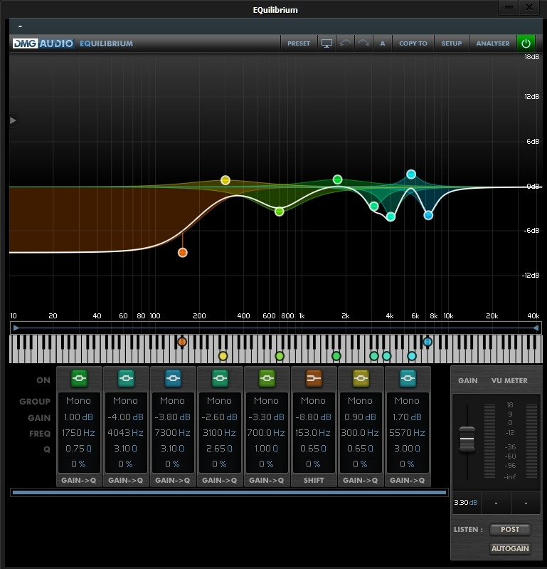

Never tried that one. I got Equilibrium up and running and it functions perfect in Linear Phase (using FIR) using a 32768 impulse length.
If I set it one step up to 65536 it seems JRiver runs out of space somehow as some plugins just stop working/responding. Never experienced that before. I do use a lot of Equalizer instances within Metaplugin. I never expected to run out of space as it had never been an issue before (and I've done plenty of crazy things). I don't need that kind of length though, at least not here.
Anyway, Equilibrium actually seems a bit much/overkill for what I need, even though it really does perform excellent. I prefer its GUI to Fabfilter. However, I don't really need a smooth GUI, just a well functioning LP EQ. I like the clarity Equilibrium offers to what it is using internally, FIR filters of a defined length, you get to set it's windowing etc. while Fabfilter only provides buzz words like: high, Very high etc.
I've searched quickly and ran into: https://www.meldaproduction.com/MAutoEqualizer, it seems that's one of the few EQ's I could find that features Linear Phase bidirectional processing (not FIR), just like my previous EQ did. I might try that in demo. It's quite affordable, but I think I'd need this one (10 band) as opposed to the cheaper and simpler MAutoDynamicEq that features the same techniques but has 7 bands. Currently one of my tweaks uses 8 bands, go figure 😀.
GUI of Equilibrium, simple, clear and a choice of text + graph.
So all in all I really really like Equilibrium, but it might be overkill for what I need. The control you have over quality is awesome though.
Listening to it it did nothing wrong. Very transparant. I'd almost say it is cleaner/more clear than what I had before. But that may be the psychological effect of liking it this much. 🤣 Anyway,28 27 days more to decide.
