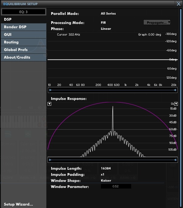

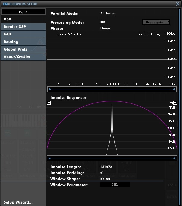

Equilibrium shows it like this,
8K tab count (impulse file length 16K)
And 65K tab count, (impulse file length 131K)
This does make me think again about pré-ringing and it's audibility. I didn't realize even the length of the IR for FIR filters was a factor in this.
Not that I need to worry with a 65K tab count in my own processing. So besides windowing, even the tab count could influence things like transient perception. Further depending on the steepness of the filters used of course. But I've never seen it pictured like this before.
For processing in my current chain I use 16K tab count (32K file length) within Equilibrium and the above pictured setting for the Kaiser window.
It's the current sweet spot between sweet sound and responsiveness of the JRiver system with 8 instances of Equilibrium running in total.
4 in Linear phase FIR, 2 in Analog FIR and 2 in Digital + Compensation and Phase. That keeps everything responsive, the higher the setting the less responsive it feels. Home Theatre is currently running one step lower in FIR file length. Next up I need to test it long run.

So what do you think about those graphs as presented by Equilibrium based on FIR file length.
If I compare an impulse created with 32K FIR length and one created with 16K FIR length (as saved to disk) within REW and in Filtered IR view I see no difference whatsoever. I took one of the nastiest EQ signals I had for that comparison. I'll try it again tonight with a bigger difference, but I won't hold my breath.

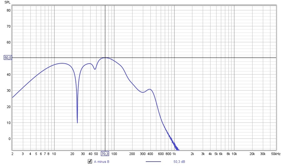

While there were minute differences to be seen between the files, an 8K and a 32K filter are exactly the same upon first gaze. The difference (in this case) was the reverb, which is different for every time an IR flows trough it. If I subtract the files with reverb, part of the reverb turns up as a difference signal.
If I leave the reverb off and subtract the 8K file from it's 32K counter part I get a difference file that is 57.8 dB lower in level at it's highest point (70 Hz). That could be audible.
Level of both the files that were subtracted from each other was 108.1 dB at 70 Hz.
All visual graphs seem the same though, so it's going to be hard to tell. So use what seems appropriate and "sounds good to you".

Have you ever taken a look at at what frequencies the ringing occurs?The audible differences with Equilibrium made me think about the tab count and shape of the IR.
These are just visuals from within Equilibrium, based upon the specific EQ settings. There's nothing in it from a measurement or something like that.
So anyone could see how Equilibrium shows these, based on their own EQ settings. The EQ determines the ringing pictured.
But to answer the question: I did not look at the frequency the ringing applies to. As it would still be convolved together with my true sound stream. And that's the combination I get to hear.
Looking at the EQ data alone with a Dirac pulse running trough it while using different setting within Equilibrium shows no differences in REW. So there's nothing from my loudspeaker or even any other audio part in that chain, just a Dirac pulse and Equilibrium (linear phase) EQ.
Dirac pulse in -> JRiver -> Equilibrium -> output write to disk.
I merely showed the DSP windows from within Equilibrium, those show a level difference of ringing due to changing filter length, something I don't see when two different filter lengths are recorded to disk and shown by REW.

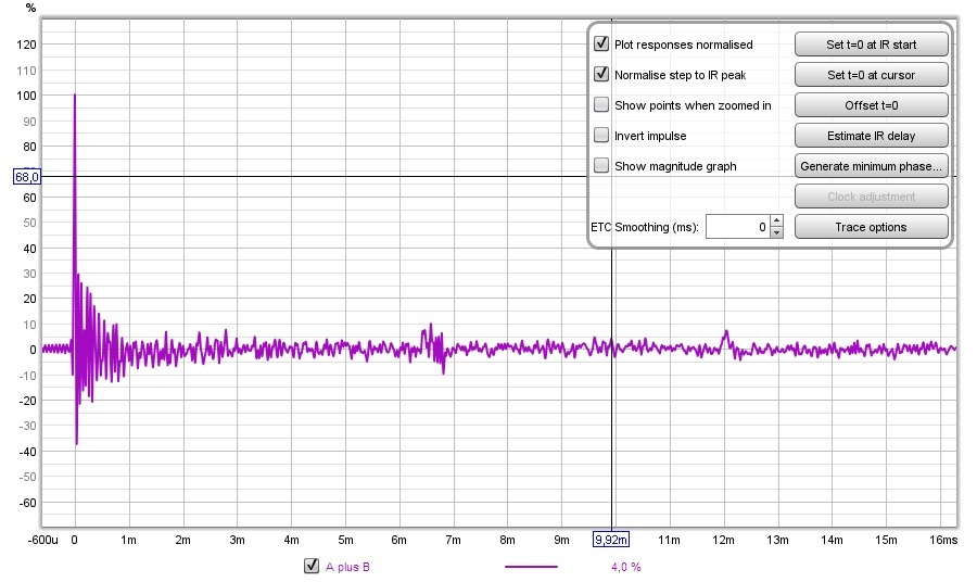

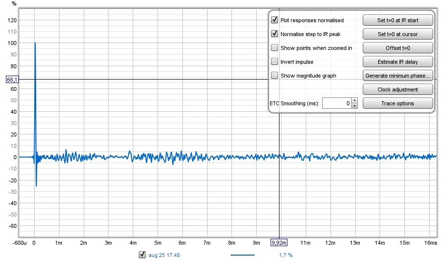

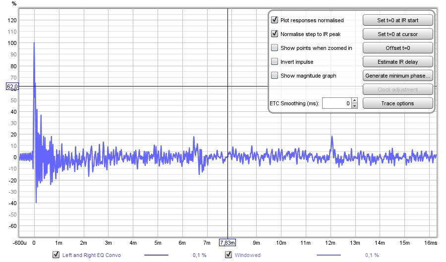

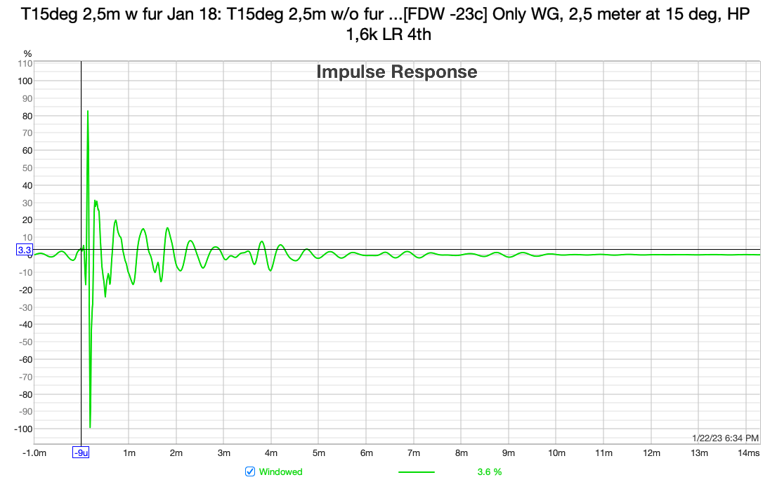

As measured in Januari 2015 (notes say FIR correction was applied):
If you look closely, you'll see the Stereo measurements shows a double peak at the start, so, worst example.
If I sum the Left and Right speaker from that same session, I get this:
Much better! Which is what I had in Januari 2015. Rough around the edges, no damping panels yet.
So what changed in all these years? I'd say incremental improvements on just about any part of it I could think of.
It made the summed IR look like this (actual measurement at the same spot as the above):
That's progress. A strong reduction in room influence at the listening spot. Measurable and visible this way.
A true measured result of the Stereo pair FIR corrected.
So that's what I got by sticking to one single type of speaker and try to optimize it's use. One more note: these are measured at listening distance, not up close at 1m or less! That makes quite a difference, most measured results we see are not at the listening spot, these are.
