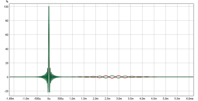

Not having the time or conditions inside for measurements, I decided to take a preview on my next experiment. A while ago I mentioned using fake floor reflections to fill the ~1.8 KHz cross-talk dips.
Easy enough to test by convolving the FIR filter with a signal including that reflection. I tested it on phantom sounds only as well as on mid and side channels.
First thing to notice: it does something, clear intelligible voices. Imaging becomes a bit weird though. more center panned sounds seem to cluster. Meaning the bass drum or bass guitar seems to be locked to the same place as the singer's voice. Very open sound for the rest of the surroundings, but not really that focused. Big open space but harder to pin point origins.
(center) Voices sound wonderful though, making me wonder if this is a good HT alternative. That's where it could shine, having that dedicated center.
I will no doubt revisit this test, once everything has been properly dialed in.

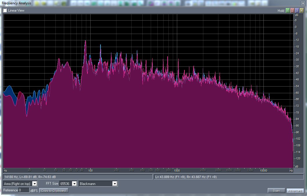

P.S. Here's the analysis of that Graveyard song:
It kind of 'lives' in the mid-range 😉.

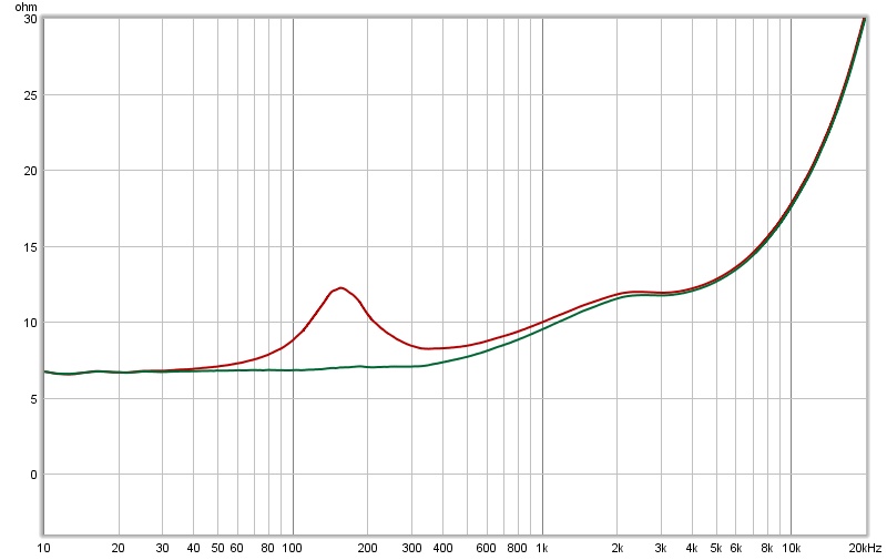

I didn't quite go far enough. I checked the braided leads to the connector tabs, cut the surround and spider to see the coil. Nothing wrong there. I guess I should have removed the dust cap to see the connection between braided leads and voice coil.
Doesn't look like an easy task to be honest, not like the drivers in the thread I linked to.
I just posted in that SS driver repair thread. I believe this issue is due to the newer batch of drivers being made with a new lead free solder formulation. Its not nearly as forgiving as the good old 60/40 stuff.
Also, I believe this driver uses copper clad alu VC windings, which is prone to issues with soldering. Thats why most of the pro audio drivers with this sort of VC wire are diffusion welded to handle the extra mechanical and thermal stress. The TC9 and TD9 drivers are cheaper drivers and made to a budget (in China) and a certain failure rate is expected. Ive learned an important lesson over the years, which is to always buy extra drivers in case of failure and for tolerance matching purposes.
