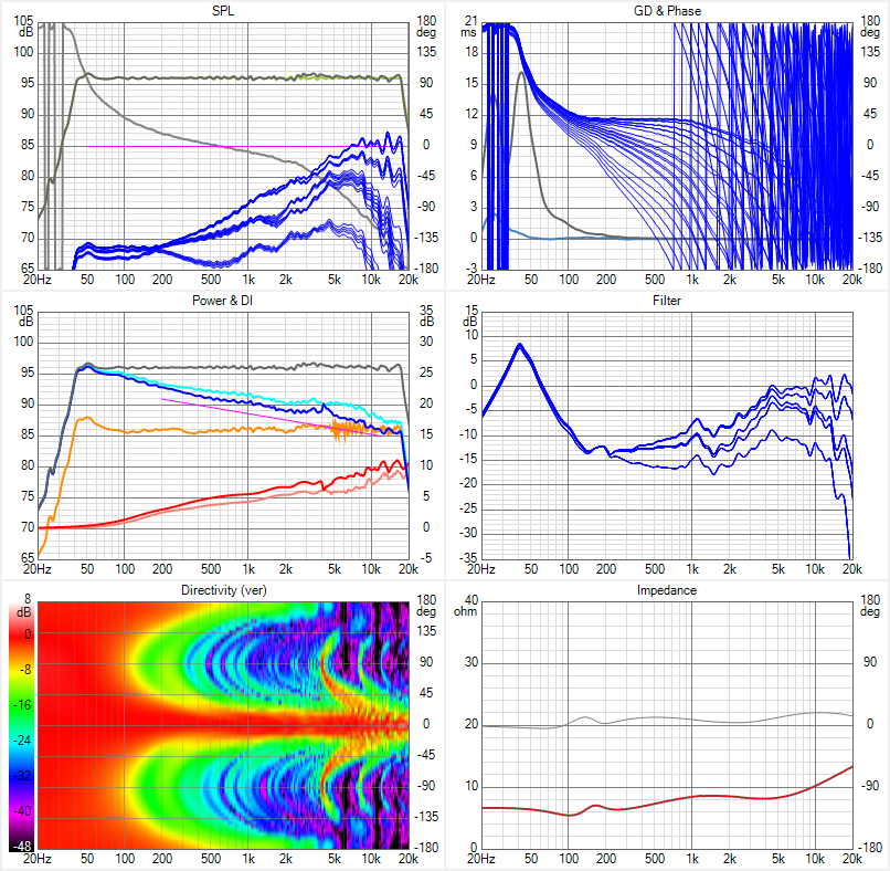

Did you catch the Vituix sims?

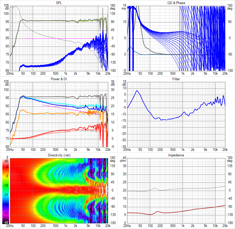

The Unflitered array (as I had been running for 5 years)
Then a lot of time and energy went into Vituix sims to improve those results (mostly due to nc535's insatiable, almost never ending research into all kinds of speaker concepts one could possibly think off )
Which led to this picture:

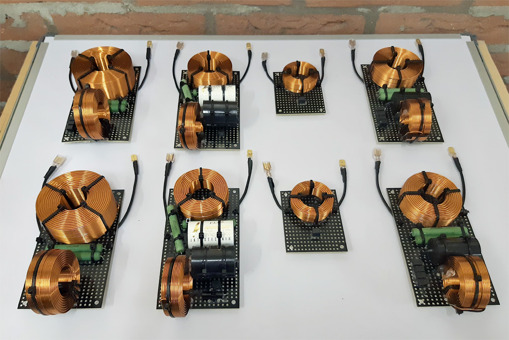

Well, that simming and the planned living room renovation last year led to me, actually dragging the arrays to the garage and having me include a bunch of passive filters:
(Picture above is not including a few passive notches, introduced later)

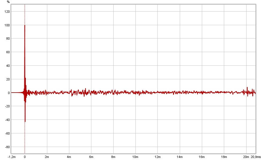

This is the impulse of my corrected left channel, as I measured it yesterday:
The left channel had caused me some grief, as a few drivers (3) broke and I had to repair it. Due to my health situation, this took way longer than expected.
Sadly, the new clean measurements of the left array showed me the right array is still in need of some service too, despite measuring a good impedance after bringing it back into the living room. It looks like I'll have to redo that one too.
