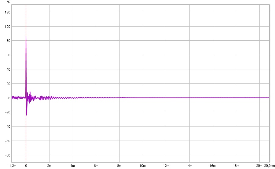

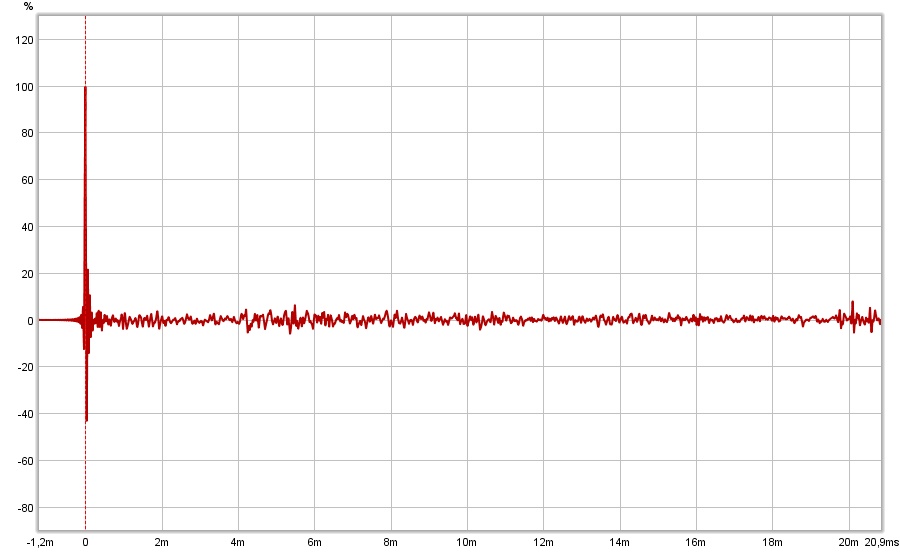

This is the impulse of my corrected left channel, as I measured it yesterday:

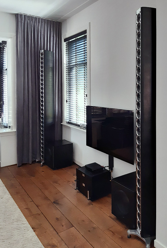

The left channel had caused me some grief, as a few drivers (3) broke and I had to repair it. Due to my health situation, this took way longer than expected.
Sadly, the new clean measurements of the left array showed me the right array is still in need of some service too, despite measuring a good impedance after bringing it back into the living room. It looks like I'll have to redo that one too.
perfection!

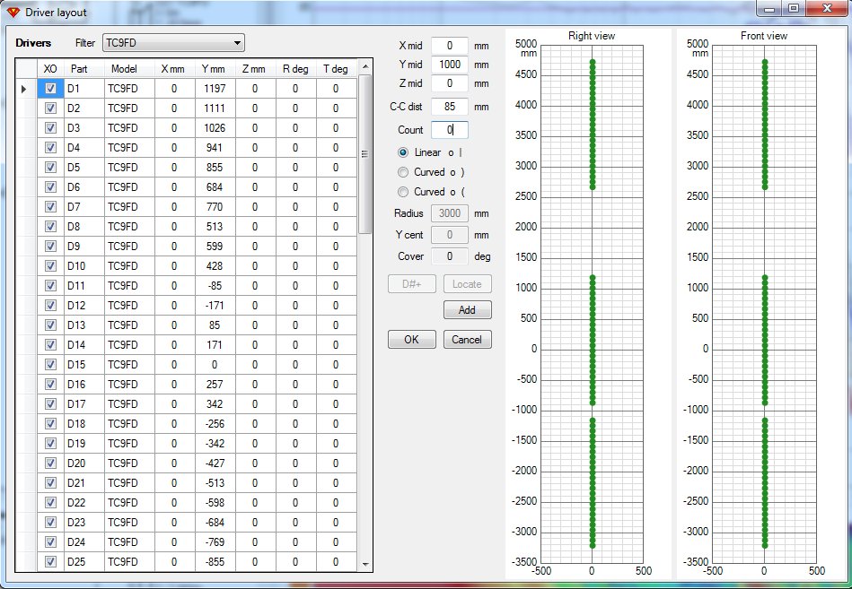

And very close to the predictions/sims! (floor/ceiling reflection is about -6 dB)
Predictions with a real array as floor and ceiling mirror can simulate the IR.
attachment.php
(thanks to nc535 for nagging Kimmo about the necessary tweaks to VituixCAD to be able to do this)
While it's useful for arrays, modeling it like this would give insight for other type of loudspeakers too.

If you mean the little peaks, no, that has to be from something else in the room. The floor/ceiling reflections cause a small ripple over a wider area. That's the beauty of having such a sim, you can learn a bit more of what's causing what.
The left has never been this clean, meaning my updated damping panel and the new curtains do their job!

For that I can show the sim with a higher reflection rate:
attachment.php
If you compare that to the measured/corrected IR, you'll see the resemblance in shape of the output after the peak:
974295d1628860129-towers-25-driver-range-line-array-left-convolution-jpg
The floor/ceiling pretty much is a train of (quite) small disruptions. Not a single or double peak like most other reflections often seen within measurements.

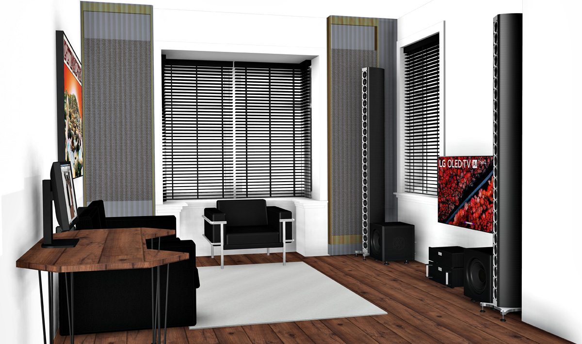

I expect the new curtains to do better than the old ones. One of the reasons to go with that material, without upsetting my other half 😉.
(I was in charge to find and order the curtains, but we both had to like the look)
The damping/absorbing panel is the old one, just repackaged in left over curtain material.
I didn't take a picture of the panel itself (looks like a big grey patch) but you can see the size of it here:
attachment.php
(click on picture to see it undistorted)
attachment.php

attachment.php

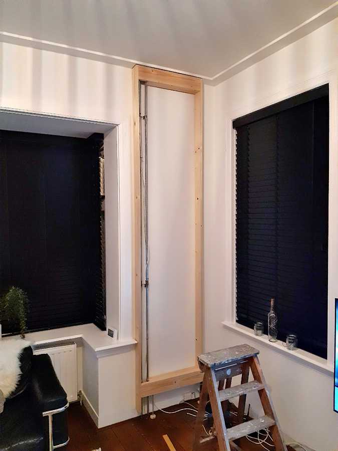

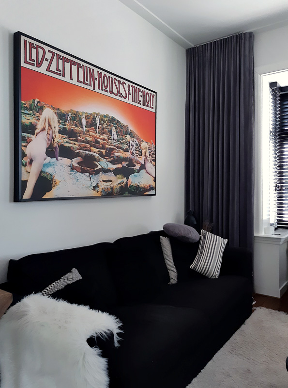

Might as well show a picture of the other side too. The space between couch and damping poster is filled with pillows during listening or measurement sessions.
Another curtain, another panel on the side wall (see 3D impression). This time around I made sure the damping panel was placed in the middle between both arrays.
(used to be ~5 to 10 cm off) The couch is in the middle too, I had to modify my desk to make that possible. I figured as long as we are remodeling I want to
make sure I get the maximum audible return 😀.
Next time the weather improves I got to take a new picture using the wide-angle lens. Need to clean up my desk first 😉.
