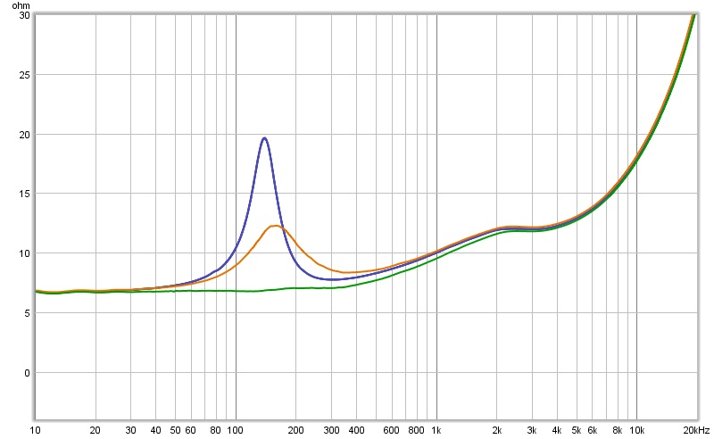

Had my last procedure early morning last Tuesday and I am recovering well. So well, actually that I decided to mount some drivers on the baffle. I got them all hooked up and what do you know....
Again the impedance showed a one group failure. The average low impedance hoovered around 8 ohm instead of 6.something... I figured I must have messed up wiring them all up again, nope... quick group tests showed yet another driver failure in a previously untouched (and fully functional) group.
Decided to call it a day and pick it up where I left off the next day. So today I replaced the faulty driver and ran 33 impedance tests 😛.
One single run and 2x 8 sweep runs, just to be sure.
attachment.php
Here it is, compared to the closed up right impedance. So that's 3 different tests (with 33 sweeps in total) compared to the closed right and closed right with compensation network.
Enough for this day, I'll call it a bingo and will try not to worry or guess why I lost another driver yesterday 😕. (that's 3 in total)
attachment.php
