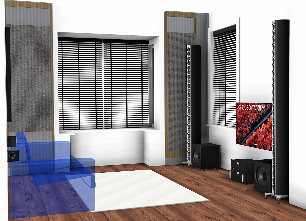

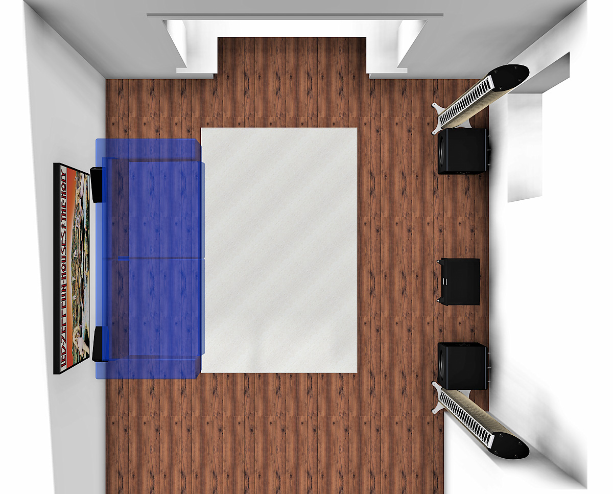

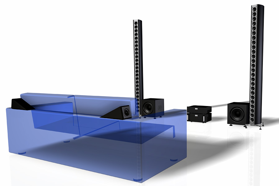

I've always had the models, but never used them all together...
attachment.php
Who knows, I may add my room as well. I've always said I would some day 🙂.
Anyway, here are all audio components as they are setup in the room.
attachment.php

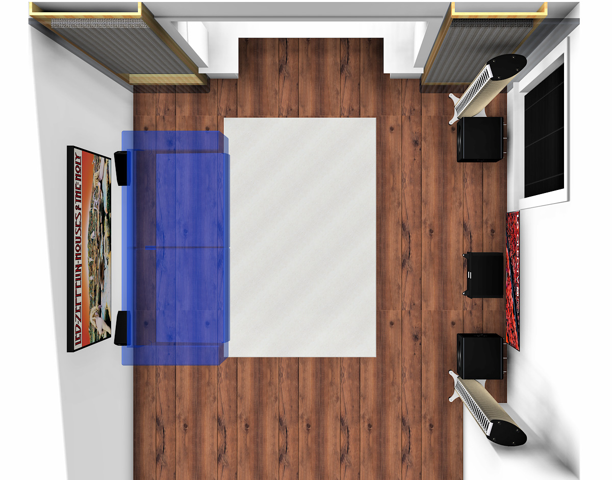

I've always wanted to draw it up, but never really found the time. As the weather still isn't there to go into the garage I figured to finally draw it all up. It serves as a nice way to figure out the seating distances too.
I've had a lot of questions about the absorbent panels (position/size) and these pictures should make it more clear to get an idea about sizes etc.
I'll change the picture on the TV in due time 🙂. It was the first one I found to be able to quickly add it. But posted like this it kinda looks like I'm bragging about it 😀.
That's not intended. No need to advertise, LG isn't paying me 😉.
As I find it fun to do (for now), I keep upgrading the model with small tweaks. I mainly use it as down time while I wait for the weather to turn and it gives me time to think about my next move. I won't insert the pictures (way to big) but just upload them for the curious ones. Easier to skip. 😀
As strange as it may sound, it is helping me to think, while just modeling the furniture etc. The model itself turned out useful enough to me. Still need to check a few measurements, but it will help me position some key elements to fit my needs.

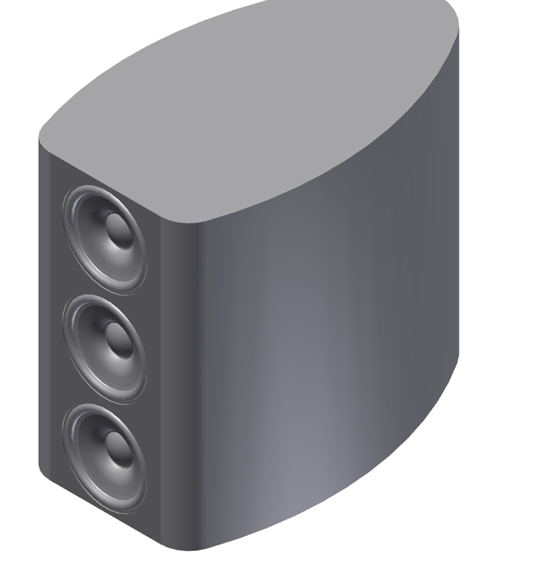

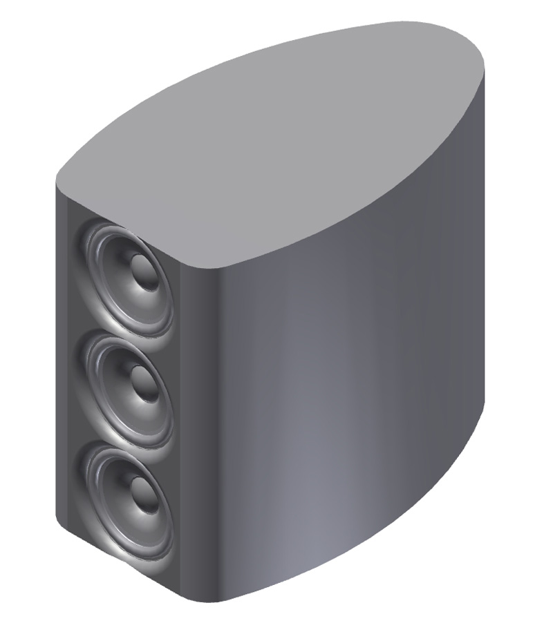

@fluid, do we need something like this?
Flush mounted:
attachment.php
attachment.php
With my backmounting/roundover:
attachment.php
Still need to add a top/bottom to the first one for it to represent my test cabinet.
I can send it to you trough mail, and can easily adjust it to represent your lines as well.
