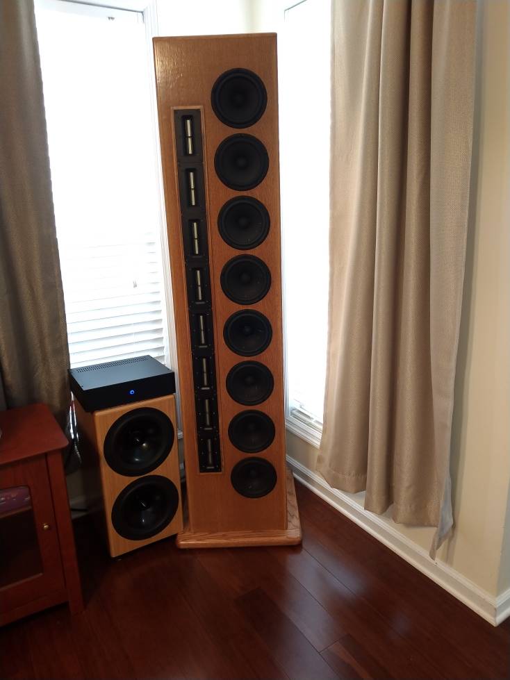

The making of: The Two Towers (a 25 driver Full Range line array)

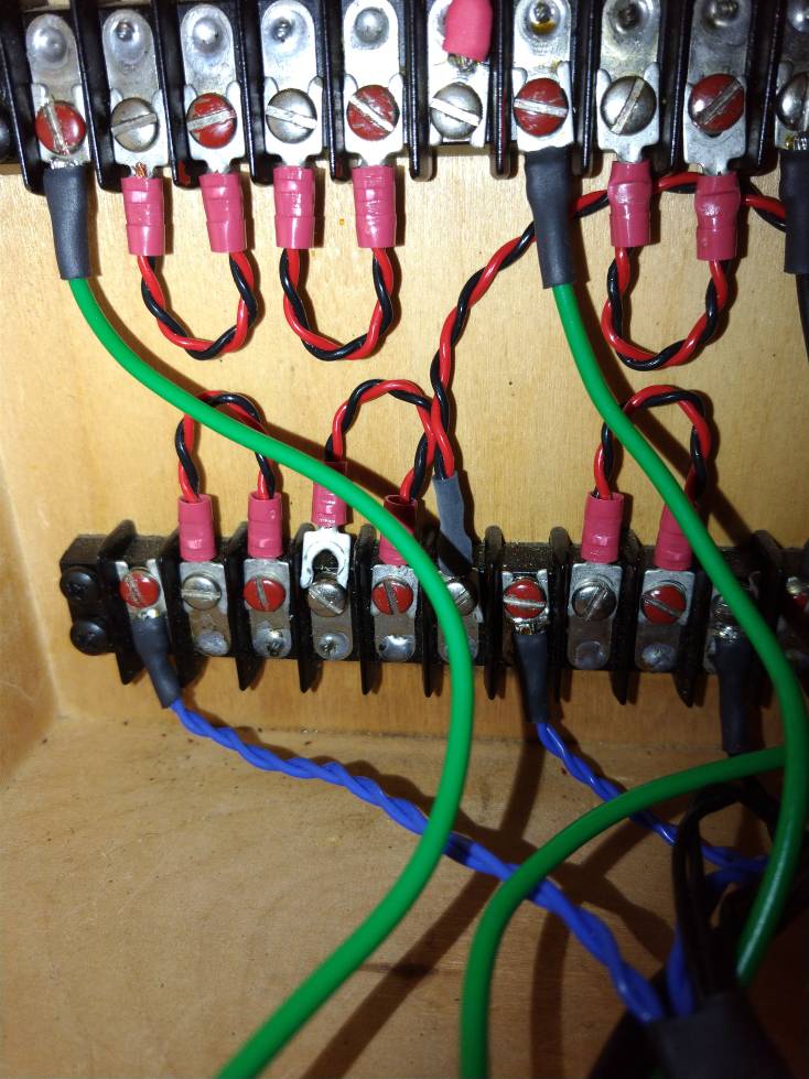

I have terminal strips in divided compartments in my line arrays. 3 way actives with external servo subs.
Only picture I have of the terminals..

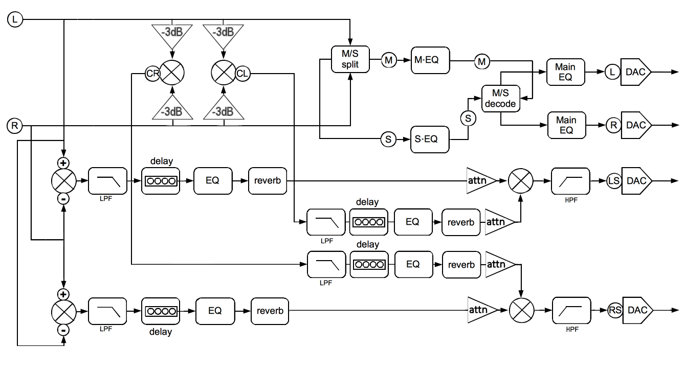

I just love JRiver, because it allows me to do this:
attachment.php
The subwoofers are missing in the above flow chart. this is just the stereo/ambience setup.
With 65356 taps FIR filters and I'm using all the EQ banks within JRiver plus I added a few 🙂. But hey, I'm just a little bit crazy.
Be sure you can run plugins, like convolution etc, you'll be alright.

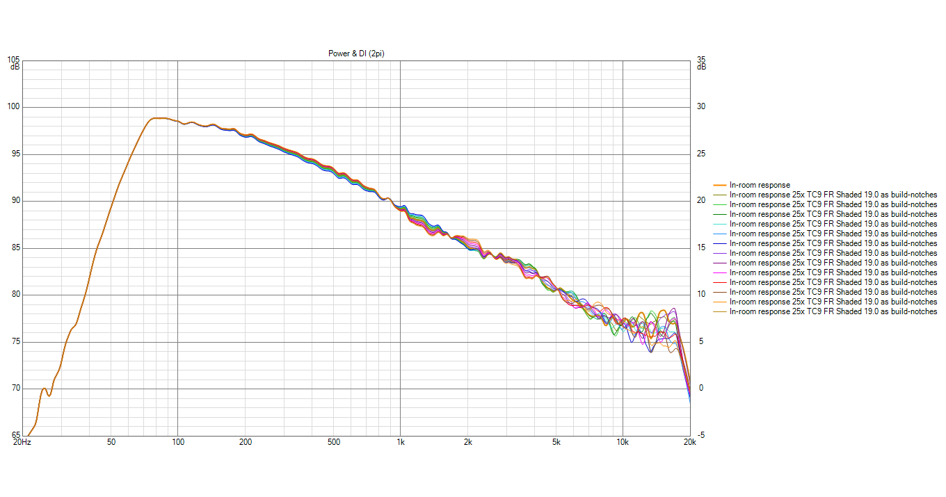

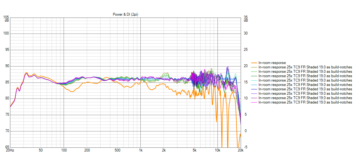

Output of the corrected array (with notches) with a single driver FIR correction on it:
attachment.php
(same circumstances as the alternatively wired array from a few days ago)
Plotted from -102 to + 102 mm, every 17mm.
No room reflections present in this prediction. It shows well behaved output up to high frequencies, fitting within +/- 1 dB over a wide range. With the advantage that you get to keep most of that with floor and ceiling reflections.

It seems one cannot do too much sims. The sim above has thought me something new.
If I drop my listening axis by 2 cm, the top end will behave even closer to the one driver result. Which means all of the other vertical angles will be slightly better behaved as well.
I never would have figured that out by myself.
It's quite specific to my array and driver distances, filters used etc. But it would even matter in an unshaded array.
One of the objectives in my specific filter generation was to get closer to that one driver result with my correction. That's where I kept a close eye on what shape the correction would show. By running the array with the filter generated for one driver I could see which height was close to flat in the top end. that ends up as 980 mm from the floor.

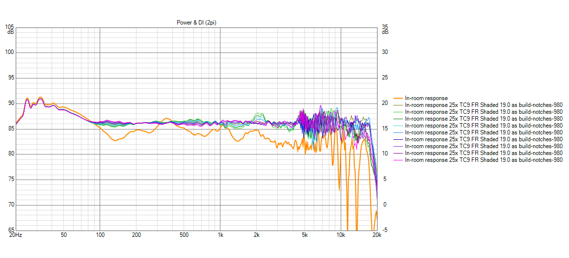

Here's a comparison of vertical heights between a FIR correction at 1000mm and 980mm.
First the original correction height:
attachment.php
compared to the position 20mm lower:
attachment.php
The listening positions are exactly the same, only the correction height is different. So no sawing of chair legs etc 😉. Not even an adjustment of the array height.
(don't look at results below 1 KHz, as I didn't bother straightening out the prior 1000mm correction there)
The absorption of floor and ceiling are set at -6 dB.

You killed that peak in the middle of the top octave but the rest looks pretty much the same. Butterfly effect? I'm seeing that elsewhere in my sims - sometimes small changes in vertical offset have large changes in FR, especially when cancellation is involved.
I came to the same conclusion, correcting at 1000 + a bit of small EQ (if needed) would end up the same, or at least close enough.
