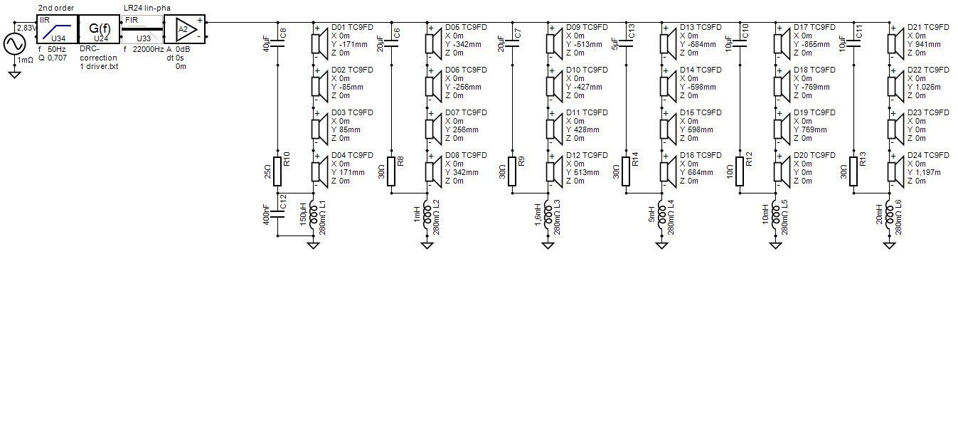

Schematic:
attachment.php

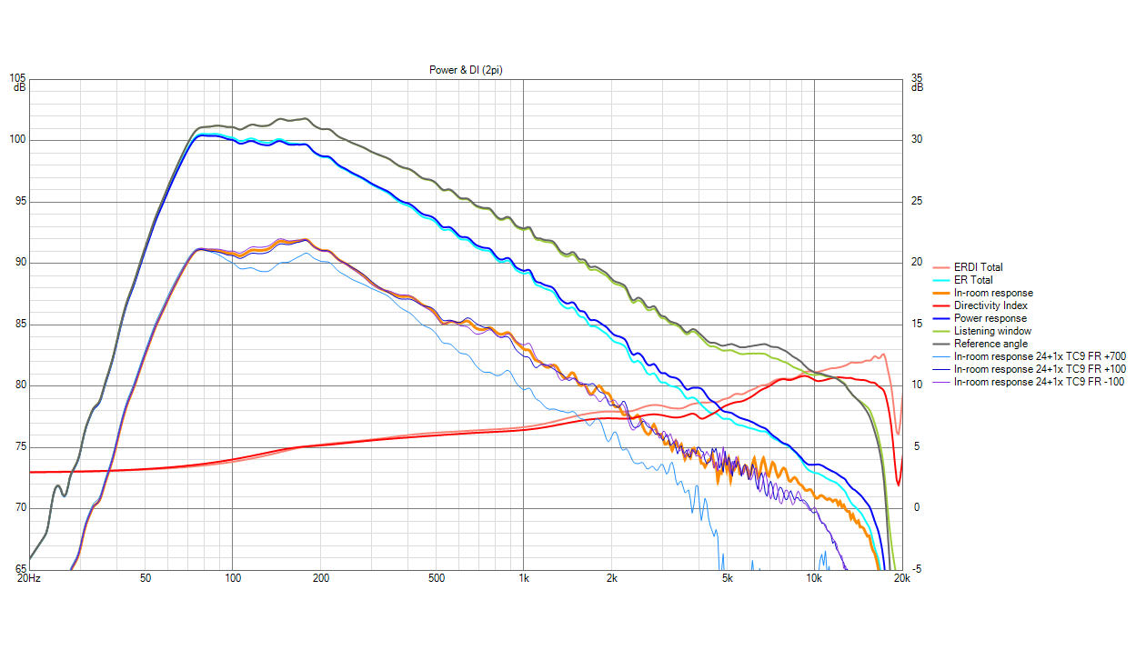

As the correction I used the FIR correction file for a single TC9.
According to line array theory, this should give me a 3 dB/octave drop, right?
attachment.php
Positions 0, +100, -100 and +700 (floor and ceiling reflections on at -12 dB)

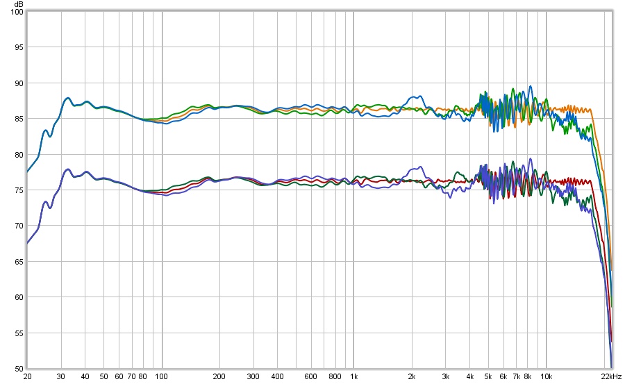

To notch or not to notch...
attachment.php
The above graph shows positions of mic heights 0 +100 and -100.
The offset of 10 dB between them is for comparing, the upper graph has 2 notches (on specific drivers, to series notches so 6 components total) added.
The idea to try this came from the alternative array as presented a couple of days ago. It showed a high degree of symmetry works well to get vertical positions more even in balance. But it's a delicate process.
As I haven't yet closed up the first speaker, it would be an option to add these two notches per array. The bigger question; would it be worth it?
The graphs are plotted with floor and ceiling reflections set to on, as in-room responses, absorption on floor and ceiling both set at -6 dB.
What can be seen is that the 3-4 KHz area is closer to the optimal center position with those notches added. The bump at ~2 KHz I cannot relieve easily, or I would have. This has to do with the floor mostly. It is the upper +100 mm mic position, you can also see a bump at 8 KHz, which is primarily there to keep a good standing outcome. Compromises/sacrifices ;).
I've checked the further position, above is the sweetspot, meaning about half a meter back. There, the 3 to 5 KHZ is more bundled as well with the notches added. (That would be the HT position on the couch ;))
About 6 extra components needed, small ones like 2 and 2,5 mH inductors, 15 and 20 Ohm resistors and a pair of 1 uF capacitors per array.
Why do I bother? Knowing we can have close to this outcome at the listening position, this area falls within the cross talk region, blind spot at ~1.8 KHz, more output at ~3.7 KHz, another smaller blind spot at 5.5 KHz and finally another small bump at 7.2 KHz. That's the biggest area that get targeted by mid/side EQ. small differences here (especially in the bumps, eg. 3.7 and 7.2) can change our perception pretty strong.
The blind spots (real dips at ear positions) are less sensitive to changes.
These details become more and more important to get right once the amount of (early) reflections is diminished. A single driver would have pretty strong floor and ceiling effects in that same region in similar circumstances. Pretty much helping to hide that cross talk. I believe that is what gives arrays their specific character compared to most other speakers. As said, i'm not talking about larger than life imaging that's mentioned so often. That disappears once we start using DSP to re-align the wave front. I'm getting at the fact that things like cross talk are more clear, but if you're successful to work around it, imaging gets a pretty strong boost from the "they are here" that most speakers get to the "you are there" kind of presentation that I prefer. Clear, open and dynamic sound with holographic properties, at least that's the potential that I hope to improve upon with these tweaks.
Any opinions? :)

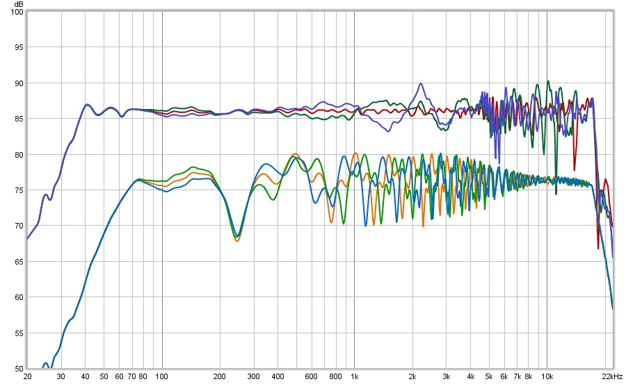

No takers? Maybe if i show a comparison under the same conditions of the unshaded array and a single driver:
attachment.php
Don't mind what happens below 500 Hz, where the unshaded array looks to be having an advantage. The difference is I EQ-ed the in-room response of the two earlier examples with ceiling reflections off (accidentally).
The floor bounce of the single driver is obvious. There's a hole thread about things one can do to improve floor bounce results over in multi way. Fluid gave the answer that I think was spot on, no one seemed to care about the answer.
But here's the proof of that specific pudding.
The way I see it, these graphs with a specific absorption/reflection level set for floor and ceiling isn't what we are going to see. One may have a rug between speaker and listening spot. Another has concrete floors or hardwood. Ceilings differ too, and no material will act the same throughout the whole frequency spectrum anyway. But I do believe that residual patterns like this may clue our brain in on things like room size.
In that case, the arrays will throw that off. Being so directional over a wide bandwidth to avoid most of the reflections, it acts way different than most.
If this is an advantage or a draw back, remains to be seen. So far I've put it in the "advantage" box, which is why I try and optimize that part of its behavior.
