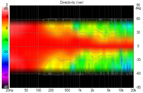

Here is another take on this:

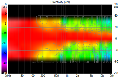

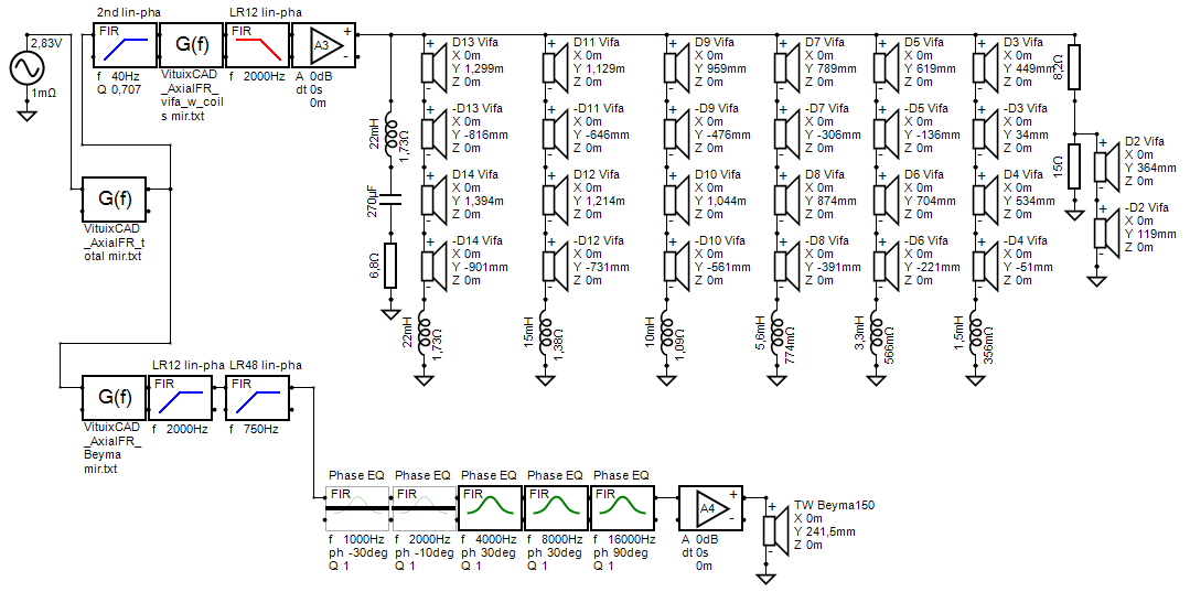

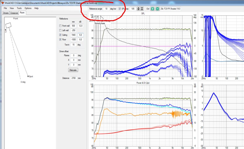

As you see, the TLP-150 is placed in the middle point between floor and ceiling, that is 241.5 mm above listening axis. The seated listening position (100 cm above floor) is therefore about 4.6 degrees below axis. Standing up is about 10.5 degrees above axis.
A dramatic increase of directivity in the last octave, but I think its looking quite good before that. The phase eq:s improves the dispersion in the 2-10kHz range. A comparison with and without phase eq:s:
With phase EQ:s:
Phase EQ:s disabled:
With phase EQ:s:

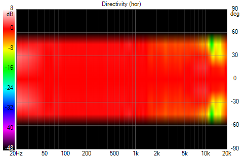

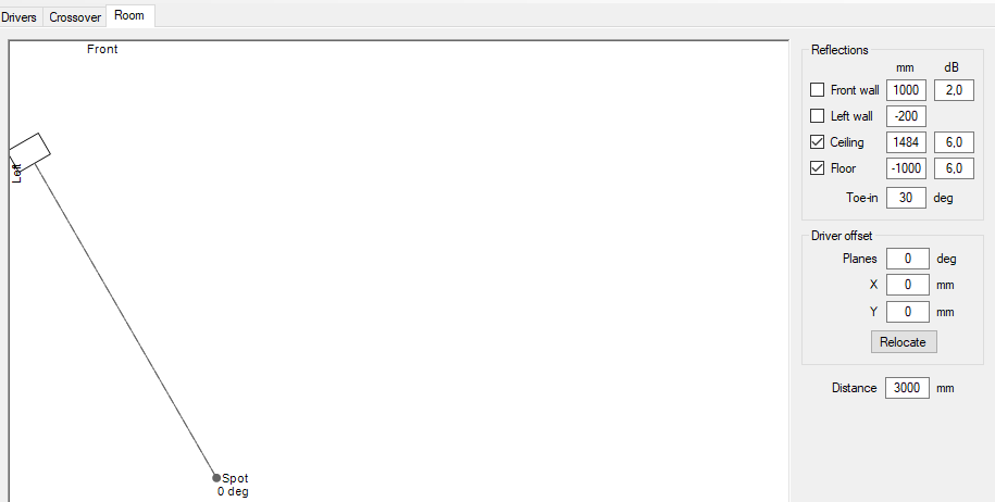

A couple of questions if I may, what does the horizontal directivity look like?
And what is the absorption of the room 's floor and ceiling set to?
Last question for now, is this plot with toe in of the speaker?
In your shoes I'd plot all angles of interest and all heights with keeping in mind a slight up/down movement (or different sized family members), to check the in room prediction. For that you need to move the driver stack and modify floor and ceiling height to vary the in-room prediction for vertical positions.
Horizontal angle is just typing in a different reference angle.
I ask for the horizontal directivity plot, as the vertical plot doesn't give me the clues why there is such a sudden change in the DI index or Power Response.
I use the speaker with 15 degree toe-in and have set my reference angle at 10 degrees. above that. I do this because moving off axis (with the left ear) to the right side would only mean moving slightly beyond that 10 degree reference angle.
The right ear, that is listening to the right speaker, would move far more in degrees respectively. This is because my microphone position is slightly in front of the couch, with the seated positions for more than one listener I place them on that couch .
Drawing it all out on a napkin with an averaged size head should help make sense of it.

Here's the horizontal directivity:
And here is the settings in the Room tab:
Haven't played so much with those settings, but ceiling and floor absorption is set to 6 dB. The toe-in was set to 30 deg. How do you set the reference angle? I tries changing the "User hor" in Options, but nothing happened?
I will try moving the stack and floor/ceiling heights to get those responses!
Thanks for helping me out!

Reference angle is mentioned above the graphs,
If you want to move the listening plane higher, you need to lower all drivers.
For instance: Driver offset Y would be -300, in your room the floor would be -1300 and ceiling 1184.
The graphics in bottom left should change to represent that change. If you have that height of interest, you can export it to be able to load it into REW for further research etc. File -> Export -> In-room Response
It won't have phase or an actual IR, just the frequency curve is exported.
That way you can see if it lives up to your expectations.

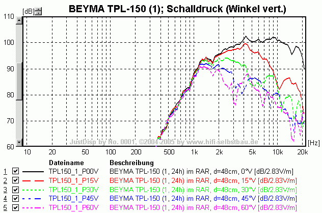

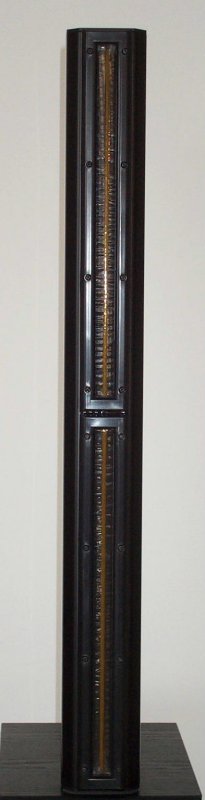

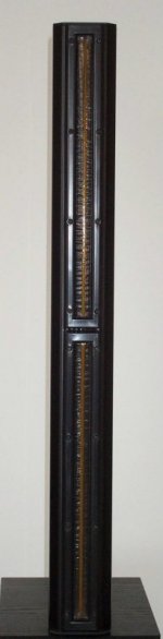

Speaking of long ribbons, Newform Research makes them .75" wide, 30" tall. I'm working on a model now....
Not much info on their site... so the R15 is 15" and the R30 is two of them making it 30"?
I remember lots of people running the Bohlender Graebener RD75 etc. but most of them experienced quite a few problems. I have PM-ed with a TC9 array owner who went that route and never got it to sound quite as good as that simple line of TC9's. He didn't post publicly about it so I will withhold his handle.
I hope quality control is better on these, it should be fun what one can do with it. Hope to find more info than their rather uninspiring online spec sheet.
I'm hoping to see more about them than what they present out on their website.

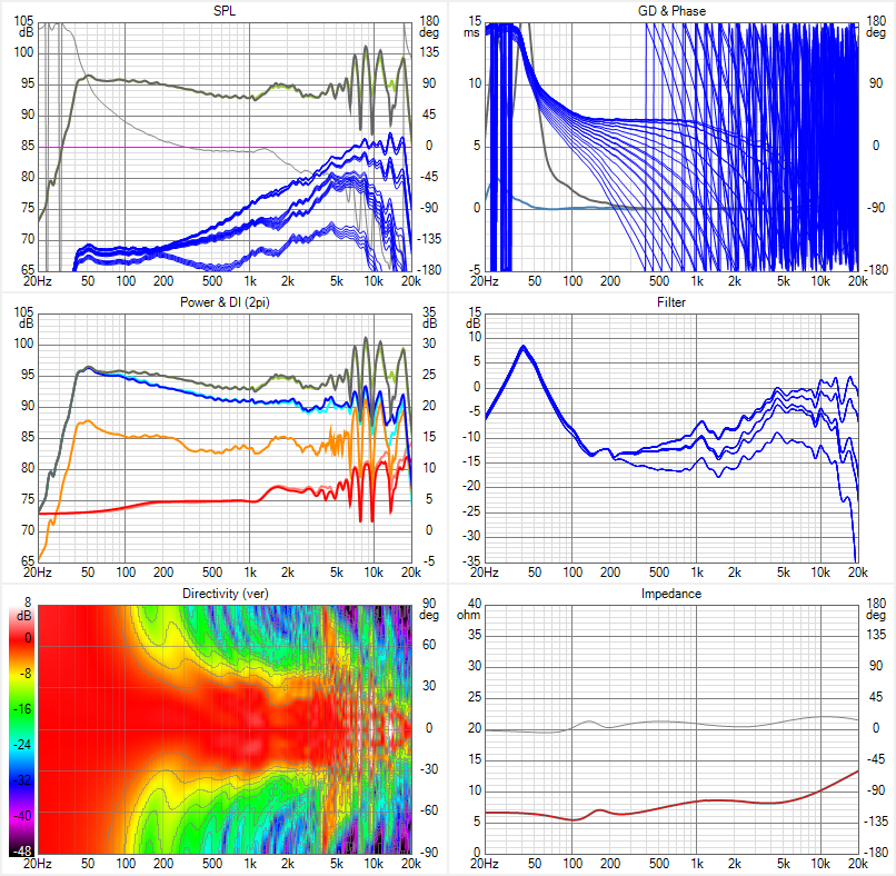

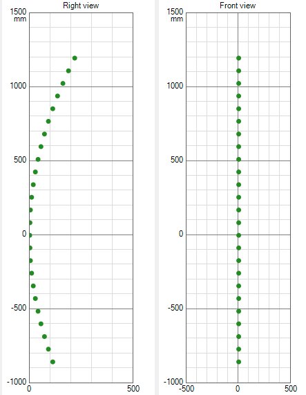

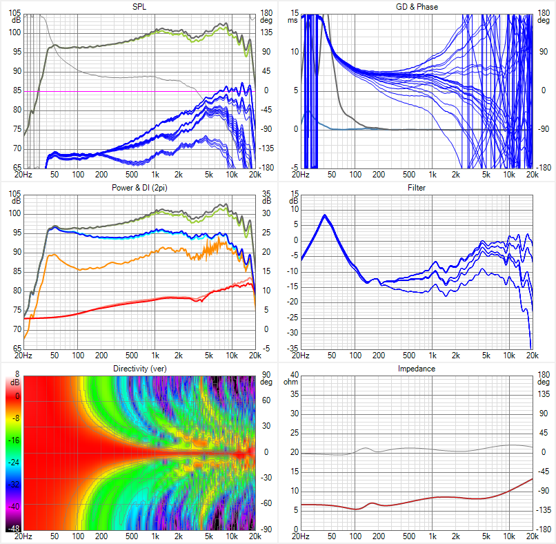

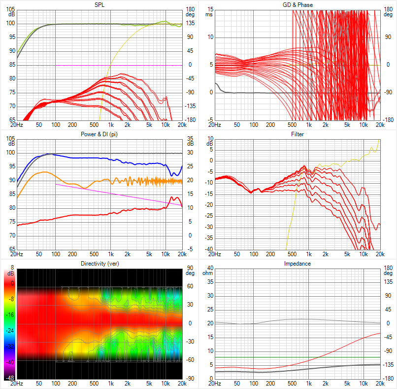

Just for fun I wanted to see what the output would look like if I added delay to the groups above and below the central drivers.
I didn't re-EQ, but the plot looks like this:
See how small the vertical directivity gets? Awesome!

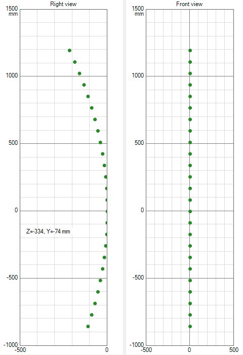

Here's the driver placement. What I did is move back each group based on the largest difference in distance between it and the central driver.
(basically doubling it's delay, to move it back from the leading group, I could try it both ways, making it a more focused assay as well)
The result at the exact sweetspot would be awesome! You can see how the in room plot follows the EQ, so it can be perfectly flat without floor and ceiling influence messing it up all that much. (they are on at -6 dB each)
But the bad news: it doesn't hold up if we move up or down...
I could make it a completely bend CBT, individually moving each driver. But ideally it would also mean moving the unshaded group to the bottom for it to resemble the CBT as we know it.

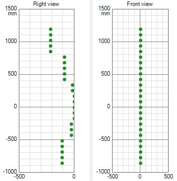

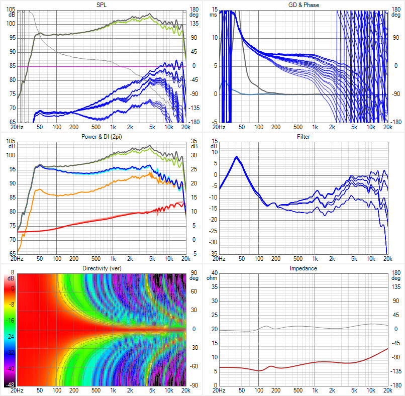

The following is a CBT like array:
Using the same numbers as before, but now on a driver by driver base.
The driver placement results in:
See how it widens the directivity below 4 KHz? The top end is beyond rescue though. Not much I can think of to save that!
I was just misreading the driver plot in Vituixcad. So that's the result of a focused array...
So I better post one more, once again, the focused array, this time on a driver by driver base:
And the driver model:
That would be an option for a fine sweet spot . The first sim posted with the groups of drivers delayed seems better in some regards,
if we can believe it's DI plot, this one is cleaner though. The shading of the groups still is what I chose for my straight optimized array.
So shading groups of drivers, hence the little differences in these plots.
If you can live with a ~10 cm vertical sweet spot... the focused array might be a valid solution .
Note: for the last two sims, the floor and ceiling reflections are set to on and they flipped back to -12 dB, so take it as is.
This is just me satisfying my curiosity here.
That's it for today though...
Maybe I'll do a proper ground plane CBT out of curiosity as well. Just to have seen it in raw shape.

Based on these tests I've tried to optimize my sim results even further(**) to see if I could widen the top end beam. I can, if I operate on a driver to driver level, but it doesn't mean all other areas of interest get better too. ** manipulating the filters again, not with delay **
As I see it, this set of filters I have come up with, improve upon the straight array performance (if they work like the sim tells us) on basically every level that has my interest. At the sweet spot, moving up/down vertically, from a larger distance and even standing up.
I bet I could make an even better proposition, if I were to wire the array differently. Nah, maybe I won't take that bet, as it would involve accepting other compromises that could make it hard to achieve.

- you delayed and attenuated the channels so that;
t=0 ms went to driver 13 from bottom, 0 attenuation (at equator)
t=0,24 ms went to driver 12 & 14 from bottom, attenuated = 0,1m (?) air attenuation
t=2,9 ms went to driver 1 & 25 from bottom, attenuated = 1m air attenuation (at poles)
thus exhibiting I hope a spherical wave.
Would this work to any advantages? Would the offset in phase due to delay take away some of the destructive interference due to driver c/c?
Has this been done? (surely!)
DACs and amps start to get low price with still decent performance - DSP function is already here more or less
It would be near impossible to get that using full range drivers.
I know what you're trying to do, which is also part of the ideas behind the CBT. My post above isn't an example of a well done CBT though!
But you'd need very tiny speakers close together to re-create that wave front. Not a full range that transitions to more of a bending wave apparatus to be able to play high notes.
At least, that's what I get out of it. The gaps (and/or imperfections) are too big to be able to recreate the bubble you show. Too coarse pixels so to speak...
A big horn could probably get you closer, just find a way to get all frequencies in there (ala Danley?) without upsetting that wave front you've just created.
