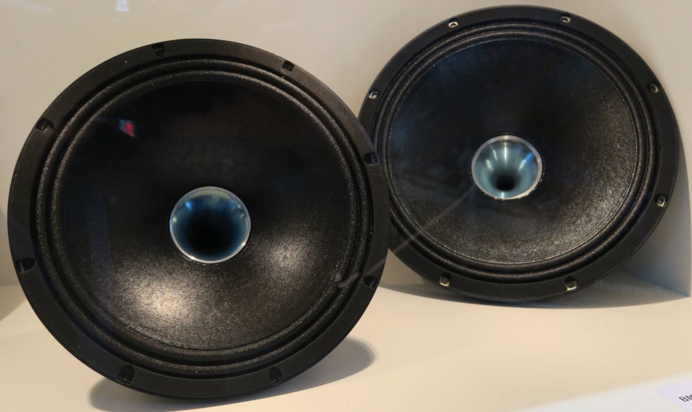

I would take either the BMS 10C262 or 12C362 (left and right in the first pictur), provided the metal exit section can be omitted to order or removed afterwards. You also need a CAD drawing of the compression driver's exit. Then print, or have machined a custom exit section, or better, a complete horn that matches and attaches to the compression driver's exit.
I prefer an asymmetrical horn. Either rectangular or asymmetrical, the horn must be large.
Then make holes/slits at the correct distance from the exit (XO shall be about 800 Hz for the 12" and slightly higher for the 10").

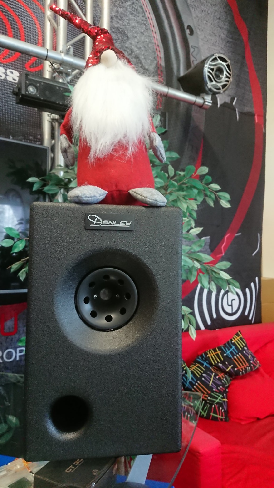

The concept is similar to the Danley Studio One, only much bigger.
To cover 20-150Hz, I would probably slot- or hornload two BMS 15" or 18" subwoofers, et voilà!
Obviously, this is a far too simple sketch, because it must be determined, among other things, whether the woofer will have a compression chamber or a vent.

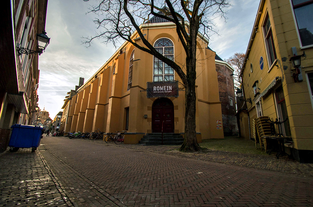

I must have mentioned it before... This is a Venue that I truly loved for it's sound:
Poppodium Romein, Leeuwarden.
An old Church with large heavy drapes, intimate, yet great sound.
Source of the picture: poppodium-romein-leeuwarden-yp-hotspot-2 - LeeuwarderNet, I Guess I'll probably be there somewhere in that crowd.
Been there until it closed down, the newer Venues I visited after that did not quite have an atmosphere like it.
If anything, that's the sound (or rather the atmosphere) I want to experience in my room... one can dream right? 😀
I've been in lots of bigger places, lots of smaller places, similar sized spaces but there was something about that specific place that just worked.
I also liked "de Melkweg" and "Paradiso" but "Romein" stood out for it's sonic presence.

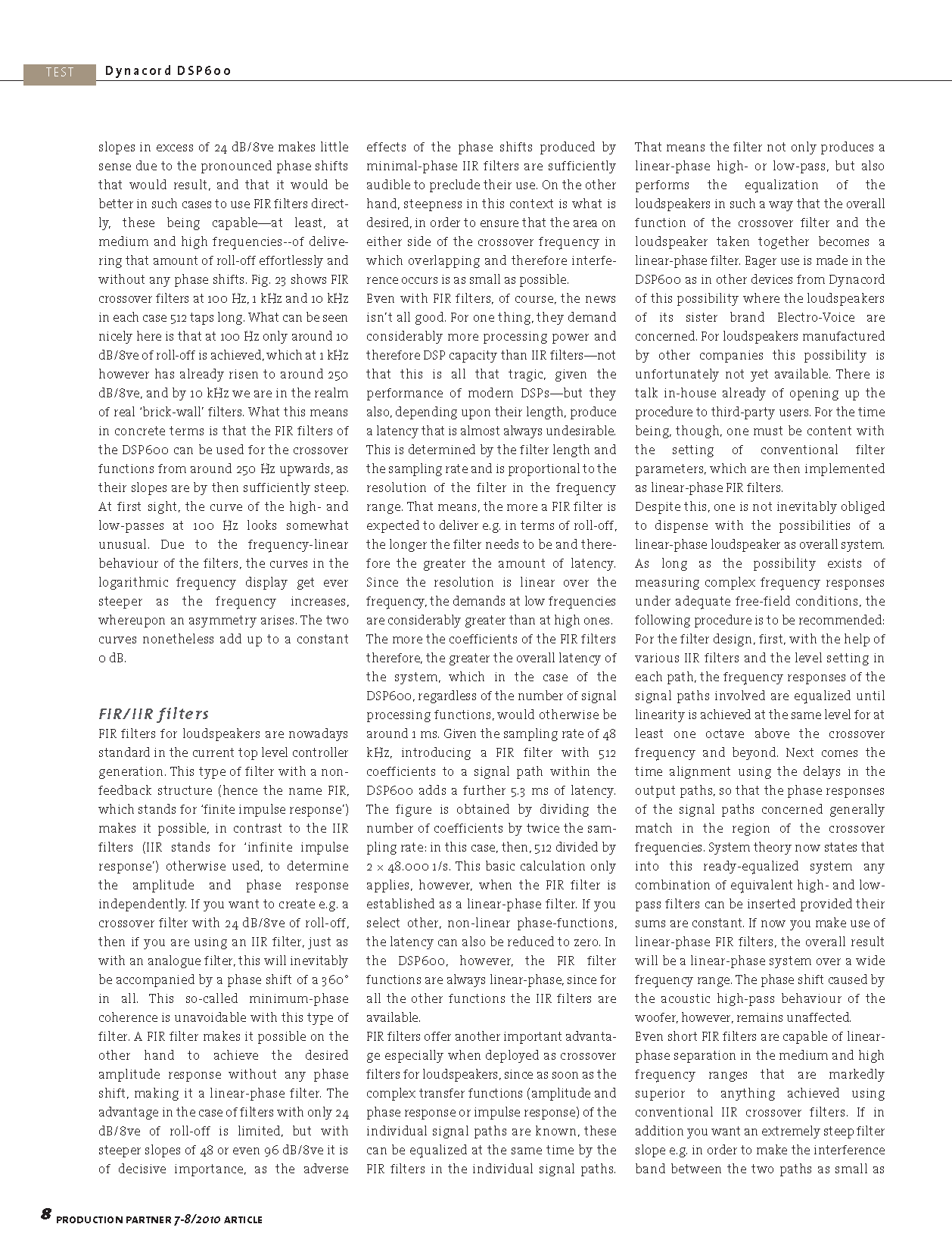

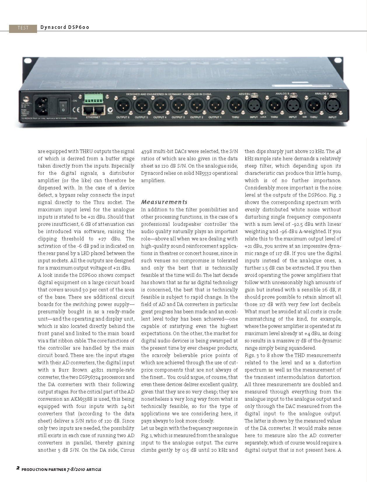

This was the P.A. system in the big room of Romein:
Dynacord Cobra 2
6x Cobra top
8x Cobra 18” sub
Dynacord/Electrovoice DSP600 system processor
Chevin Amps
The Cobra system is almost vintage by today's standards, but it was very populair in NL.

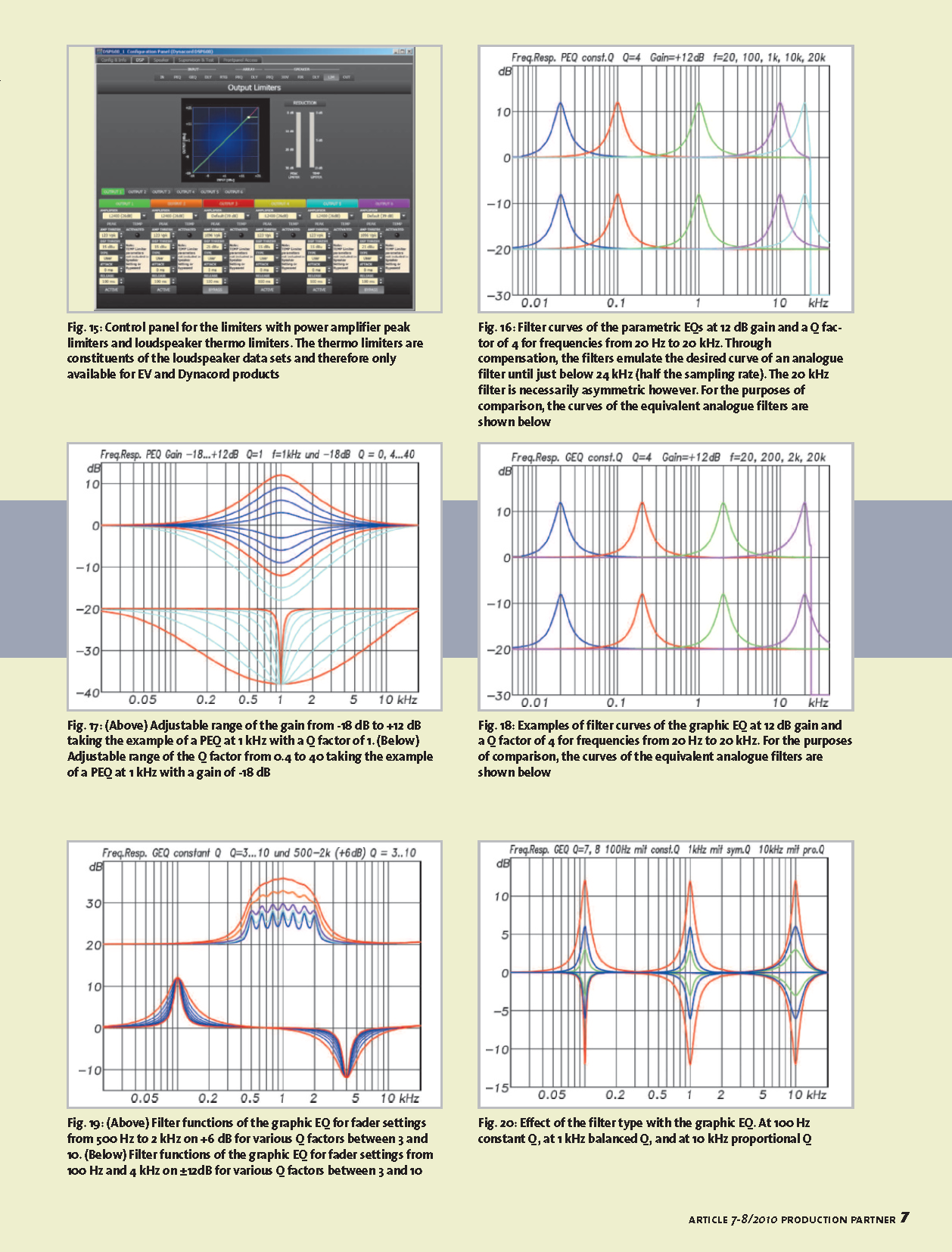

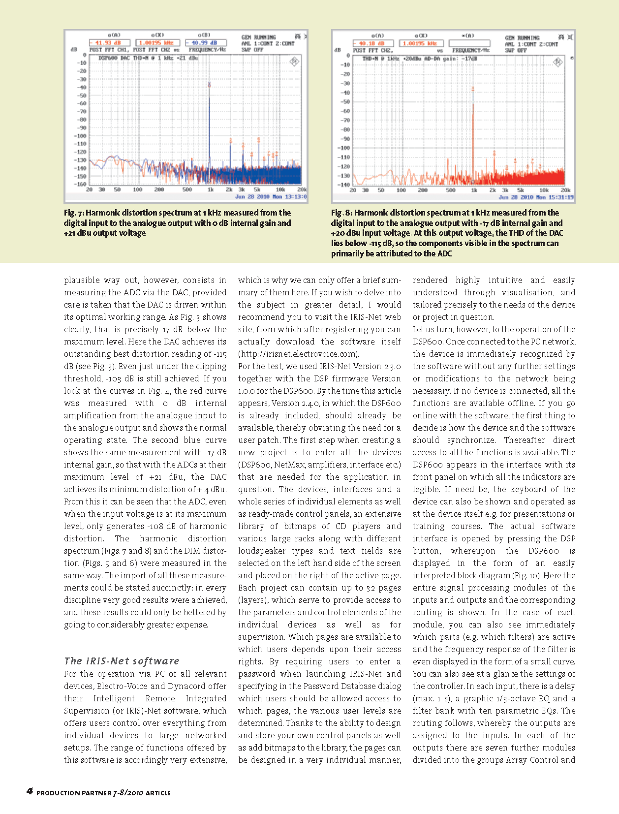

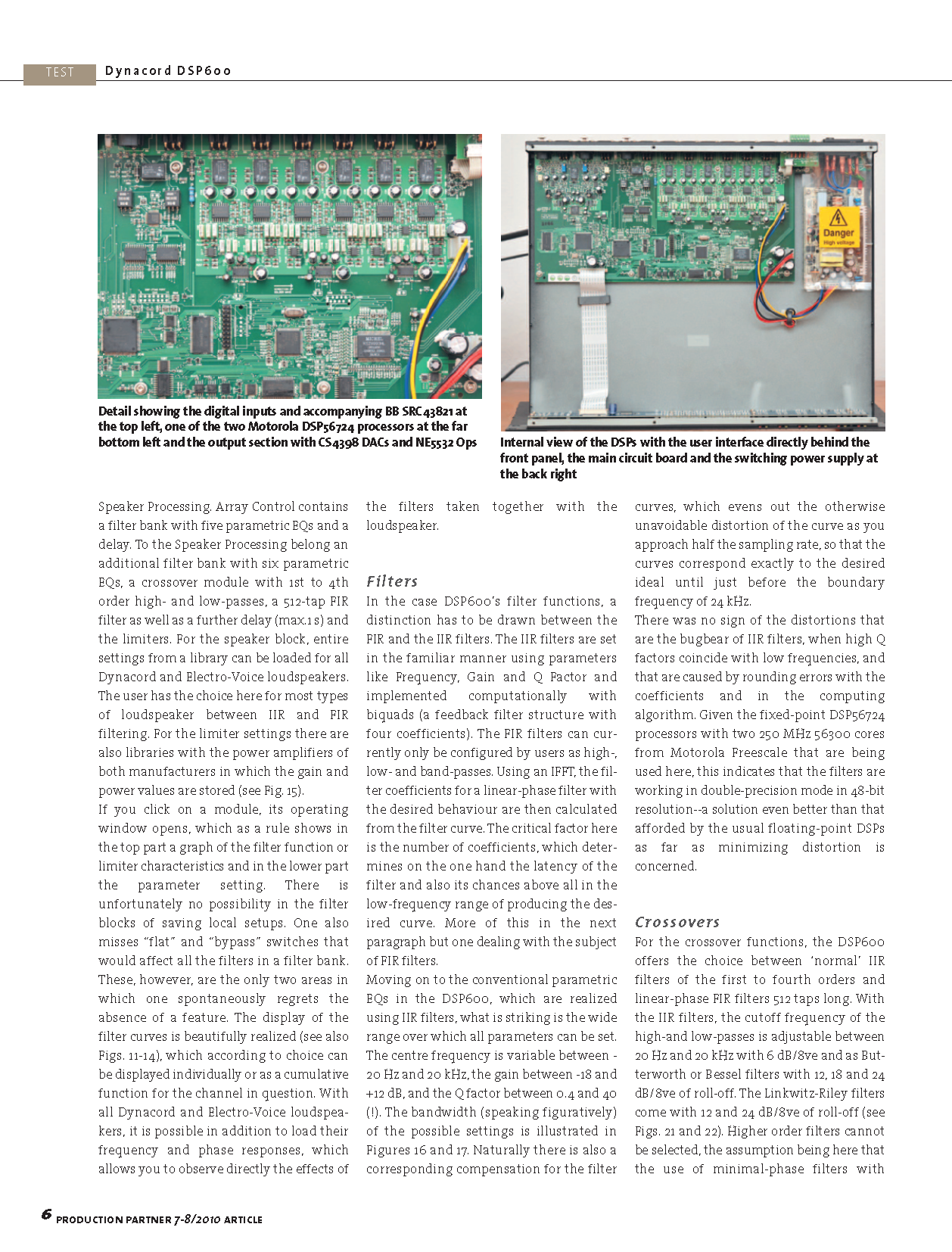

I guess the DSP 600 was an important contributor to the sound quality of the system. The same applies to the Chevin amps, that I have also owned and appreciated.
The DSP 600 (= Electro-Voice DX46) was probably one of the most advanced and best sounding loudspeaker management systems at the time of its launch, more than 10 years ago.
