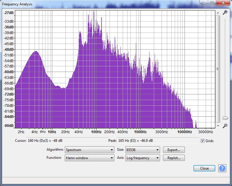

Just for fun I ran these tracks through the Spectrum analyzer from Audacity, it's only the first 109 seconds, and the last track being 44100 deviates from the other two.
Here's the upload from Ro808 :

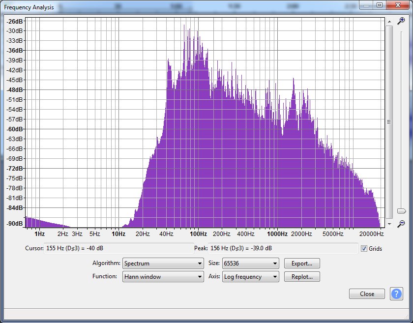

Here's the High Res:

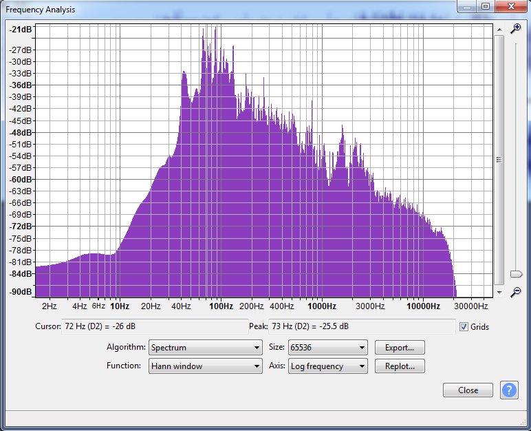

And finally the SHM-CD:
( I really should convert it to 24/96 to make it fair)
Differences in spectrum can be seen, a little rumble on the vinyl version but also more HF extension on the High Res and SHM-CD version.
It looks like the balance is quite different between the High Res and SHM-CD, though the general shape seems to indicate its using the same master.
The balance between the vinyl and the High Res is more alike on first glance.
