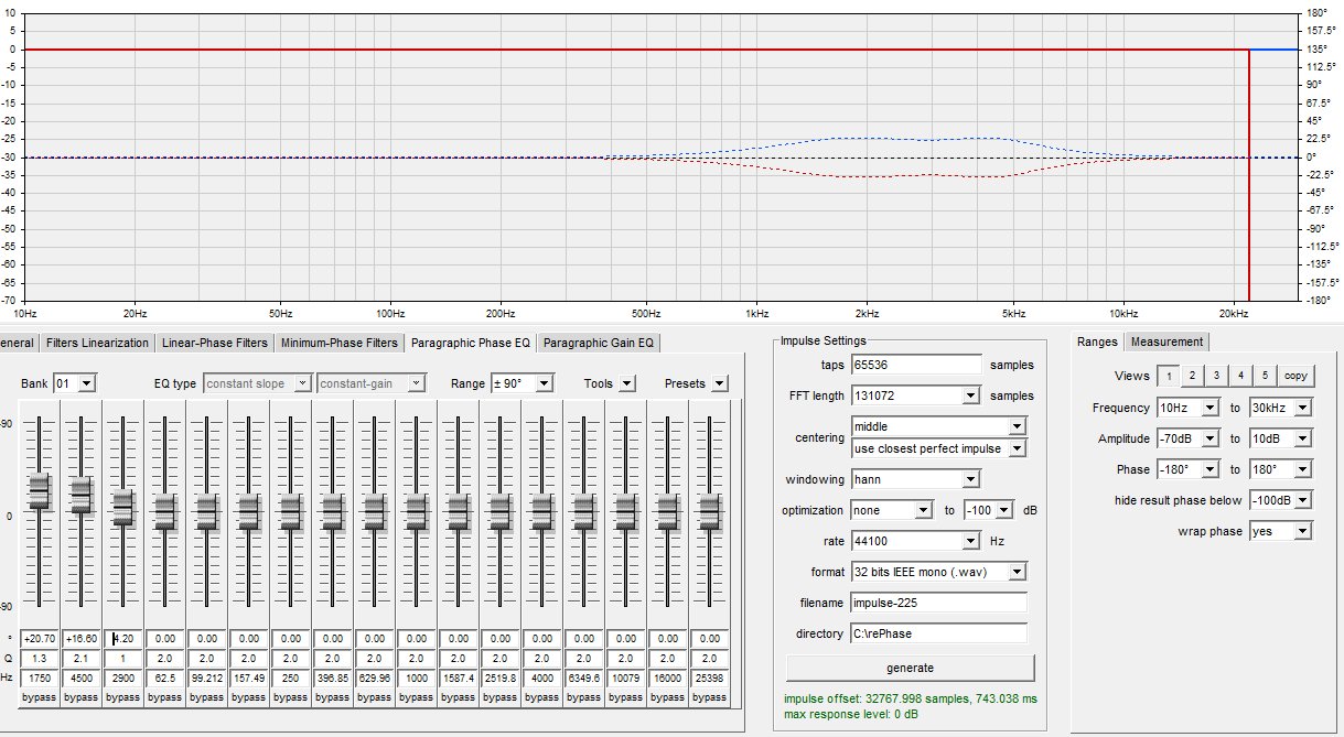

I had to see if ra7's version of a crosstalk phase scrambler did any different from my earlier experiments...
So I created the RePhase impulses with about a 22.5 degree difference:

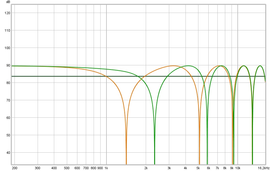

And in REW I tried to sum them as I did with my previous attempt, where I found the explanation of why it seemed to favor one side over the other.
The simple sum (actual results at the ear would be far more complex):
Here is the sum at the ear after a millisecond has passed:
And here's the other ear:
The biggest difference is happening before enough time has passed to hear the other speaker:
vs:
There is a balance difference between these two, in other words, before the cross talk has (normally) taken place. What do i mean by that? Due to the phase angle difference, one speaker is playing a bit before the other (over the changed phase range) and thus, is showing up in the signal at one ear, prior to where the sound of the further speaker reaches our ear. That's a very brief moment (0.27 ms was taken as the average delay here).
I'll have to look back at my own tries, if I had troubles before the cross talk time had passed or that my troubles were from an imbalance after the cross talk. The way I see it here, this could work! Yes, you would have the signal from one speaker just ahead of the other in the affected range, but it is so minimal. And it happens at a point where phase isn't used for identifying image queues. Intensity is, so would that slight imbalance in the first few ms be enough to upset anything? Even after that full millisecond, there still is a slight SPL difference in both results, but that could be EQ-ed away.
In the first ~3ms, the imbalance is the difference between 83.5 and 89.5 dB.
The average "in head" balance with this phase tweak at the sweetspot will be better than not doing anything at all.
I should try and process off axis seats the same way to see what happens there. That would tell me if this favors one listening side over the other, in a similar way I had it happen to me in earlier tries. It would only be audible with enough absence of early room reflections though. I was rather critical about it.
But the thing is, I first heard, out in the room listening to music, there was an imbalance, even before I went looking at the plots to prove it. I have lived with it for a couple of weeks before I abandoned that solution. For that reason I have thought long and hard about an alternating shuffler 😀. Alternating between the channels as not to favor one side.

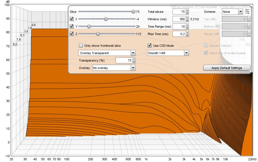

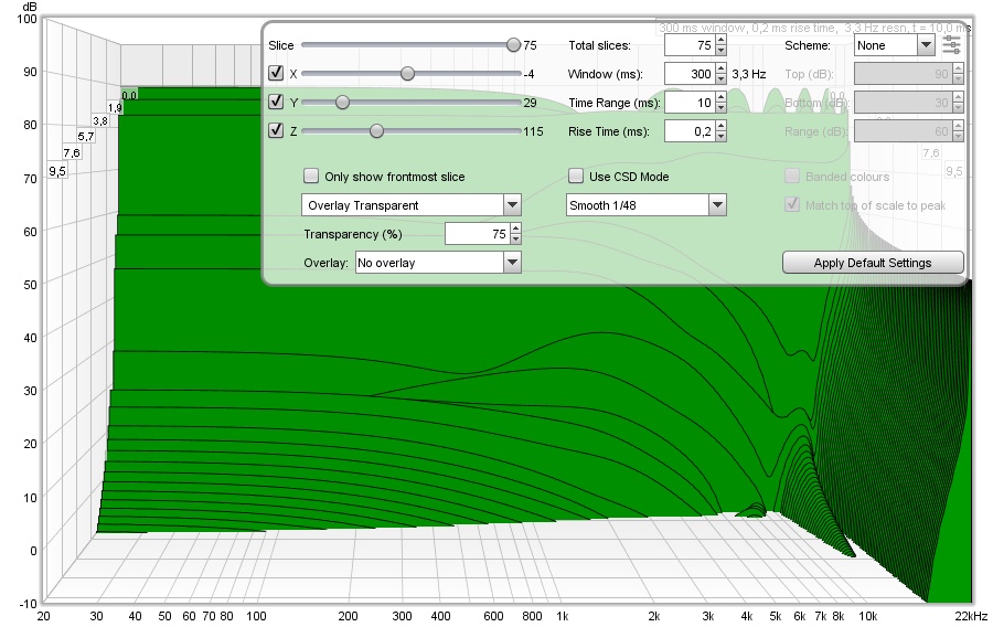

P.S. that use CSD mode that I accidentally clicked on one graph had no effect. Clearly one side is a little ahead over the other which is due to their phase difference. That means it sums a little earlier than the other side.

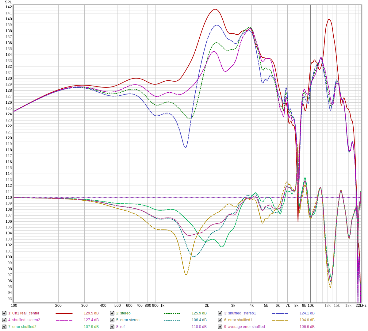

Here are the magnitude responses I got using MIT's anechoic KEMAR data:
Based on the graph from bmc0, the dip at ~1750 is the biggest deviation, the shuffler shaves off an average of 4 dB. But around 5.5 KHz the differences are small, maybe even small enough to neglect the correction running all the way up there? So making it work on a shorter range might work just as well.
I didn't expect that big of a difference at 13.5 KHz though. I had assumed head shading would be effective enough for it not to matter as much.
I still can't quite grasp the sum I get in REW before enough time has passed to have cross talk in a normal situation. It seems like the phase tweak moves one entire channel up in time, and slows down the other, instead of restricting it to the targeted area. How else do I get such a sum like that over that wide of an area. That sum is making the level difference between both channels stand out.
