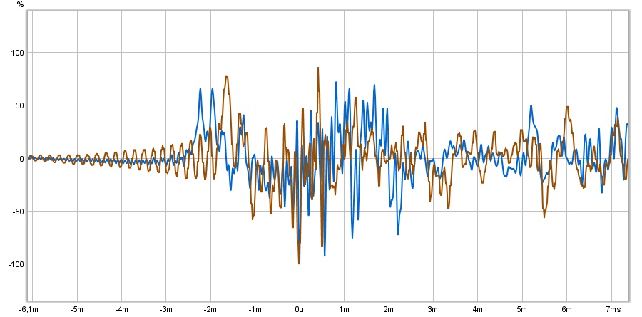

I've been researching decorrelation methods over the past few days and happened to find (and implement) one that seems to work pretty well as a faux stereo effect. The paper is here and there is a sound sample on the author's website. I can attach an impulse response for the effect if you want.
Please do, it will be easy enough to combine it with the ambient FIR filters.

Alright, here you go 🙂. I've attached 44.1kHz and 48kHz versions. Let me know if you want a different sample rate.
The average group delay is about 8.5ms, so you may want to reduce the ambience channel delay accordingly.
Thanks for that, can't wait to get everything back online.

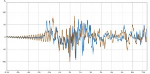

If I look at the IR's, I'm pretty sure my ambient channels are properly decorrelated as they are at present. Cool to hear the effect on the website with headphones. The side firing speakers I have, reflecting off of random nearby stuff does a good job of decorrelating as well. If I can find it I'll post an example somewhere this weekend.
Oh right, I forgot about how you have those set up. In that case, the extra decorrelation may not do much. It might be useful if you ever decide to try a more conventional configuration though (say on-wall or otherwise forward-firing).

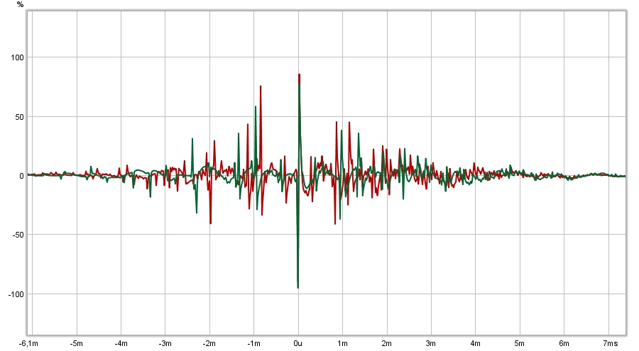

IR's of my ambience channels at the LP:
IR's of the decorrelated signals:

Yes, other people are indeed reading with interest. So, what does a normal implementation look like? Take L, push it through the impulse and send it to surround right?
The decorrelator is intended to supplement some existing ambience extraction technique. A simple example would be
Basically, the decorrelator scrambles the phase of the inputs without changing the magnitude response, so a mono signal (like L-R) sounds more like stereo.
