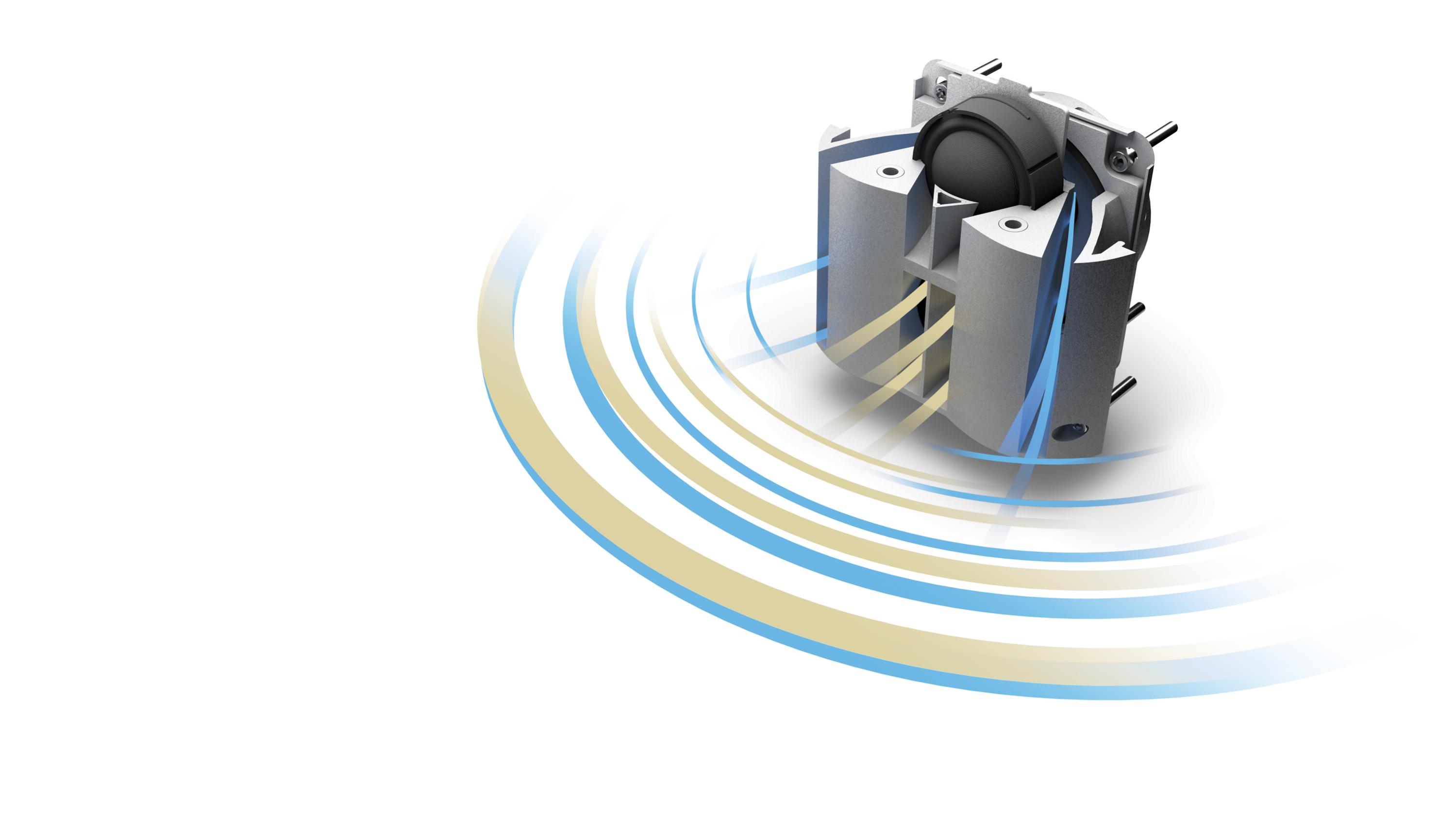

I don't think I've seen that before. Looks like Porsche's part was to create a jacket for it 🙂.
LD Systems MAUI P900 by Porsche Design Studio – Monumental Clarity - YouTube
I couldn't find a real review, aside from a lot of add's. Looks like it is placed just above the Bose L1 product line.
Not that impressed with the wave guide part, unless we see some detailed information, I'd say it is a diffraction slot and not nearly as sophisticated as the line from Danley.
(which isn't acting as a true line, but more like a point source)

What would be worse? I didn't come across measurements of the P900. But it's easy to see the sections on that picture with numerous sharp bends. But I don't see how that creates equal path lengths, something that is present in the Paraline principle.
I do believe there's a lot more solid engineering in the Paraline as opposed to the Maui P900, but neither of them will be without problems when trying to shape the sound.
The SBH10/20 try to make it into a bent wave shape, not a true line. Pretty nifty.

I came across LD MAUI by coincidence and considered it interesting enough to post a few pics. The MAUI and Danley's SBH series reflect two different ways of getting around the inherent handicaps of the column speaker concept.
Acoustics is a complicated subject and it is very difficult, or more likely impossible, to play tricks on Mother Nature without penalties.
