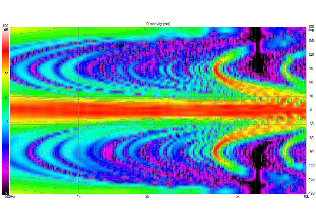

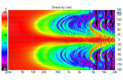

Seeing as we already have the drivers in Vituixcad it's easy to make a 5 driver array by simply dropping the other 20. Let's see what happens:
See how extremely small it makes the vertical beam width? When knowing it is a move from the center of the array to about 14 or 15 degrees off axis in the vertical plane when standing up, I can guarantee this will sound weird, in that standing position!
So, in other words, you need the tall array to steer the directivity. To get the pleasing outcome when moving up or down.

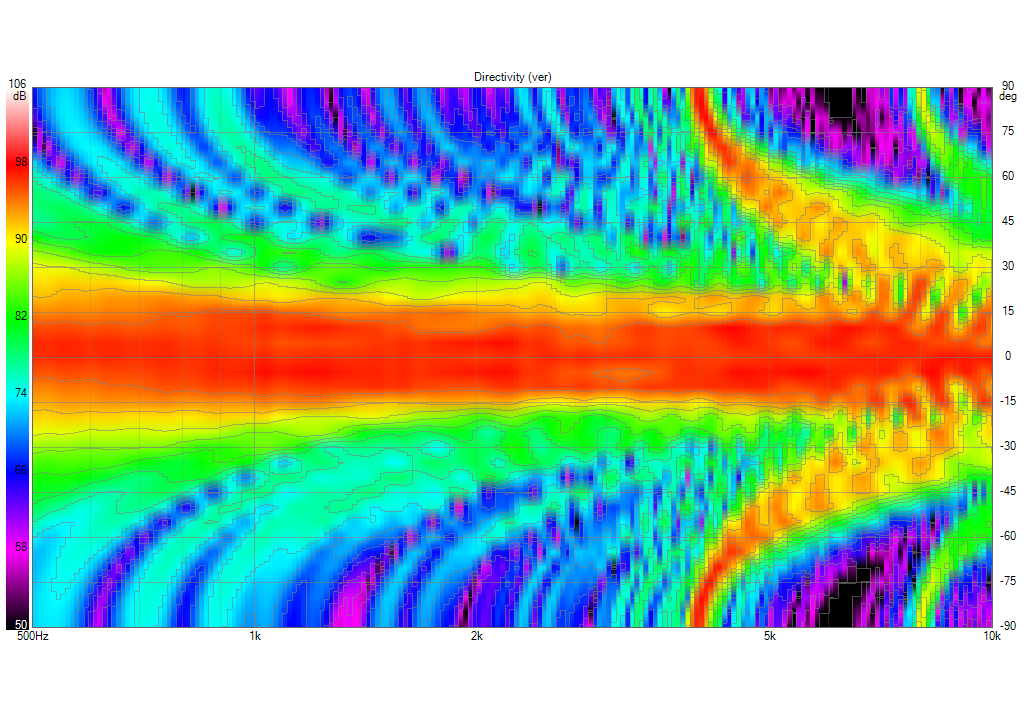

Frequency shaded vs non shaded array:
See how using this many drivers makes the bundle in the middle that much taller? Even with the unshaded array, you get similar tonality over a much wider vertical area. It doesn't flip on and off like a switch. It also makes sure we get that vertical directivity down to a much lower frequency.
So it isn't just done to be an impressive look with all those drivers in a row. It's just part of the concept. We do need them, not only to raise the output with ease, but also to cover that wide vertical area that sounds good. That's why I have arrays, the floor to ceiling kind 😉. (actually about 70% of floor to ceiling height will be enough in most cases)

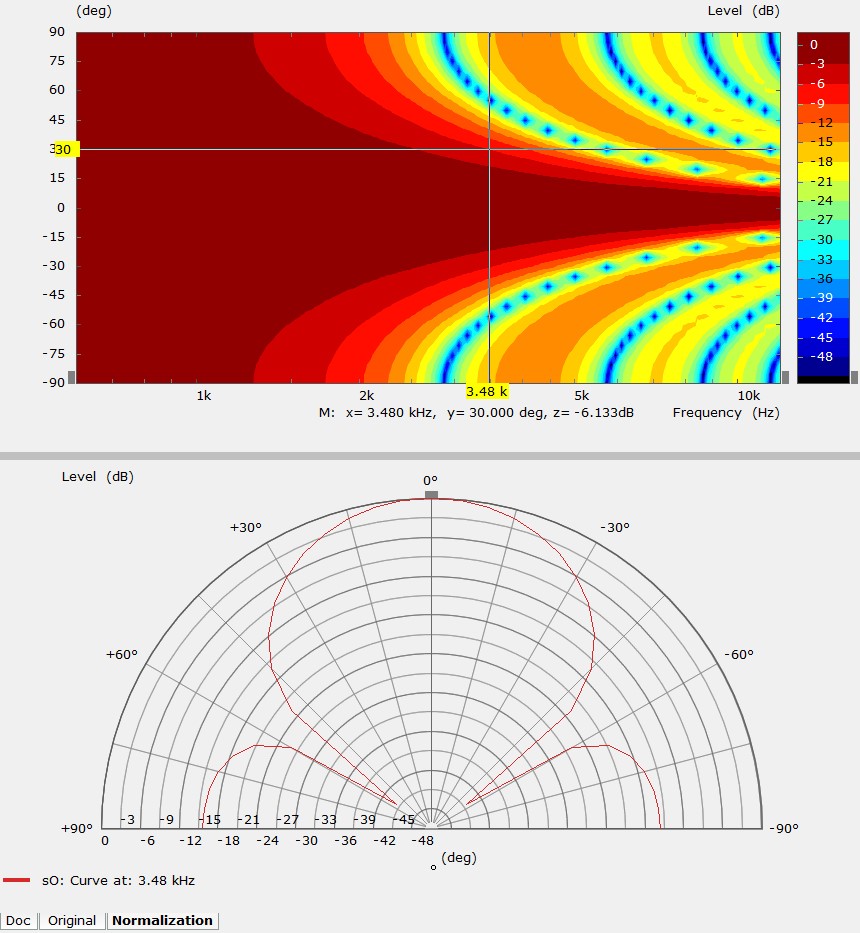

Were you planning on using Mabat's tool to try and create a one-off waveguide? As a sim exercise it should be fun to see if we can work towards a solution. One thing this tweeter would have to be is plenty dynamic. Which is why I would want to run the array as high up as we can and have a sturdy tweeter do the top end.
Out in the real world I will have to learn/find out if going this route is the actual way forward. In other words: do my filters work to create a better, more smooth outcome than an unshaded array?
If it does work, I'd think crossing in the ~3.5 KHz neighborhood should work for a frequency shaded array (with a still to be determined steepness) if we can match the array in pattern control around that frequency. Which would mean realizing an even beam of +/- 15 degree vertical, dropping in SPL reasonably fast beyond that.
And about 50 degree at 3.5 KHz in horizontal direction (and this doesn't have to end as shallow on top as the single TC9 driver or array, but should at least be as wide at the higher frequencies as the array can manage. Preferably a smooth transition is the goal here.

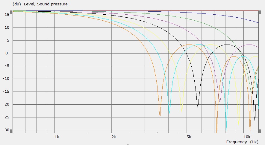

From my own fractal sims you need to cross before the lobing starts or not far past it unless you are willing to go linear phase FIR. I have no interest in building a more than two way active array even as a simulation, a mixture of passive frequency shading and two way active is as far as I would go down that path.crossing steeply (linear phase) at 5 K or above keeps a small segment of the side lobes visible in the vertical plot. most of these exercises so far used a planar tweeter (taller vertical than horizontal) which still need a bit of work.

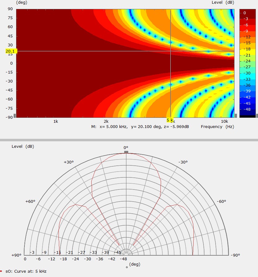

Can you post the polars from vituix array sims on a +90 to -90 scale and limit the frequency to the area of interest to get a better look at the needed directivity vs frequency? On the 360 deg plots the details are lost.

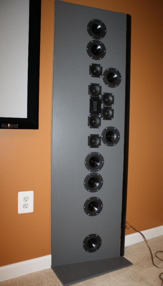

This is the actual speaker where two of the smaller groups have been combined First build: Slim wall speakers. Some startup questions
I think the same or better could be achieved with a frequency shaded line of TC9's with the tweeter in the middle. The shallow cabinet depth for an on wall speaker limits the options for this specific design and is probably why it is not popular.

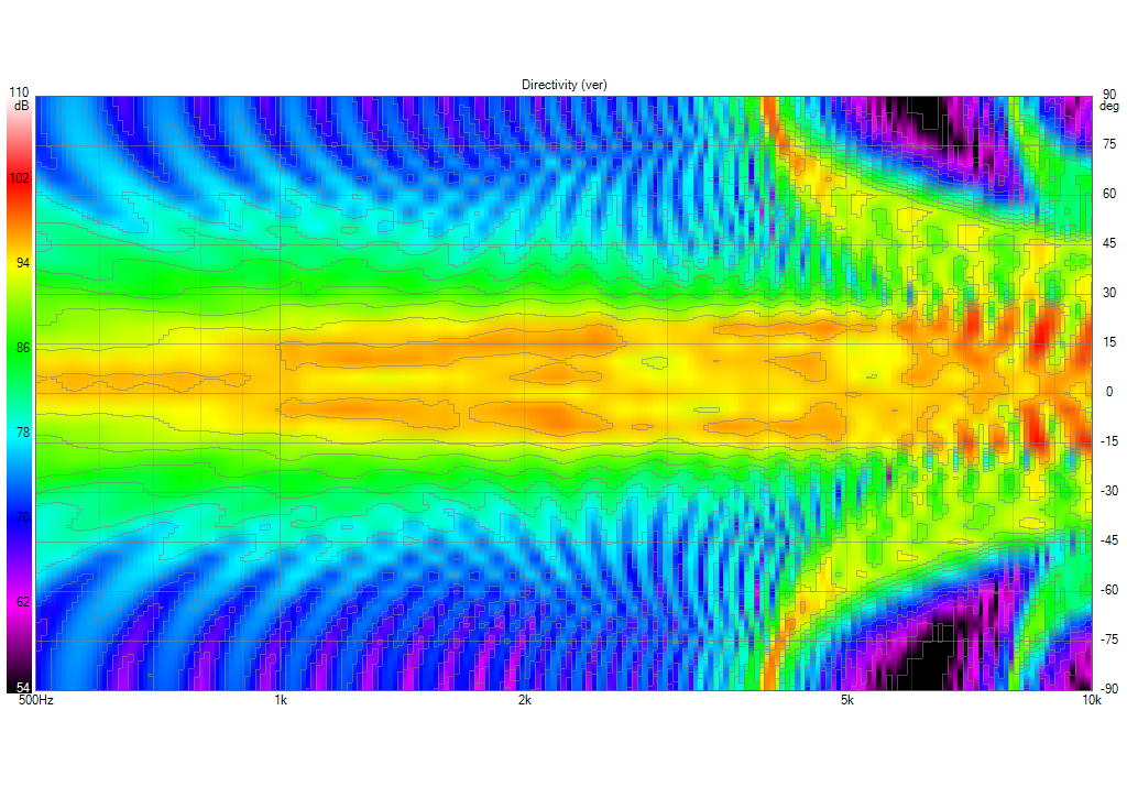

Here's a more detailed vertical plot:
and horizontal:
Which does show these results rock! I.M.H.O.
and horizontal:
Go into the Options and Under Power and DI tick half space which will constrain the polar map to see it better, contours would be helpful to see the -6dB point.
The other chart that is easier to home in on is the polar chart, right click to select it instead of the polar map. Then use the scroll bar at the bottom to move to the frequencies of interest. That should make it clearer where the pattern is for the different frequencies.
I think a ribbon or the like will probably be the better option with a high crossover frequency, the size needed will depend on the pattern required. I imagine it might not have to be that long with a suitable waveguide to help tune it.The thing that worries me about a tweeter is the vertical shape, should we need a waveguide. If there's an option to find a tall ribbon/planar that fits our needs...

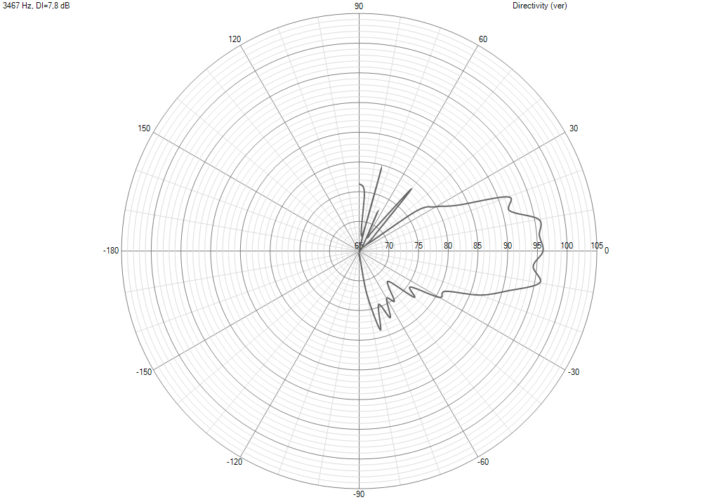

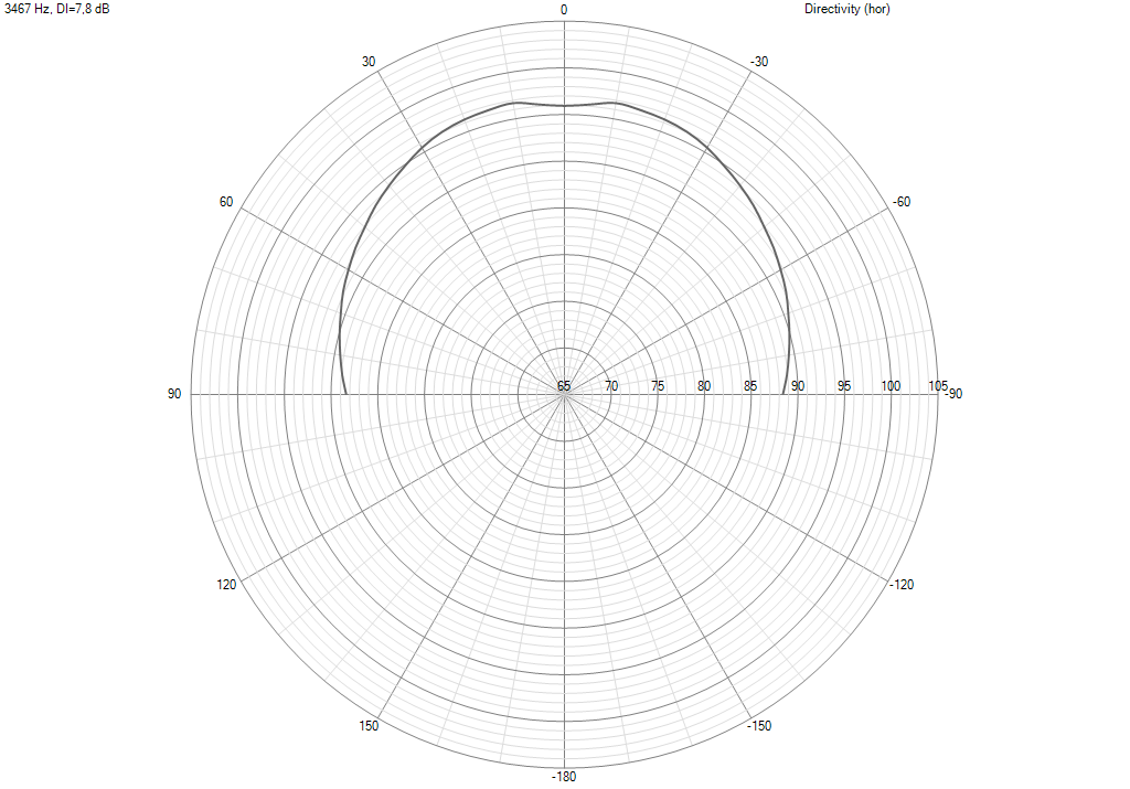

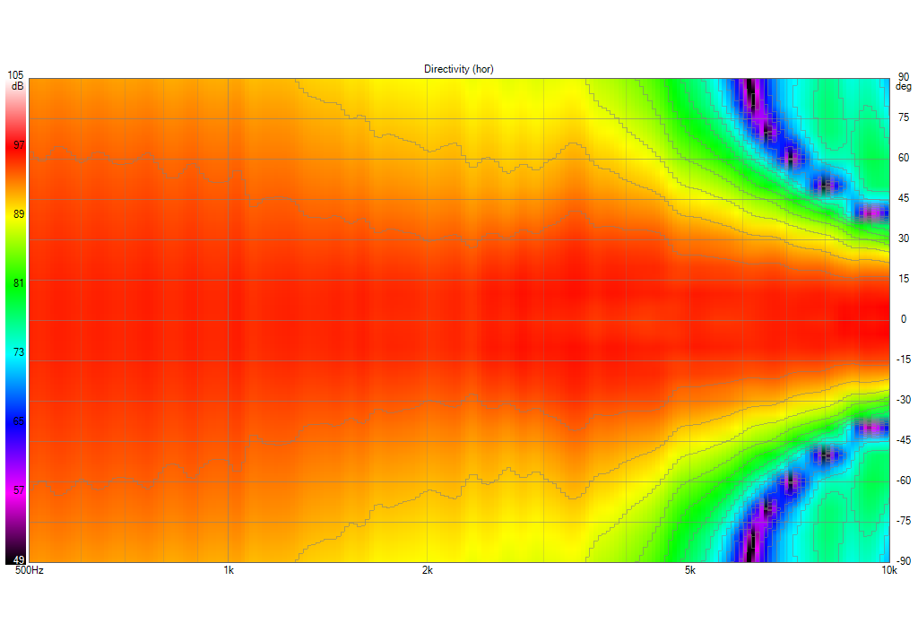

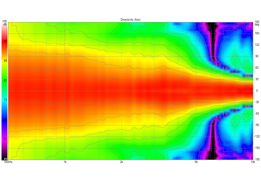

Aiming at the ~3.5 KHz, it would look like this... Charts not normalized
25x TC9 FR Shaded 19.0 as build Directivity (hor-chart).png174.7 KB · Views: 340
25x TC9 FR Shaded 19.0 as build Directivity (hor-polar).png260.7 KB · Views: 332
25x TC9 FR Shaded 19.0 as build Directivity (ver-chart).png176.5 KB · Views: 342
25x TC9 FR Shaded 19.0 as build Directivity (ver-polar).png453.3 KB · Views: 329
A quick comparison, the unshaded vertical polar:
Zooming in:
Zooming in:

The change that was made:
A-A
A-A
A-A
A-A
A-A
B-B
B-B
B-B
B-B
B-B
C-D
C-D
C-C
C-C
C-C --> design axis
D-C
D-C
D-D
D-D
D-D
E-E
E-E
E-E
E-E
E-E
Left is original grouping, 5x5 drivers, left is the re-arranged pattern to optimize seated positions. With a central tweeter, it would depend on the pattern control where to stick it in the line to get optimal behavior over a wide vertical area. What I could have done different is to drop one of the A drivers all the way to the bottom and move the rest up, so I'd have 3 drivers above the central listening axis (group of 5) and 2 below. That would potentially have a better result at standing positions wile retaining all other factors. It would also involve some weird wiring that I wanted to avoid. The basic change I did now was much easier to accomplish. It required way less surgery so to speak.
When adding a central tweeter, basically that tweeter will determine where it needs to go for best performance, the rest of the driver groups would follow.
Meaning: there would be a lot of freedom if one designed it this way from the get/go. For instance wire them in 6 groups of 4 drivers and you'd really have a lot of freedom to go wild. as you could wire the drivers in groups of two above and below the central position etc. Giving the user a lot of freedom in the filters used to shape the beam up to the frequency of interest.
Hope that makes sense.

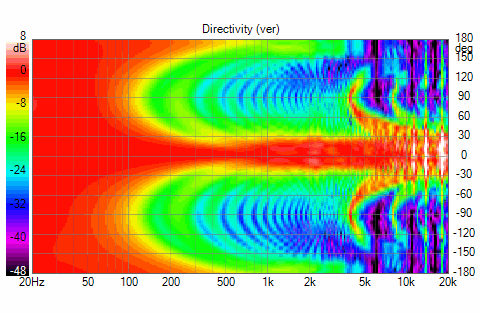

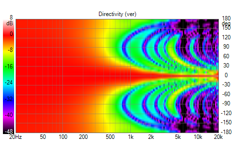

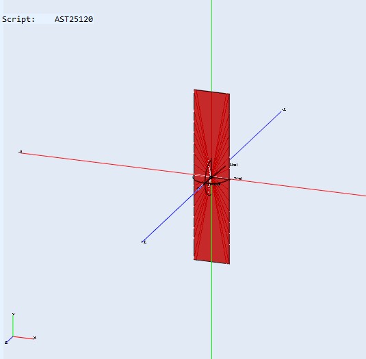

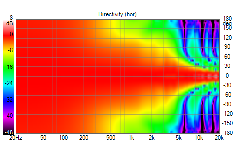

I've made a couple of simulations of ideal rectangular membranes in ABEC, a real driver will not be this well behaved but the important thing is that the directivity will be pretty close. I was too optimistic before about the length needed. It seems like it needs to somewhere around 120mm long to come close. The lower the crossover point the longer the driver needs to be vertically. This has a down side in that the off axis starts to develop more nulls and generally becomes less well behaved. This is kind of what is seen in Crumboo's simulations, the TPL150 gets extremely narrow and directive in the last two octaves.
Polar maps attached below
The horizontal is virtually 180 due to being on an infinite baffle, but could be constrained with a waveguide if this seems like something worth pursuing even if only virtually 🙂
That doesn't come unexpected for me... 🙂
Basically, the top end disturbance results from many times the exact same driver spacing. We may be able to reduce the effect if we would vary the spacing in a straight array?
If we look at the nflawp paper by Mr. Griffin we'd need an even longer tweeter to keep us in the nearfield at ~3M listening distance, but that's another matter.
