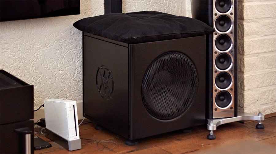

Considered? Yes, but with my specific placement options it wasn't in the cards for me. I was bound to this size and placement.
You mean that your subs are to close to the backwall to have a driver on the back?
A left and right driver would also work.
And if size is the issue you can take 2 smaller drivers that sum to 10 or 12 inch.
Yep, too close to the back wall, but also at a fixed location inside the room, close to the arrays. I don't think it would have been a smart choice.
I've considered many options, including one passive radiator on the inner side. Due to visual preferences and doubts it would work well that too
did not make the cut.

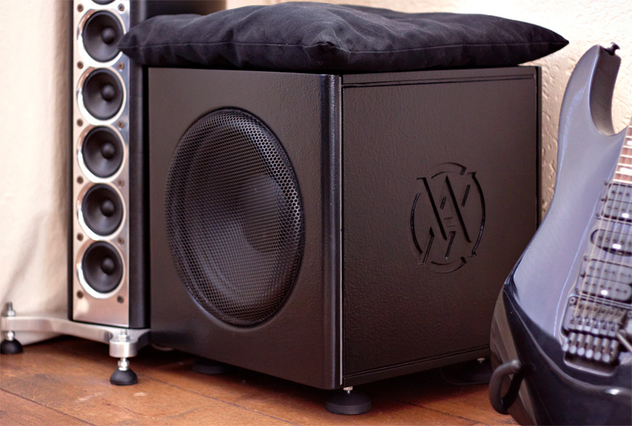

I'm using the Scan Speak 30W/4558T00, in a 40 x 40 x 40 cm cube. So it is 2x 12", even though bigger 12"subs do exist. They replaced the
feet bench that I strategically placed there as place holders:
No other placement options available for me if I want to keep the peace at home. 😉 I deliberately placed those benches there a long long time ago.

I don't think I've ever shown photos of the cat protector on the subs up close, did I? I figured I needed some as build pictures for my vandermill-audio.nl website.
attachment.php
attachment.php
As can be seen, the treatment with soft abrasive pads and wax made the surface much better looking than the earlier paint pictures.
The paint structure was kept and resembles what I did on the arrays.
A soft sheen finish, I think it looks the part.
