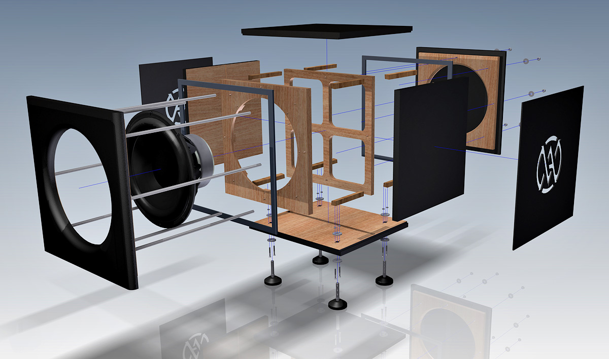

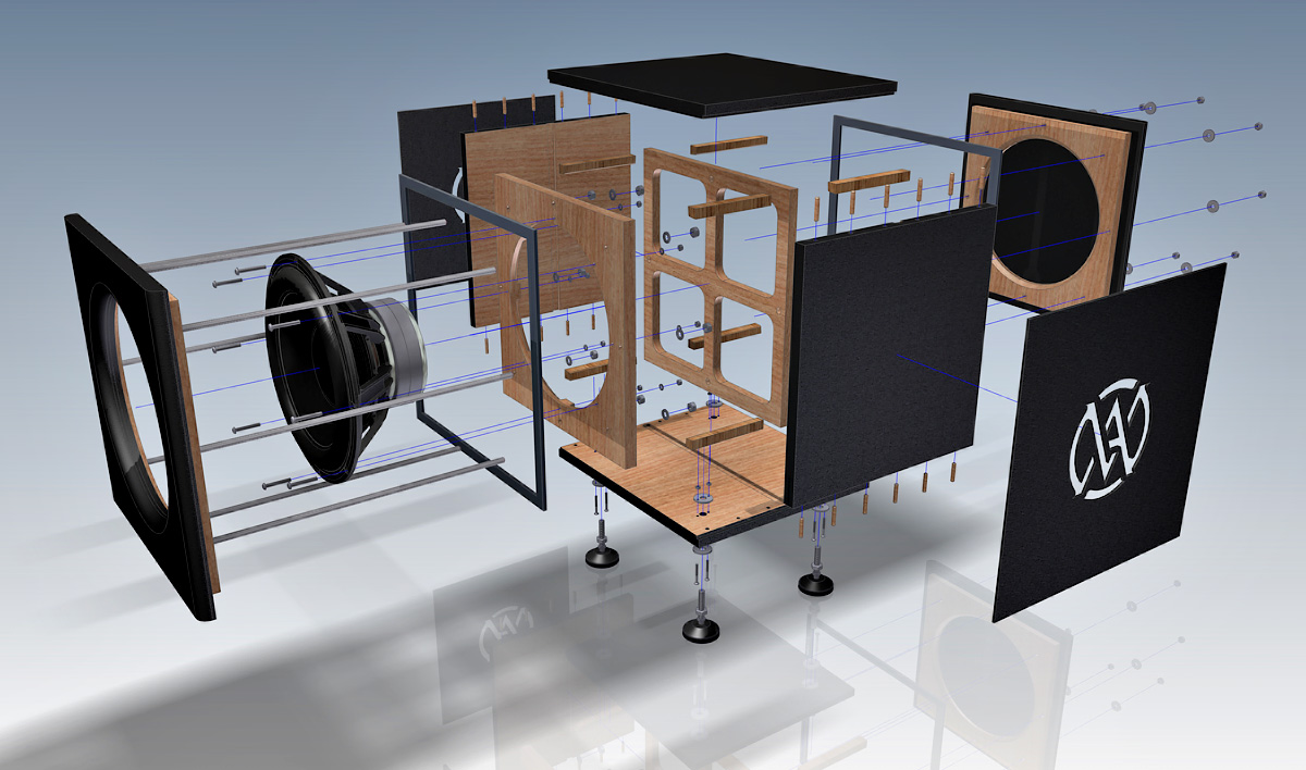

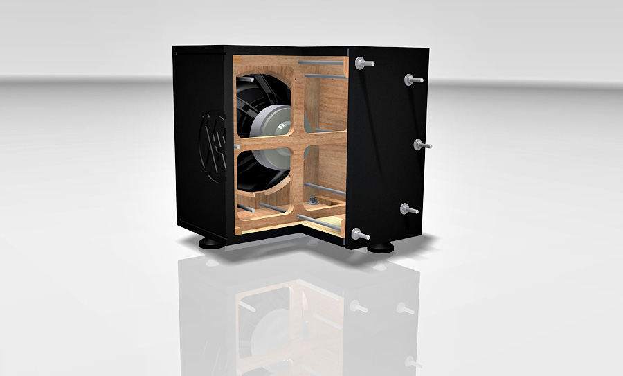

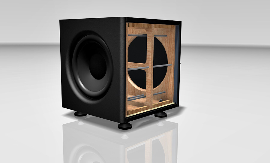

Even though it has been a long road to get there, as life has a funny way to getting in the way of DIY projects, I'm planning to release/publish all the plans I used to build my subwoofers.
I don't know if there is any interest in it, but if there is, the plans will become freely available (for DIY use).
I'm still working to get the 3D model up to date, I will publish all drawings and am considering throwing in the 3D model as a STEP file.

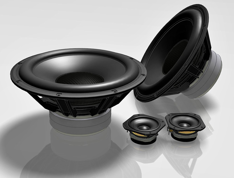

Plans are based on the Scan Speak Discovery 30W/4558T00 woofer.
I'm leaving out the amplifier part, as I used a Hypex NC500MP (OEM), it's the same module as used in the Hypex FA501 1 x 500 Watt FusionAmp.
Likely the 250 watt model would suffice, but personally I like to have some extra headroom.
I used the separate modules because I was planning to use my own version of DSP, however these specific Hypex models are not sold separately.
One could use these plans and description to build their own version of it, using an amplifier of their own choice.
I've build these subs up to a size factor, meaning I had specific dimensions in mind.
Using DSP, with use of processing much like the Linkwitz Transform, I expected them to be able to support my arrays in the lower registers.
They did not disappoint in real life use. Home Theatre viewing has never been more fun without having to worry about the arrays 🙂.

Just having a bit of fun 🙂 but it does give a nice impression of what's in there (not all parts are present though)
Great rendering. Did you have to explode that view manually or did the software do it for you?
Nice indeed!
Have you not considered a dual woofer design that would balance out vibrations?
Considered? Yes, but with my specific placement options it wasn't in the cards for me. I was bound to this size and placement.
