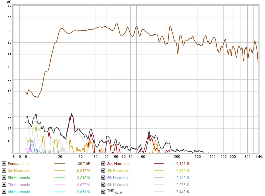

I have measured distortion with the subs and got plenty of those without subs. However I am waiting to upgrade to that pré-amp before I completely redo my DSP to be able to fine tune. I think I have shown a distortion graph somewhere, let me look it up...

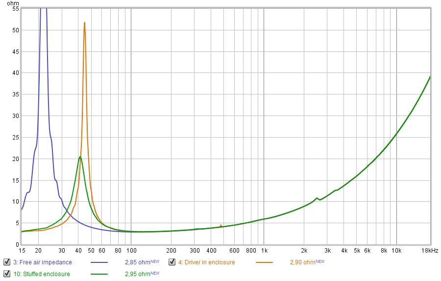

First up: measurement of sub free air, sub inside enclosure and sub with damping material:
803815d1576947674-towers-25-driver-range-line-array-free-enclosure-stuffed-jpg
Even more info here: https://www.diyaudio.com/forums/full-range/242171-towers-25-driver-range-line-array-557.html#post6022916
Next, I did a quick align of subs + arrays:
807225d1578335271-towers-25-driver-range-line-array-subdistortion-jpg
More info here: https://www.diyaudio.com/forums/full-range/242171-towers-25-driver-range-line-array-558.html#post6034599
Basically I EQ-ed the subs flat, made the crossover and some tweaks with RePhase. So I know I can do better. I still need to make a DRC-FIR template for sub duties and do a full session of measurements etc.
These measurements were done while I didn't have the house to myself so I was limited in the amount of sweeps I could do.

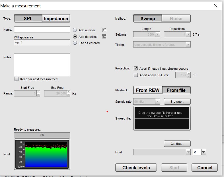

I am sorry to ask this here, but as I know some of you guys are experts in REW and JRiver I thought I would take the liberty to ask this off topic question, if I may.
When trying to use 'loopback' in JRiver with REW and my cheap Behringer UCA202's, which normally work happily for playback and testing with both pieces of software using the ASIO4ALL driver, no matter what I do I can not get the input selector boxes in REW to 'activate'. With REW V5.19 Beta 2 I could at least get the 'check levels' signal to play, which I know is playing back through JRiver, when I select it as an ASIO device, as I can manipulate the signal using JRiver's DSP. However, with REW V5.20 Beta 45 it will not even allow me to play the 'check levels' signal, and immediately comes up with a 'Please select the audio input' notification when attempting to.
I realise that probably none of you have ever tried the Behringer UCA202 with REW or JRiver, but I hoped you might have some thoughts I could try. I have tried all input and output options in both REW and JRiver, but as soon as I select JRiver as an ASIO device in REW the input selection boxes are greyed out. Possibly I am completely misunderstanding how these two pieces of software work together in 'loopback' mode? Thanks.
Simon
The way I do this to avoid needing to use the Jriver loopback is to measure in REW with the from file option, instructions are here down the page
Making Measurements
Basically save a prerecorded sweep, play it back in Jriver and with the acoustic timing measurement REW knows when the sweep is starting.
I found the loopback to have glitches and clicks in my setup, measuring from file works better for me.

Just a couple of questions if I may? When testing do you run both REW and JRiver on the same system? And, do you loop the sweep file in JRiver then press 'start' in the REW measurement window, making all the correct adjustments in REW for taking measurements from a file of course. Thanks again.
I run them on the same computer but you don't have to, you only need to use the same sweep file in Jriver and REW. You could run REW on a laptop and Jriver on another computer.
You start the measurement first in REW and choose the from file option like this
attachment.php
Select the sweep that you are using and press start. The Background window will churn away and it will say waiting for reference or something like that.
You probably will have to move the measurement window over to the right of the screen as it stays on top and will block you selecting the file in Jriver.

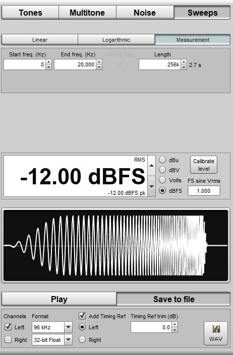

Then play the sweep in Jriver, an acoustic timimg reference is embedded in the file, there will be a chirp before the sweep starts.
To generate the sweep go into the generator and select sweep and the measurement tab you can then tick acoustic reference and select the channel it will be embedded in. Choose the sample rate and other options as you normally would have them set.
attachment.php
