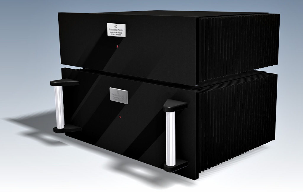

In light with my earlier question about the text on the amp-logo, here's what I had in mind:
Now I know and realize taste is a very personal thing. But this is what I think would look nice in combination with the arrays and subwoofers. I chose not to add handlebars on the ambience amp, as I think it would be a bit much. I like to keep the form follows function philosophy but do not mind a touch of bling (the logo).
Would you understand that I can muck up sizes and shapes like this, however simpe for quite a while to find the balance in it? The second logo is ever so slightly smaller than the one on the bottom amp. The power led is placed slightly different for me to feel it is in balance.
I guess I'm funny like that. 😀 Caring about little details that most will never notice or care for. Unimportant for their function, yet it has to fit my overall view. Call me crazy and you'd probably be right!
In all other aspects, even on the backside this amp is build up like a little brother to it's bigger companion. Heck, it's almost standard and yet I find great satisfaction in worrying about these little details 🙂.
The million dollar look I talked about earlier, not to be taken seriously, but to me? I am building up something I feel good about, very good in fact and that's what counts 😉.
Can anyone relate? Or is it just me, that's this delusional....

Sounds looks and performance improve bit for bit as you say never ending story, love it and makes me happy and where is that like botton .. oh there ...

No not just you 😉Can anyone relate? Or is it just me, that's this delusional....
