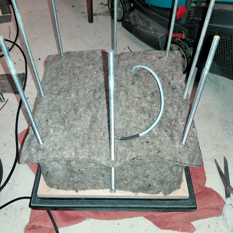

A few days off with lots of family visits etc. Back on track to seal up the second subwoofer. I tried real hard to finish it up today as the next two days it will be much chillier outside. I can't get that out of the garage with my cheap small heater in there.

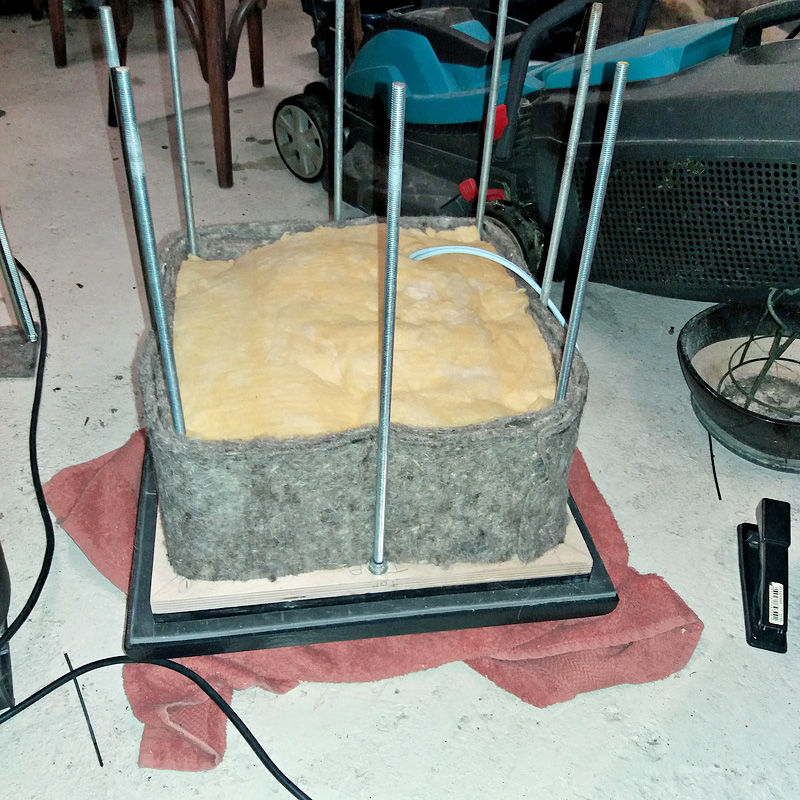

So on with it, stuffing the second subwoofer:
attachment.php

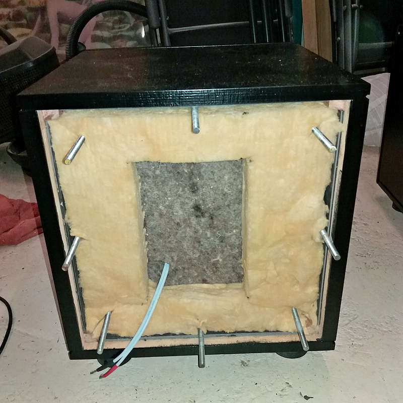

Sealing it up with wool felt:
attachment.php
And fully stuffed, ready to be closed:
attachment.php

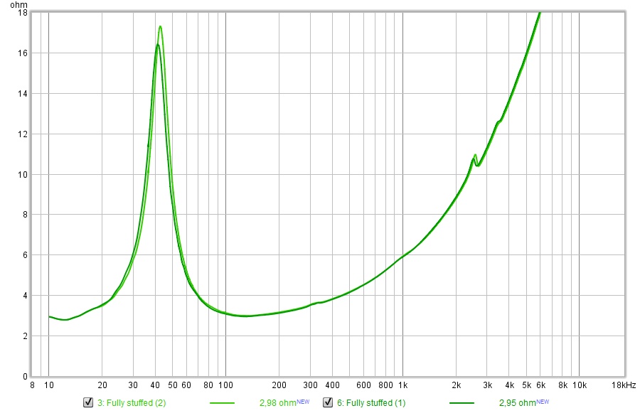

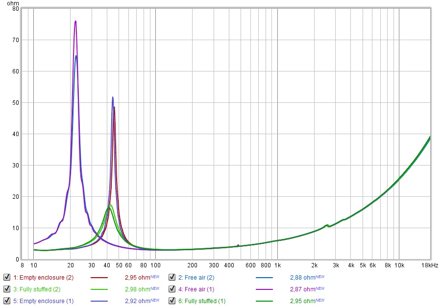

And the measurements, compared to the first:
attachment.php
As can be seen, the curves from both woofers is slightly different. This day the ambient noise was a little lower which also shows in the measurements.
Final curves for both subs:
attachment.php
A few tiny differences within a Hz or so. Driver free air curve is what determines the outcome differences here.
I'll gladly accept that as they will each get their own DSP settings anyway. They both look good to me, nice smooth curves, quite a substantial drop of the resonance peak without a huge difference in overall curves. Ideally both woofers would have been broken in before these measurements, but that would take up valuable time I don't have. The plan still is to close them up in the coming days. I can do the crimping and soldering for the amplifier inside our home, so I do expect them to be finished very soon.

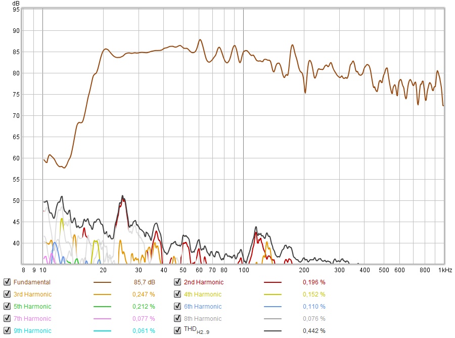

Here's a distortion plot, measured at the listening seat with left + right playing (including subwoofers):
attachment.php
Don't mind that little peak at 50 Hz, as that truly depends on the traffic outside (changes in each plot, clean with a moment of silence outside). This was a last step measurement I made after a long, long session, so I did not have the patience to go for the best graph I could get. I'll revisit the measurements soon enough. Start fresh so to speak. I can definitely work with this material. 🙂

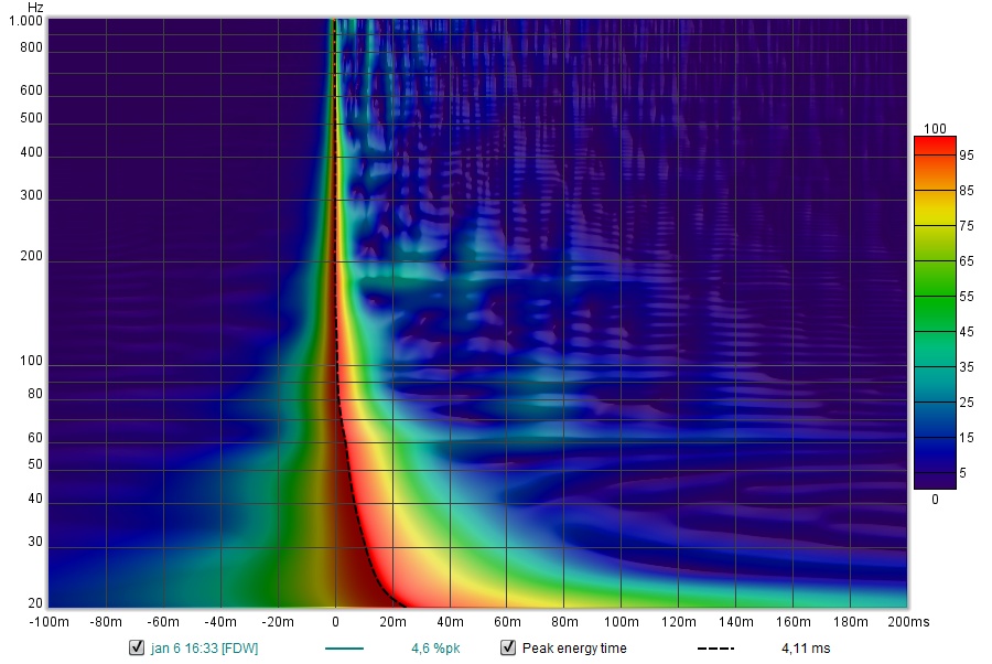

The wavelet belonging to the above graph:
attachment.php
(only looking at frequencies below 1 KHz at this time)

That are very nice distortion figures!
Its hard to get <1% at 20Hz...
Can you also do them at 90/95/100dB?

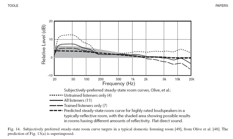

Further more you said that first impression was kind of disappointing.
Can imagine that with a fully flat curve down to 20Hz...
Try a room curve: starting at 80Hz and +8dB at 20Hz..
This is what I use, and I like it very much 🙂

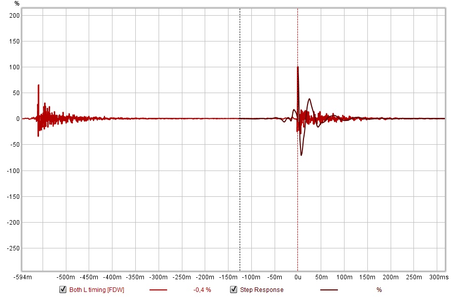

At first I expected to have a hard time to line up the subs and arrays acoustically. It was way more easy than I could imagine. In my rush getting things to work I made a FIR file without looking at the number of tabs. It defaults at 16384, instead of the 65536 tabs I use on the arrays. While playing both a sub (without crossover) and one array (full range) at once (sweep limited to run from 10 Hz to 1 KHz) I got two pulses separated by about ~560 ms. So delaying the sub by that number immediately resulted in a pure 6 dB sum. The sweep sounds funny though 😀.
I've got to remember that little trick, it made it quite easy to align both together to an exact sum.
attachment.php
Aligning both was as simple as reading the exact distance between these two peaks.
Not without upsetting a lot of stuff in my room! I can hear my metal ceiling complaining when I run any higher. 😉 90 dB might still work and I might try that in a next run. The walls/floor, in other words, the room helps me get these numbers. If I were to pull out the sub into the room I doubt it would look this clean reaching the same SPL. I'm not taxing the subs just yet, plenty of room to play with.
[/quote]
I do have a raised output at lower frequencies, but not as much as you suggest. I largely follow the curve Toole published (The dashed Trained Listeners curve):
attachment.php
Now that I have subs, I might actually play with these numbers again to see what I like. The Trained Listeners curve was quite close to what I had evolved towards over a long period of time of adjusting. Nowadays I choose it as the curve to start with. As I've already dialed up the subs somewhat I might like more bass. I do think a lot has to do with average listening SPL.
I stay at about 85 to 87 dB on average but with bass heavy songs it's easy to have my SPL meter go higher 😉.
