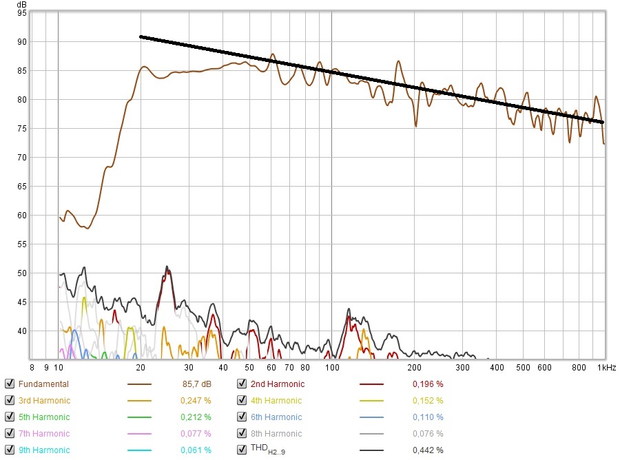

I do have a raised output at lower frequencies, but not as much as you suggest. I largely follow the curve Toole published (The dashed Trained Listeners curve):
807249d1578339220-towers-25-driver-range-line-array-toolecurve-jpg
Now that I have subs, I might actually play with these numbers again to see what I like. The Trained Listeners curve was quite close to what I had evolved towards over a long period of time of adjusting. Nowadays I choose it as the curve to start with. As I've already dialed up the subs somewhat I might like more bass. I do think a lot has to do with average listening SPL.
I stay at about 85 to 87 dB on average but with bass heavy songs it's easy to have my SPL meter go higher 😉.
If you would extend your current FR trend line to below 100Hz it would almost exactly be what I proposed 🙂
I figured as much and probably will try that. I've already dialed in a bit extra sub and made a tweak to round off that graph I posted (small low Q boost at 30 Hz).
That comes close to the part where you feel more than you hear, I've had that but dialed it back some to 'spare' the little drivers in the array. With the 2 Scan Speak 30W woofers I've added 2/3 more volume displacement than the arrays had and with the room gain it provides enough of headroom to get it how I want it. 😉
Sounds good!
Another thing you could try is experimenting with xover freq.
I see a little raised distortion around 120Hz.
Would be interesting to see if this is the sub or the array...
If it is the sub you could go as low as 100 or 80 for xover.
I know I can win something there, but it is a part where I need to see how to get them to 'work together' to get the best results. It is part of why I actually let them (sub and arrays) play together rather than choosing a straight crossover.
It's a bit of both that's causing some disturbance there due to room influences. But I definitely can win some more headroom there. Even if the level looks to be a bit higher, it's still under 1%. I'll try and get it lower, while observing what that does over a wider listening area. No rush though, there's plenty more I want to revisit.
Sounds good!
Yes it does 😀.

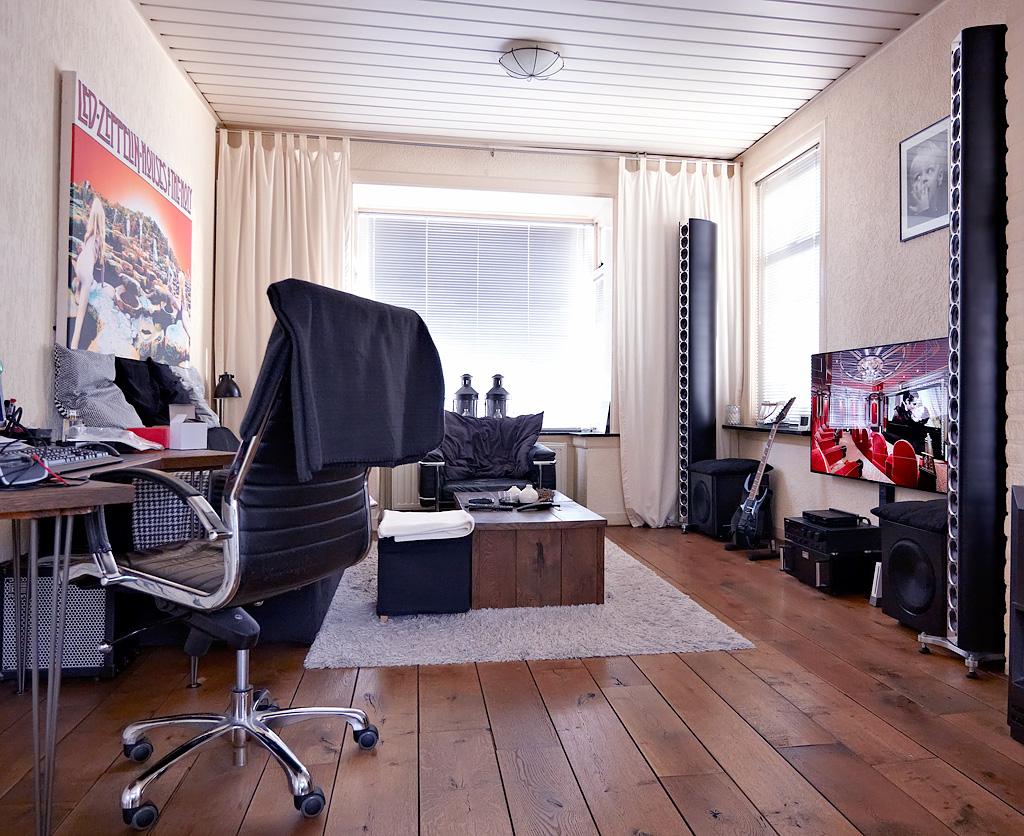

Spend the afternoon to add the subwoofers to my Home Theatre setup. That one is slightly different, where I take advantage of having a discrete center channel that I can dissect and add to my left/right speakers myself.
Here, adding a shuffler makes a lot of sense (and a positive difference). So the center DSP is quite different than in my Stereo setup. I don't have an actual center channel, but with the shuffler in place you'd be hard pressed to hear it isn't there!
I've actually tried using the same setting in a Stereo setup, but due to the center not being a discrete channel (it's a Left + Right sum that always includes some left and right channel info) it just doesn't work as well as it does in Home Theatre.
Setting it all up took some time but it works like a charm. Quite impressive!
For the voices panned across the center I often use the movie "Rango". There each voice is placed exactly where it is on screen, not a classic center panned voice for all. The shuffler does a marvelous job of making it all sound more intelligible and have a good and equal tonal balance across the stage. I've used the Spears & Munsil Blu-ray to do the SPL levels within the 5.1 audio setup, checking levels etc. This gives us a pleasant "movie" sound setup that works across the couch. The bigger screen does help, as in the past it was easy to have the sound much much wider than the screen. Even though we're sitting off center with the TV, adjusting it to our liking is simple once everything is dialed in correctly.
