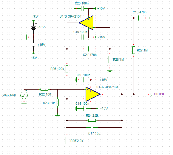

Shute, that didn't take long. Inserted the Atom with 6 dB gain, reduced internal level within JRiver with 6 dB. Boom. I prefer it with the Atom.
I should insert the Atom with no gain to be precise, only using it as a line driver, but I had marked the 6 dB level so this was easier.

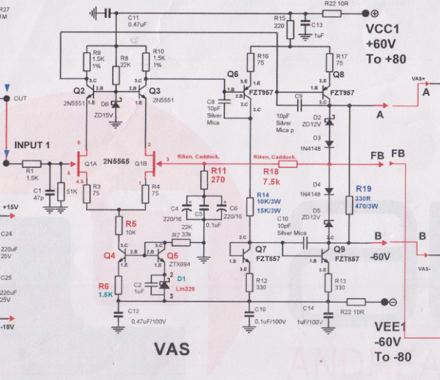

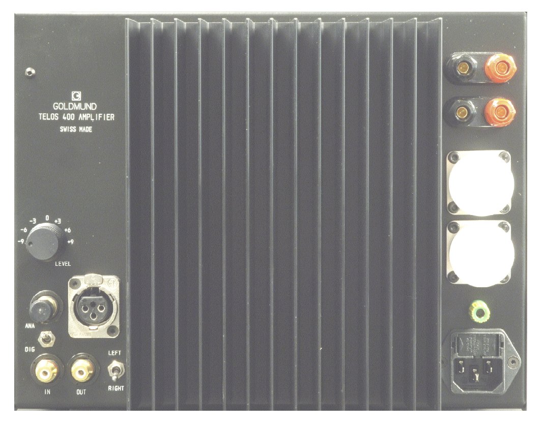

Comments are based from looking primarly at the Telos 400 wayback sheet, which shows an input sensitivity of 1.45 V, with > 10dB of attenuation available.
Also see under Rear panel Connectors and Controls that the unit had an input attenuator: 7 x 3dB steps. Along with balanced inputs.
The adjustable attenuation is nice, when using pro level line gear.
Is there any chance your clone has some adjustable attenuation applied?
Probably not, but if so, yay ! Get rid of it !
If not, here's the best-bet problem possibility i think..
The Telos 400 spec sheet no doubt includes the built-in pre-amp, which you say the clone doesn't have.
My pure guess says the pre-amp has to have at least 3 dB of gain, or why bother with it at all.
3dB of missing gain would raise input sensitivity voltage to 2.05V (1.45V x 1.414) Now it's beginning to get marginal.
But the pre-amp having just 3dB gain is doubtful, probably at least 6dB gain, which would take sens to 2.9V. (1.45V x 2)
Definitely marginal at best for use with a consumer DAC.

You're thinking is similar to mine. The back side of the real deal has that dial making gain adjustable from -9 to +9 dB.
If koldby is sure about the 26 dB gain, the total gain as factory has put it on the spec sheet is 29 dB. So that would make the pré-amp section 3 dB gain.

The way I look at it, I'm thinking of getting a pré-am with fixed 6 dB gain (Universal Buffer from tomchr, Neurochrome). Or I could fit a volume pot to it making it adjustable.

Seeing the backside of the Telos 400, it would make sense to me if the pré-section is the 9 dB that is adjustable in steps? In that case overall gain would only be 20 dB. 😕

since the back panel level control spans 18 dB, it seems to me it has to be attenuating the combined pre-amp and amp gain.....unless the pre-amp has a full 18dB gain by itself.
you know, just for certainty's sake, and maybe for better knowing what pre-amp gain you want....i'd stop and measure the amp gain...
it's easy with nothing more than a half decent voltmeter.
use an AC line freq sine wave, 50 or 60Hz, or any freq if you have a super true rms voltmeter
Measure the output of whatever is feeding the amp input, disconnected from the amp. Dial in a voltage around .5 to 1V.
Then reconnect the amp, and measure the amps' output, without any load.

Looking the other direction from load to source, below circuit is the PRE that is omitted (modelled in TI TINA, btw gain is +6dB, -3dB point at 4,3mHz, and DC servo feature handle up to +150/-160mV offset on input) and wired directly to "INPUT 1" of above VAS stage, its a zero impedance source and my bet is VAS stage operating point and ballance will tilt a bit not seeing a 100% stable zero impedance source but instead will have to look through a non stiff 10-15 meter cable before it can see 47Ω of M1.
Another never ending story and of course critic or input is welcome but hope i'm not way off in above analyze find a good objective reason why a PRE here makes a difference for sensitive ears, know 47Ω plus some cable is relative low but actual its huge if VAS stage was designed to see a zero Ω stiff impedance as source. If it holds water imagine best thing wesayso can do if he get universal buffer boards from Tom is build it into Telos Clone and then its win win situation change output on M1 DAC from RCA to its native XLR and run ballanced cable to new ballanced input buffer in Telos clone.
From the schematic we have a feedback resistor : 7,5 KOhms and a resistor to ground 270 Ohms.The gain is : (7500/270) = 27,78 times.
In dB this is 20xlog(27,78) = 28,8 dB.
The reason it is a little higher than normal is that the normal input voltage for poweramps to have full power output is 2 Volts and as the Goldmund is a 350 Watt amp it has to have more gain to achieve that than a 100 Watt amp.
The input stage of the original Telos has no gain. R feedback is 2k2 and the R to ground is also 2K2. It is only a buffer that drives the attenautor between this input buffer and the power stage.
I really think your conclusions are wrong. One thing is that it is not the VAS stage that is the input of the Telos clone . The VAS stage is the FTZ transistors whereas the DIFF (diferential) stage is the double fet 2N5556. This is a standard input stage (refined by Goldmund, I will return to this later) and is seen in 90% of all poweramps without any input buffer.Hi guys see some discussions on gain and ability to drive long cables is blamed why wesayso sensed a difference at our meeting, may i mix me up in discusion 🙂 now i hope i remember everything right and my speculation for how koldby ended trim Telos clone is spot on, else give me a size 45 in my back end 😛.

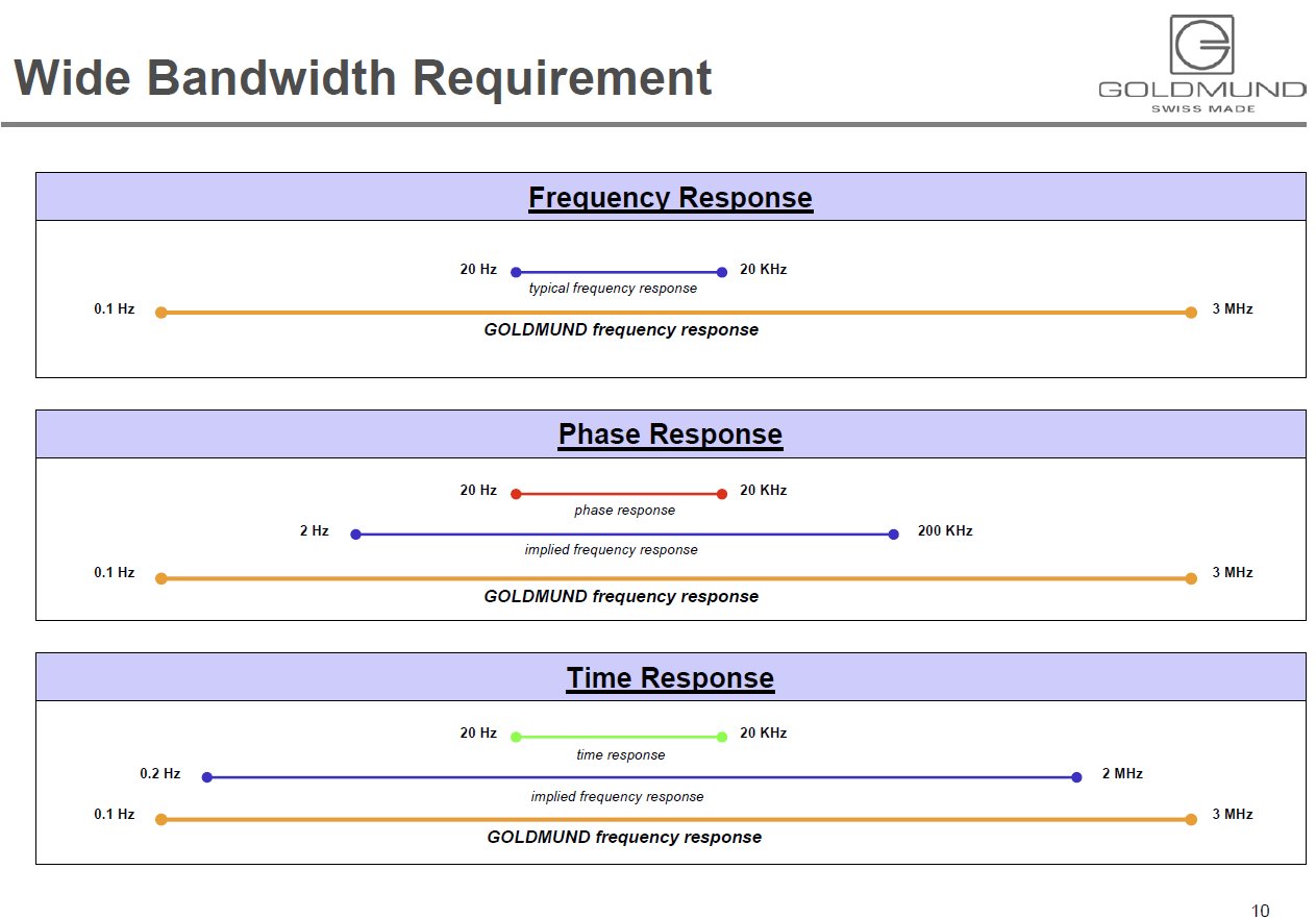

And I think I have heard the full potential of the Goldmund chez moi, as I have no problems with driving cables from my preamp. The difference between the three first amps was exactly what I expected. What puzzeled me was that the last candidate underperformed . But I think it was partly because Wesayso are compensating his Line Arrays all the way down and mine are attenuated under 35 Hz or so. This could lead to the last candidate, beeing the least powerfull of the three, would struggle more . I am not at all sure that this was the case as it was also noticeable in more quite passages. I am still puzzled.
