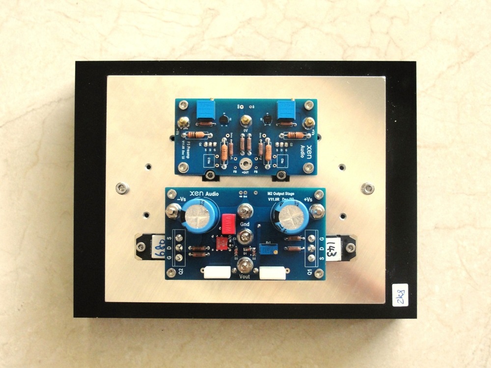

A quick update to reply #17.
Patrick
I built a channel and hooked up a light bulb tester. As expected it glowed brightly then dimmed as caps charged up but then after a few seconds it started to glow again, which I had read was not good (at least in the case of the F5). I noticed the DMM's on the 0R62 bias resistors showed 0.4V. Does this have something to do with the 4N26 (Q5)? Is something seriously wrong or can I proceed?
Something is obviously not right.
All optocouplers (including the 4N26 and the 4N35) have an LED which is ~1.2V forward bias.
Which corresponds to the voltage across the two resistors combined.
It is not different from the original M2 output stage.
Any changes are just fine tuning.
Patrick
Normally there should not be much current through those hundred-ohm resistors.
This is because the phototransistor on the optocoupler output side does not have much current to pass.
When it works properly, and there are many examples of such, the bias should be ~1.2A.
Across 2x 0R62 gives ~1.4V.
This equals to LED Vf + voltage drop across the 3x resistors in series with the LED.
If the output stage is under-biased (645mA), the light bulb should not light up, not ?
Patrick
Reactions: jcon2
I think it is normal for the DBT to glow bright, then dim once power supply caps are charged, then glow again, less brightly, as C3 charges up and current flows in the output stage. I don't think this necessarily indicates a problem.
This question comes up from time to time on the M2X thread and has been addressed there several times.
