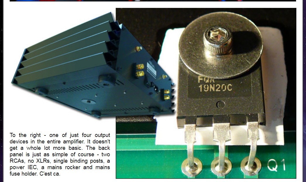

This one perhaps ?
At least does not look like IRFP.

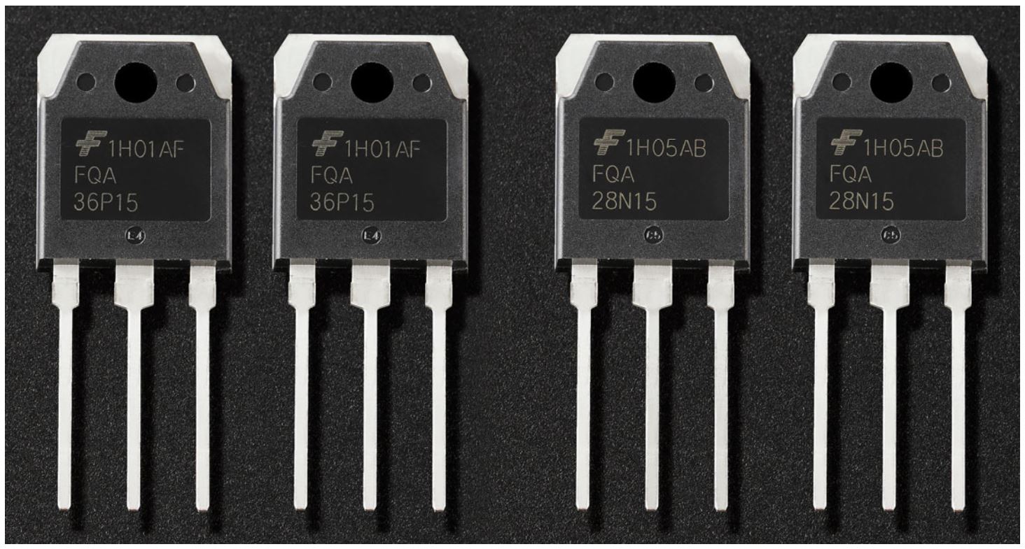

Visit the link presented in post #142 above. Slide your browser's vertical scroll bar all the way down to the bottom, then slide it up 33% of the distance to the top. Presto, now you see this:
_

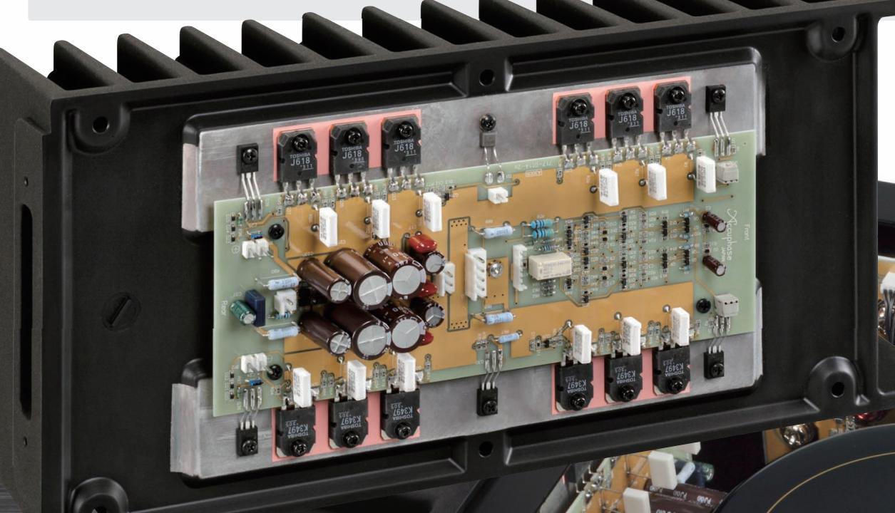

Because Accuphase was mentioned, from the a-48_technical_information.pdf :
"The output impedance is decreased by 6 parallel push-pull
final stage arrangement of MOS-FETs.
Circuit configuration of the power amplifier engine is as same
as Class-A Stereo Power amplifier A-75.
A-48 features the new power MOS-FET device which is
heavy-duty and has the large rated current characteristic.
**Current capacity of power MOS-FET
A-47’s MOS-FET(Toshiba): 10A
A-48’s MOS-FET(Fairchild): 33A"

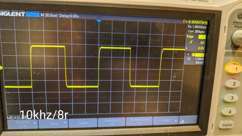

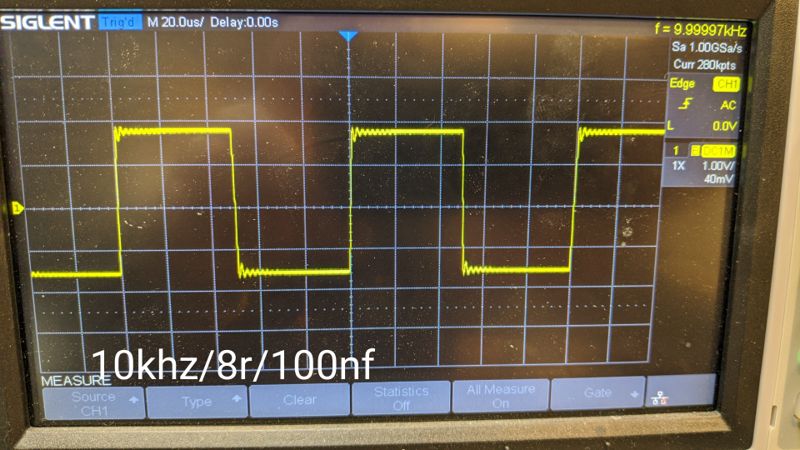

I ran some preliminary tests on my M2OPS build. I had been running this at +/-28V from a pair of SMPS300re in my test chassis for quite a while. So I took it out to the workshop and hooked it up to the bench supply putting out +/-12V - one lab supply for each channel as my supplies arelimited to 2A per rail.
I'm seeing 1.05A per rail draw, which is a bit lower than with 28V - EUVL will pop along to explain why - I didn't do any adjustments in changing the supply, literally just pulled the connectors from the SMPS and connected to the lab supplies. DC offset was similar to 28V - it starts at maybe 100mV or so, and drops as it all heats up. With 12V this was still dropping but slower as the bias was lower. I reckon if bias was the same, offset wouldn't even need to be adjusted.
Square waves at 10kHz attached below - there is a little more ringing with the capacitive load at 12V compared to 28V.
Subjectively, just on workshop speakers, laptop playing youtube music, sound signature is the same, very clean, nothing audibly wrong. Pretty amazing really.

The slight increasing in capacitive load ringing is also due to reduced Vds, which increases MSFET capacitances.
But it is really not much ringing with an unrealistic capacitive load.
