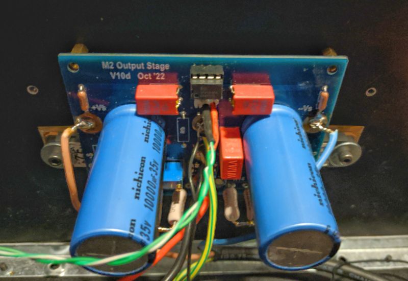

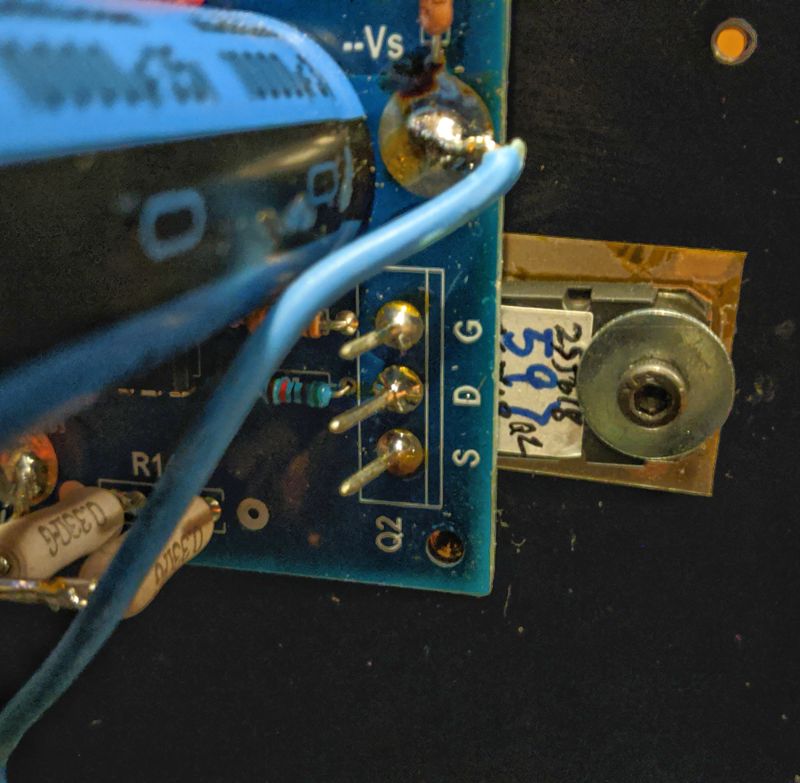

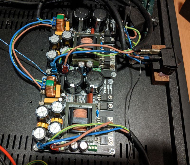

I have been using and enjoying a build of the M2OPS over the last few months. I have this installed in a test chassis (modushop 5U 300mm deep) and somewhat unusually I have it powered from a pair of SMPS300re putting out 28V. The opamps (OP551) can use up to 30V, so this is safe to use, although the supply voltage is high compared to the normal recommendation for the mosfets (24V). It’s what I have to hand and ready to go. Some discussion happened though on what mosfets could be better in this amp (I have been using the widely available IRFP240/9240 pairing) – and I obtained a set of 2SK3497/2SJ618 from @EUVL that came from the same batch that @twitchie used in measurements https://www.diyaudio.com/community/threads/the-m2-output-stage-in-class-a-b-and-maybe-a-power-whammy.390636/post-7206502
When I first built this amp (which is a relatively simple to build and set up amp) I tested out different feedback configurations, and have left it for an extended period using mixed feedback. I think this gives the best of both worlds, but of course, you can try it and see what you prefer yourself. My comments on early listening impressions are at https://www.diyaudio.com/community/...ybe-a-power-whammy.390636/page-4#post-7179607 and ultimately I settled on mixed feedback https://www.diyaudio.com/community/...ybe-a-power-whammy.390636/page-5#post-7189861
It is not possible to get as close as I’d like to an AB comparison – changing the mosfets takes some time, and I don’t have a duplicate system to allow for hot swapping. However, I had lived with the M2OPS with IRFP240/9240 for a good period, so my reasoning is that change should be pretty apparent.
Changing over the mosfets was easy – once you can remove the mosfets without damaging the board. There are no other changes to be made. It is always a good idea to check for shorts etc, before powering up, and maybe even using a lab supply with current limiting/dim bulb tester. This is tricky with SMPS as they often don’t start properly with dim bulb testers. Anyway, power up was uneventful. It is likely that the DC offset will need to be trimmed, just as if you were setting up the amp for the first time, and again that was easily done.
So then the big reveal – did the 2SK3497/2SJ618 pairing sound different? The answer is yes – but not only that it sounded different, in particular that it was easier to hear more small details. I was genuinely surprised at that, because I would have said that the amp was very good at detail already. I would say that the change is not quite as distinct as changing to mixed feedback, but it is definitely there. Adding to this, and maybe this is also part of why I could hear more detail is the soundstage was deeper front to back. Bear in mind the Quad 57s I use are really excellent at soundstage, so maybe this would not be as noticeable with other speaker systems. The extra detail should stand out though. I don’t have systems to carry out noise measurements, nor distortion measurements, so these are very subjective opinions. However, @twitchie did carry out measurements here https://www.diyaudio.com/community/...ybe-a-power-whammy.390636/page-3#post-7172450
The summary is – build the amp first with IRFP240/9240 if you have those to hand, and when you have it setup, you like it, and want to finalise your build, swap in a set of 2SK3497/2SJ618 and you will be set.

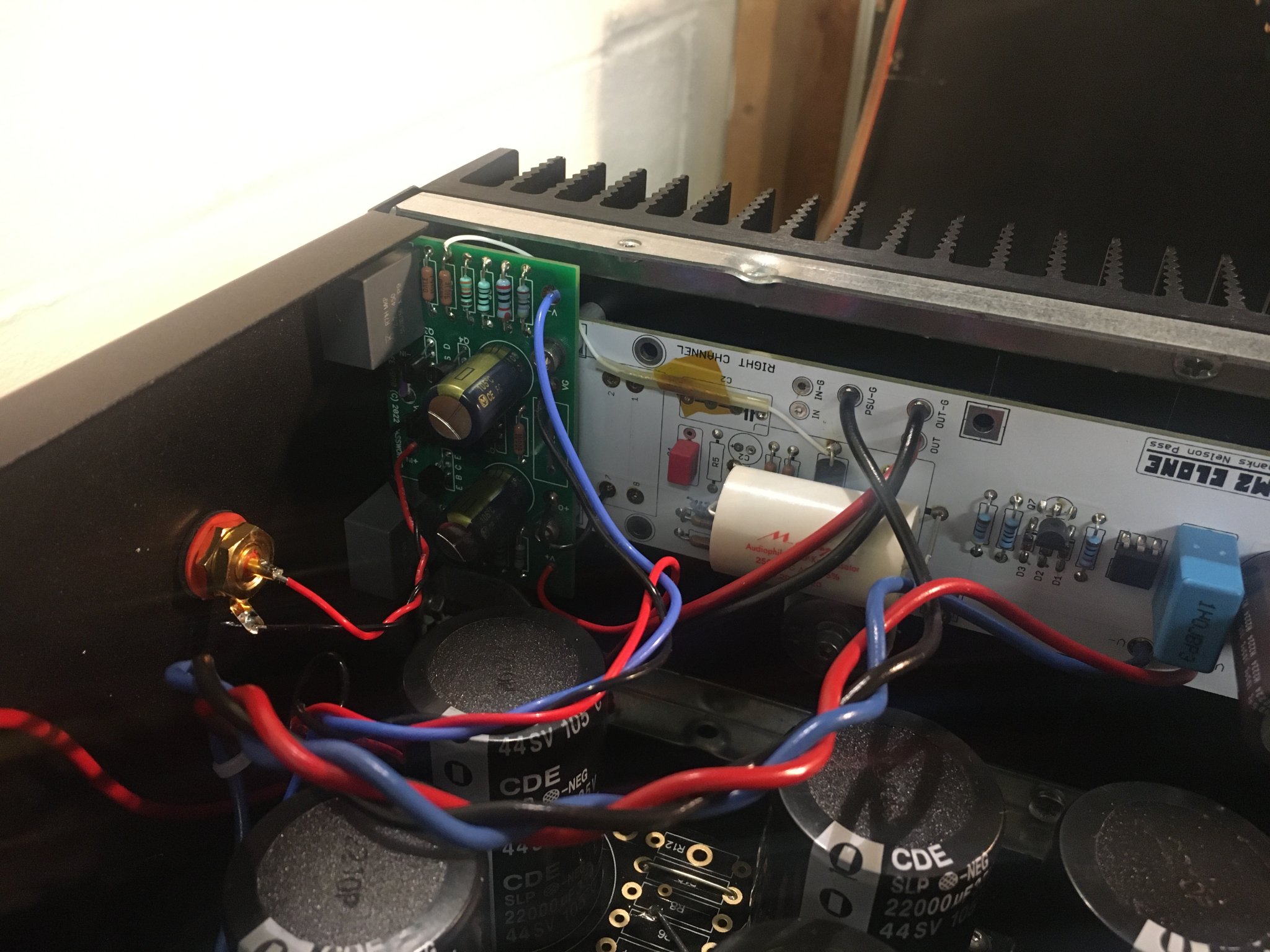

Hope this isn't totally out of place in this thread. I've put together a M2 OPS with a different front end with some inspiration from this thread. I'm using Tea Bag's M2 clone boards and a 2022 FE board from the store. I listened to the setup initially with local feedback around the front end, and then with nested feedback with about 18dB white wired from the outputs, for about 20dB gain overall. With the mixed feedback, the sound is the best I've gotten from this amp by far. So, another data point for the nested feedback configuration.
Thanks for posting the 2022 FE Spice file, Patrick.
Reactions: Vix
I agree that the F5 pre FE looks intriguing as well and I'm looking forward to more details when they become available. The advantages for me ATM with the 2022 FE are a) board availability (which was good in the short window they were available in the store), and b) mounting hole pattern, which is very convenient for piggybacking on the Tea-Bag board. And of course, it is also a NP design.
I'm currently still using the J113s that came with the board, so I can look forward to evaluating K170s. I'm also intrigued by the Toshiba output FET possibilities as I'm currently using the Vishay IRFP240, Harris IRFP9141 combo there. But first, I will live with this for a while.
