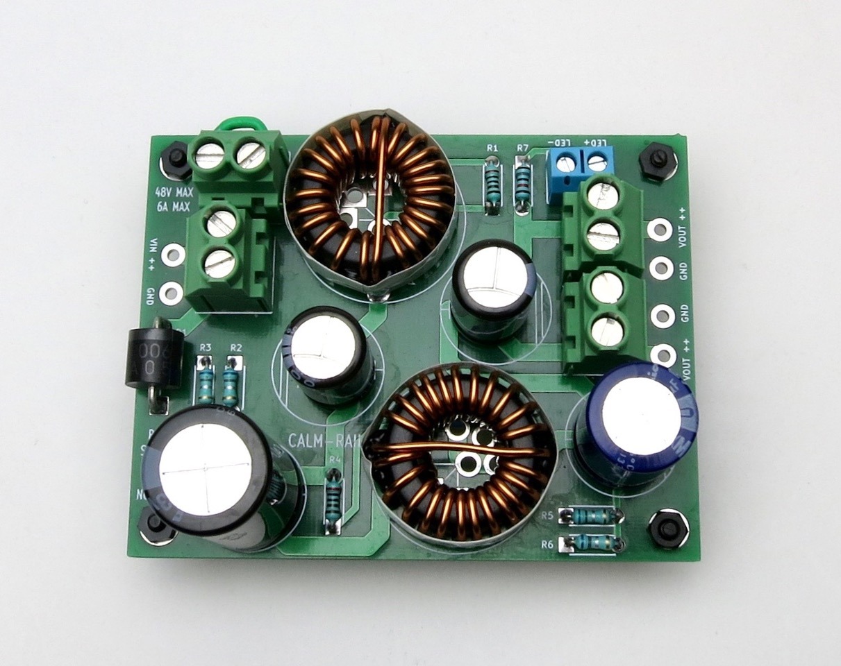

Inductors rated for >5 amperes are available at relatively low cost, with inductance values high enough to provide quite a bit of attenuation at SMPS frequencies (40 kHz - 5 MHz). Always remember that inductors have self capacitance, and capacitors have self inductance, so you're managing RLC resonances whether you like it or not. A little damping, applied skillfully, can mitigate this.
For a medium-low current application (3 amperes or less), I built such a filter, and it's in the diyAudio Store now. In that circuit, the Equivalent Series Resistance of the capacitor(s) was important, so I hunted for low ESR caps that would fit the existing PCB. Here is some of my early data .
Naturally you could build a cascade if you wished; LCLC to eliminate HF noise, followed by CapMul to eliminate 2 x Fmains noise. Yes, switch mode power supplies really do produce 100 Hz noise; Mean Well even includes scope photos of it in their Test Reports.
edit- adding a photo of an early prototype, higher current LCLC filter.

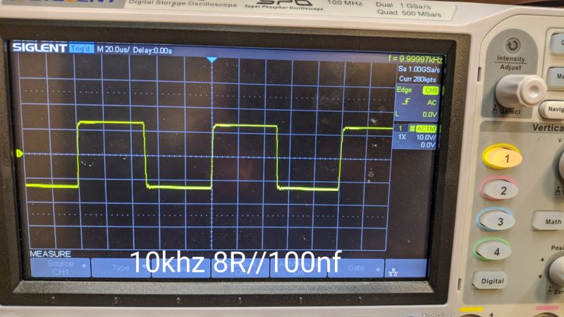

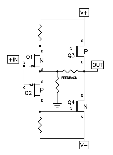

So while most alpha testers prefer the opamp local feedback, it does have some drawbacks.
Namely a relatively high output impedance, from ~ 0.4R in Class A, rising to ~ 0.8R in Class B.
This means less control and more distortion when driven heavily.
A way round this is of coure to apply a controlled amount of global feedback instead.
This can be easily implemented in the current setup.
See attached description.
One alpha tester returned a positive feedback :
"Mixed feedback installed tonight. Scope shot below 10khz into reactive 8r load.
Exceptionally clean looking square wave (10V per division), so a sizeable enough output as well.
Initial impression is that the sound has shifted noticeably, and its has a more punchy sound, more impact (a good thing)."
And of course you can vary the amount of feedback to you taste, by changing only one resistor. 🙂
Patrick

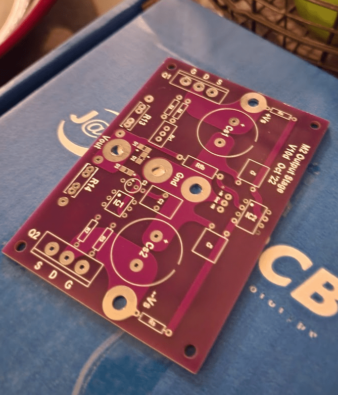

Boards have arrived. I should have checked my mosfet stash sooner as I thought I had N/P matched pairs but it turns out that I have many quads of 9140 but no clearly matched N-P pairs - so some matching to be done before I start soldering and sorting out what configuration sounds best for me.
thanks for the opportunity to explore Patrick.

First time I see it in purple. Looks quite nice actually.
If the pads are gold plated, you might want to apply solder to all those pads you want to solder later on.
Then suck all that solder away to remove the dissolved gold, which when mixed with solder will cause embrittlement long term.
This is why we always use pre-tinned PCBs and not gold plated, not to save costs.
Unless you need the gold plate for dry contacts.
https://www.diyaudio.com/community/...reamp-with-output-buffers.384796/post-7064891
But then you need to plate hard gold, which very few shops will do.
And they will charge a fortune.
Patrick
I've listened more tonight, and to these ears, the mixed feedback is a good step up from local feedback (which I preferred to global). Setup was easy as per the PDF linked above and offset did not change - still at a few mV when warmed up fully.
The thing about the sound I noticed first was that it was more punchy, with vocals projected more, and a deeper soundstage. I really think its an improvement and it was no slouch before this.
As Patrick says, try it global, local and then mixed and see which you prefer. All you need to go from local to mixed is one resistor.
