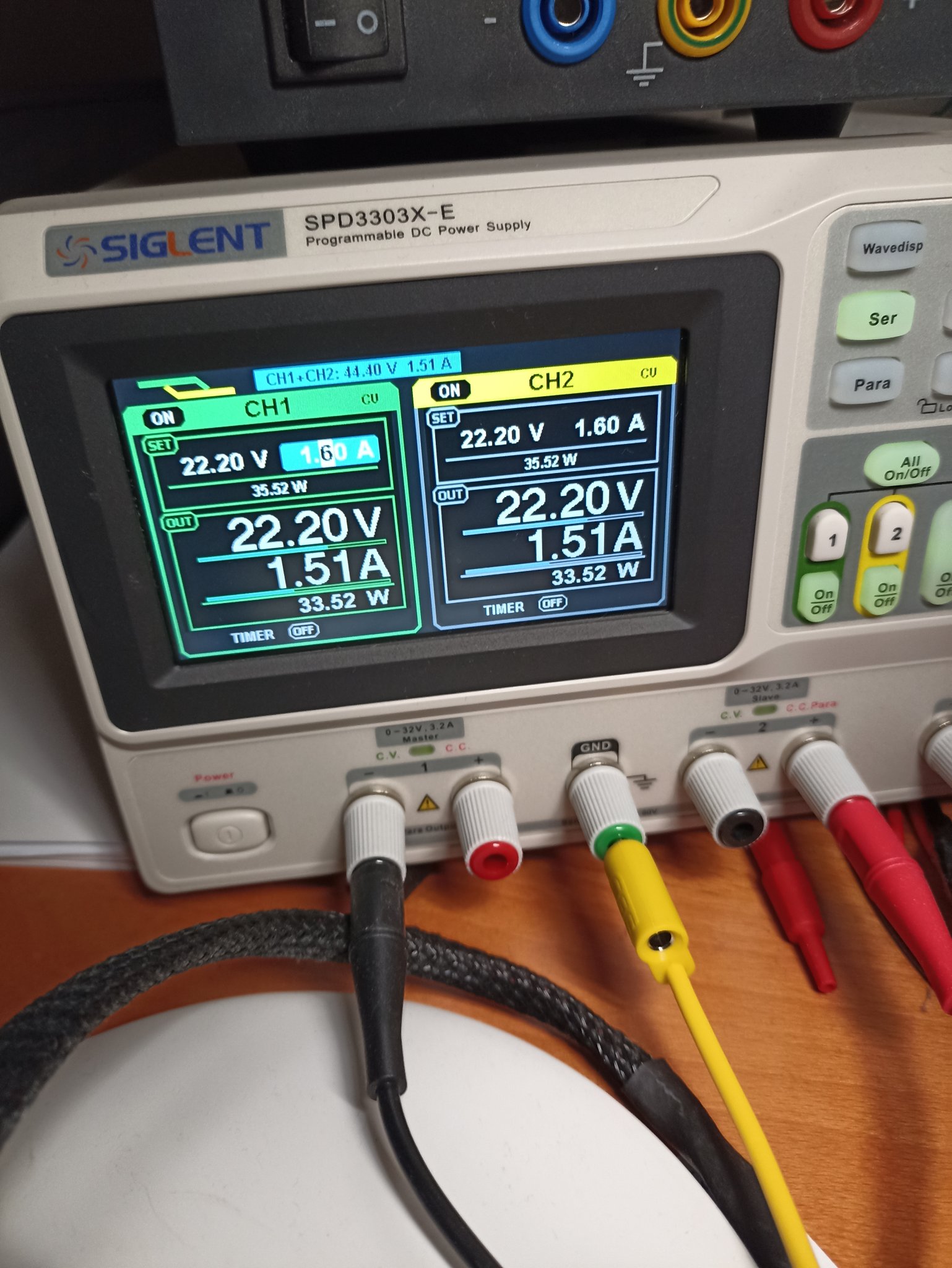

For long term reliability, I would not go beyond 36W for each TO3P.
I know you are still using 22V 1.5A, which is fine.
Just in case you want to go higher rails.
We use 0R62 for the source resistors, if I remember correctly.
It depends on the actual VF of the optocoupler.
Patrick
