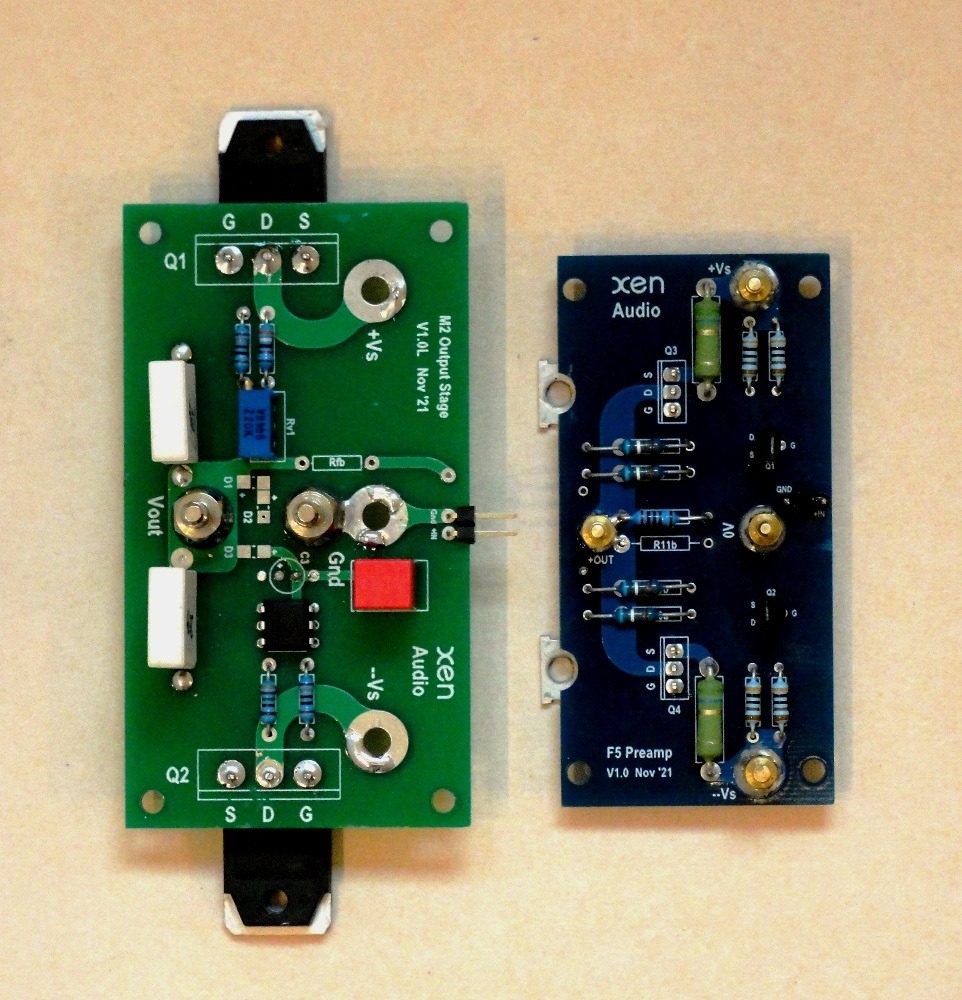

There is a new version of the M2OPS designed to go together with the F5Preamp, NOT with an opamp as published.
The F5Pi project is not yet ready for publication, waiting final integration and independent audition.
So for now you can use the Gerber as published here and use by all others.
I have no knowledge and therefore comments about any M2/M2X PCBs that exist.

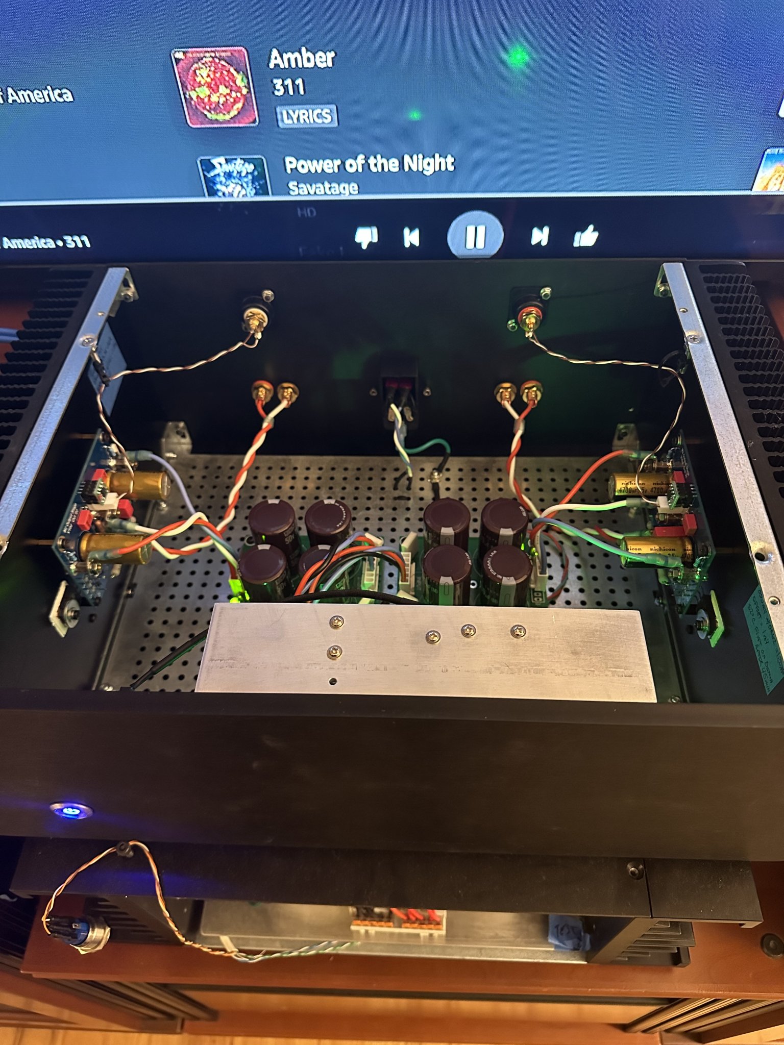

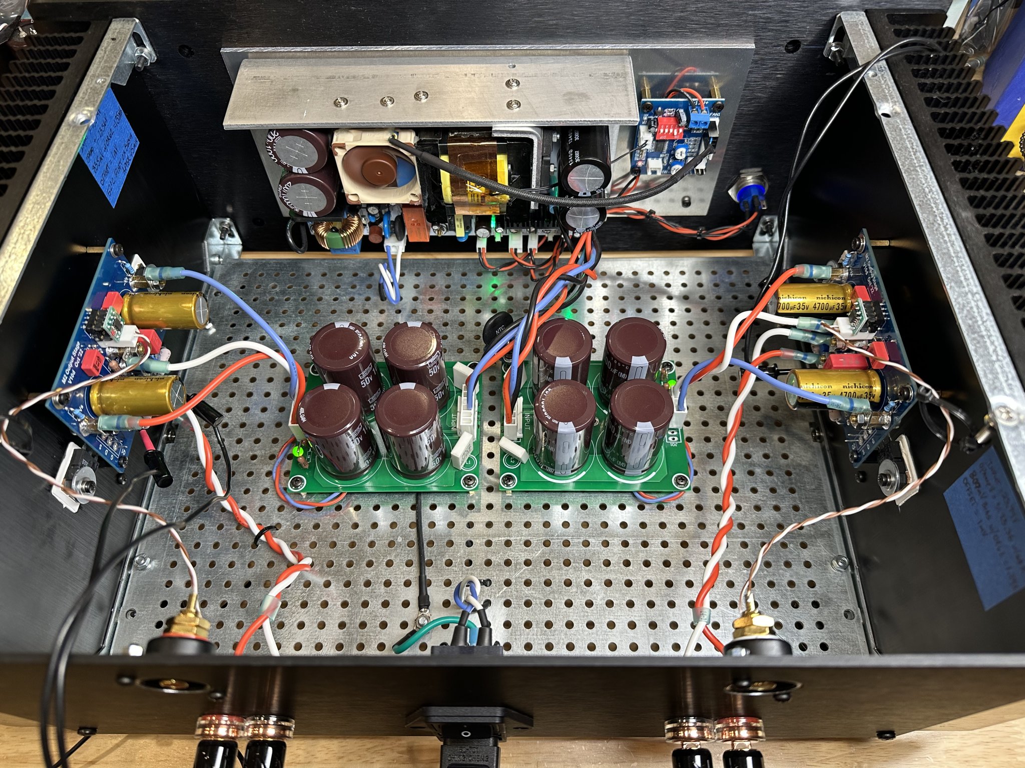

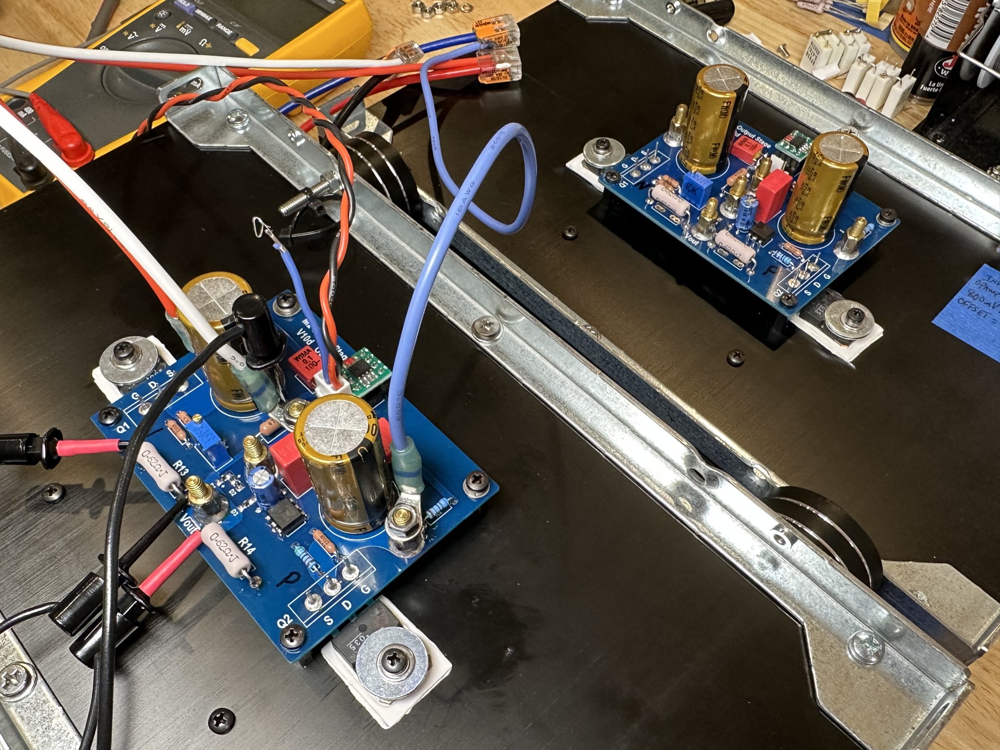

Some progress on my M2OPS rebuild.
  • Bias current was a bit too high at 1.45A with 0R56 source resistors, increased them to 0R62.
  • Running OPA604 on the edge with +/-23.5V PSU, Rs resistors increased to 68R for an additional 0.38V reduction.
  • Setup for mixed feedback.
  • Toshiba 2SK3497/2SJ618 installed
  • Cooked each channel on the bench for 1Hour = 1.33A bias current, 1mV offset
Ready for chassis assembly 😉

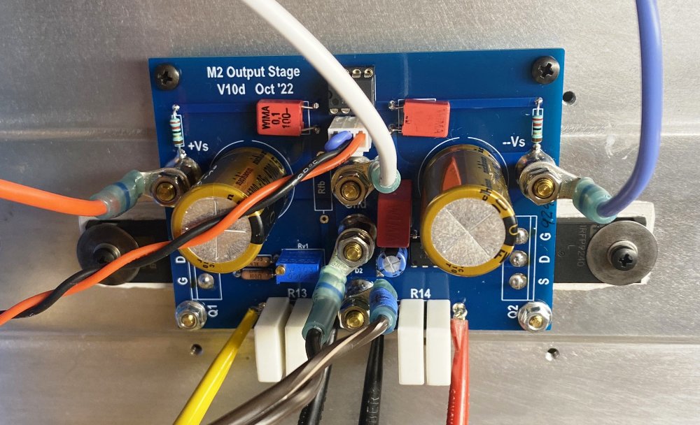

Since Mark mentioned a discrete frontend in post #10, maybe it's good to show an example.
Not fully optimised yet, but in principle it works.
But one at a time.
Patrick
What is the part number

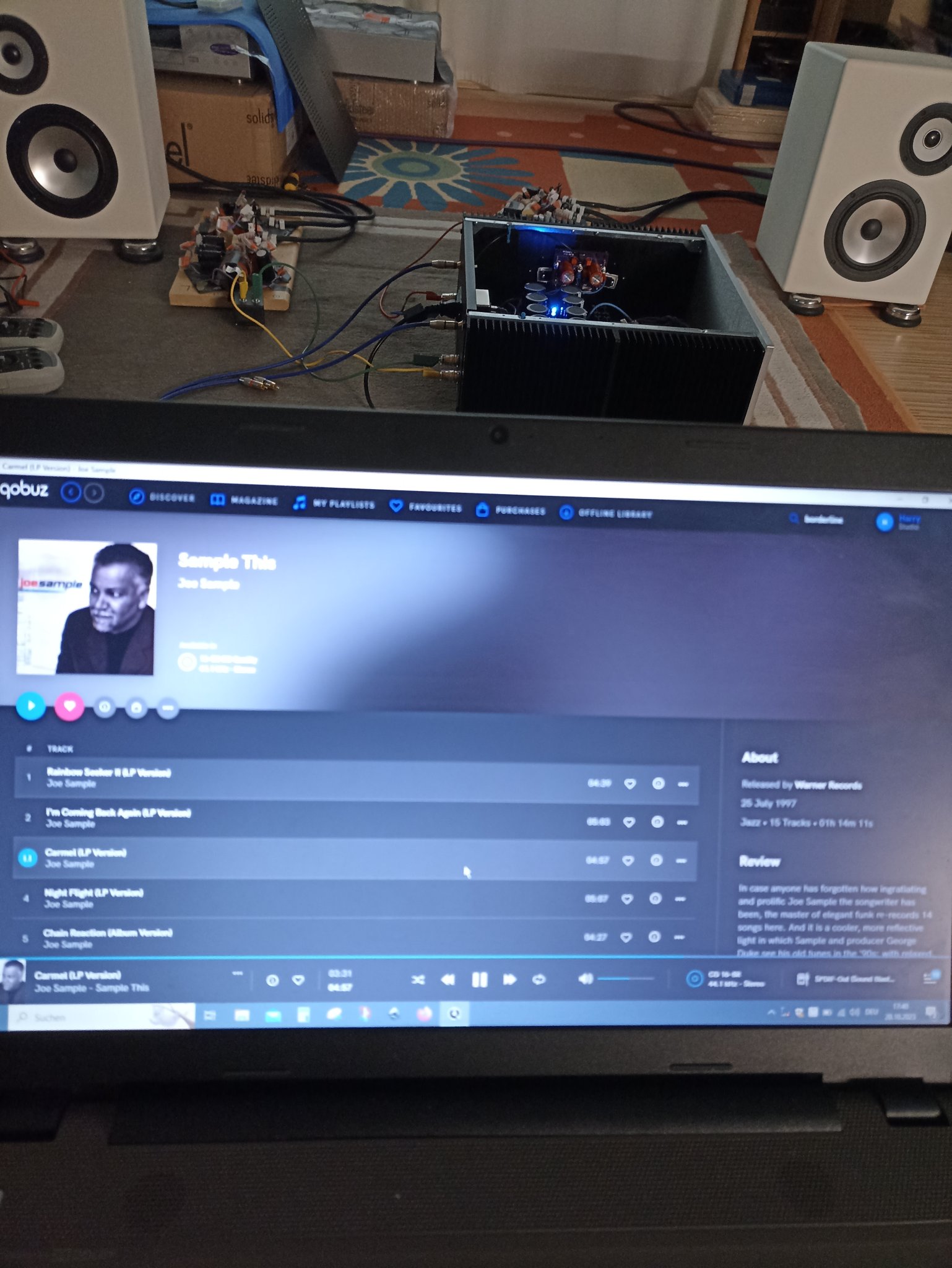

Well, it is making music. 🙂
Opamp is OPA551, in local feedback (excluding the M2OPS, post #26).
Yet DC offset is totally stable.
R13,14 should be at least 0R56, maybe even 0R62.
