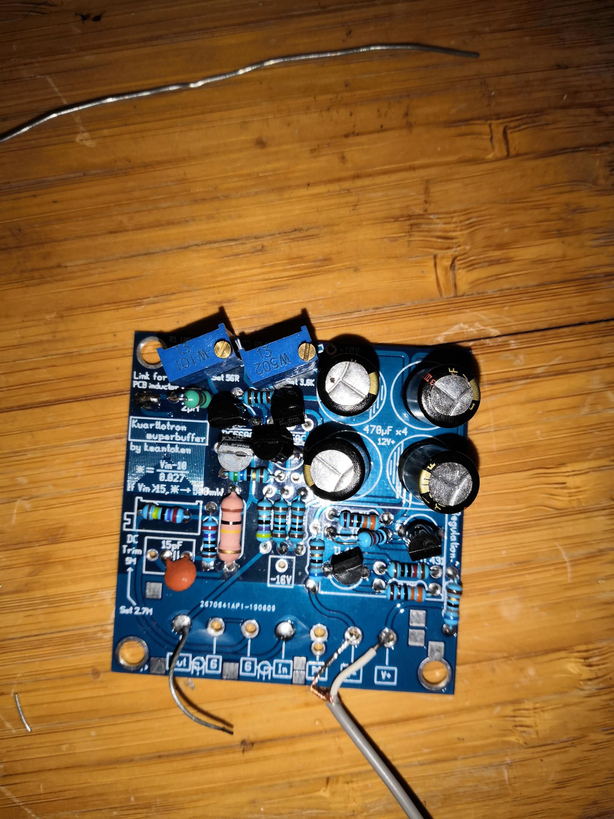

2: Short the input and adjust R5 so that TP reads half of V+ (5V).
3: Remove short from the input and then adjust the DC trimmer so that input voltage reads 0.
Output offset should now be within 5mV. This generally results from small variances in components and won't reduce performance.

hi can you help, i have shorted the signal inputs and and measured (tp) and it read about 8v and adjusted (r5)to 5v i have now removed shorted input........what i would like to know is how to adjust the dc trimmer ? is that r1 or r5 ??the off set reads .8v
