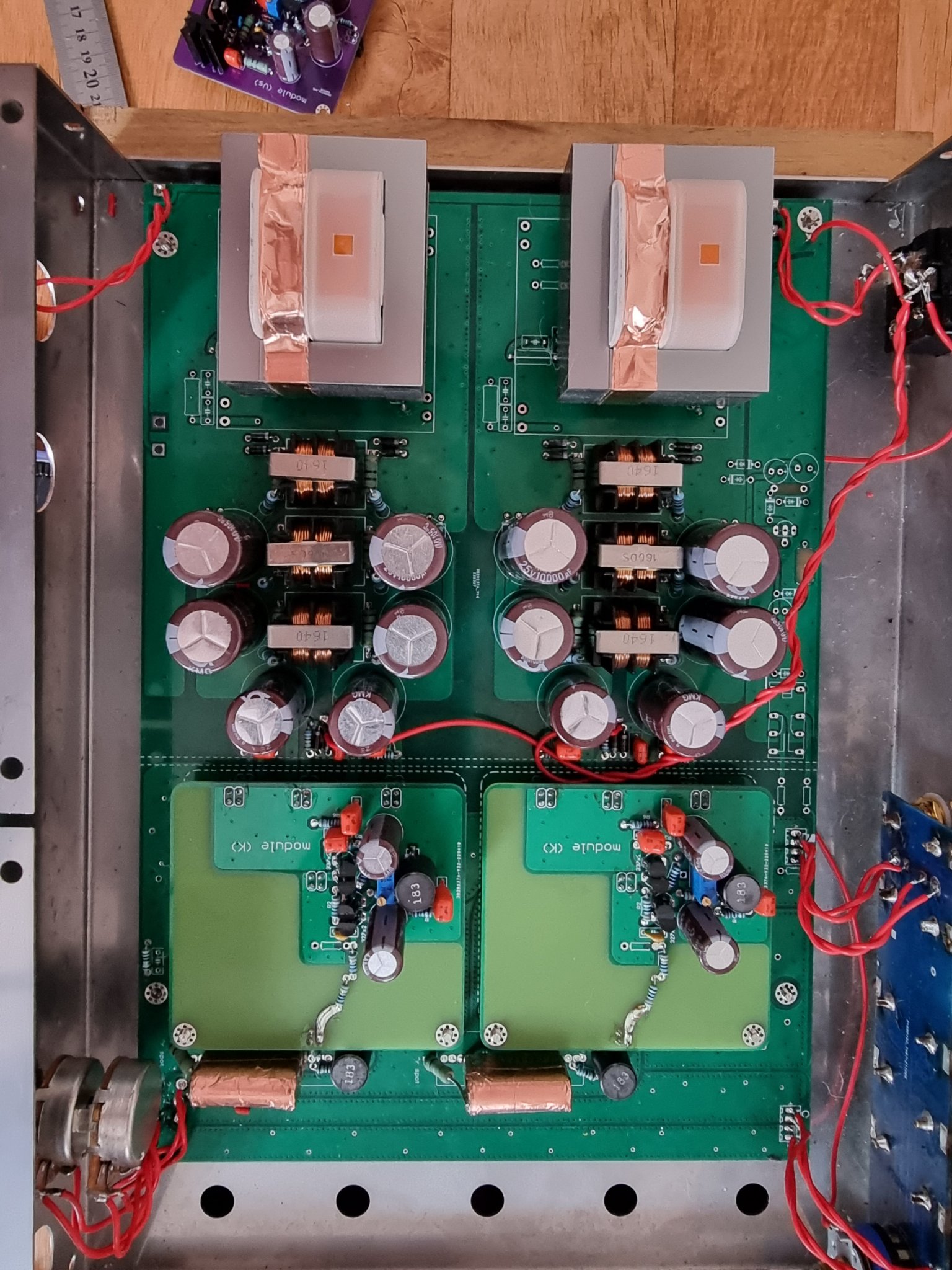

This is the unit its going to be used in.
In the picture its housing a module thats of john curl's circuit. The sound is exceptional but i feel that kuartlotron still does everything little better

I went and fitted the kuartlotron to my modular preamp. The sound is marvelous and it works trouble free, thank you keantoken.
One thing tho- i paralleled a 10ohm with the inductor thinking that it would suppress any ringing that might be present and it does seem to help the treble response a little bit. If youre dubious could you perhaps sim it and verify for us that it is indeed a good tweak?

Interesting, that looks like an RF layout.
I did try the parallel resistor when I designed the Kuartlotron but it was unnecessary because the inductor is well damped by the emitter and resistor in series with it and the resonant frequency is too high to have much of an effect. If it did have an effect it would simply be that there is no error correction at it's resonant frequency in the RF range. However if the resistor is too low the inductor may fail to have it's important effect on overall stability. As a rule of thumb it should be much higher than the 56ohm resistor in series with the inductor, maybe 270-1k to damp the inductor without affecting the stability.
The Kuartlotron was somewhat stable without the inductor but there was some peaking that could amplify RF interference and might oscillate in certain conditions. So you might get away without it but I preferred the overall sound with it, and that is coming from someone who is easily driven crazy by either muted or overactive treble. The inductor was the most benign method of compensation I found and doesn't affect measured performance in the audio range.

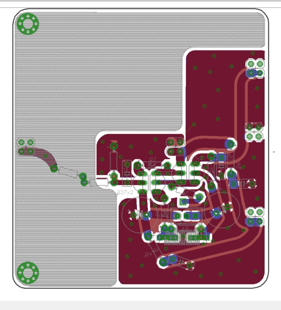

Heres what the buffer looks like in eagle. Theres still a lot of room for improvement.
I plan on opening a group buy for the preamp near future with the modules offered as an open source so to keep alive the diy spirit.
The module pinout was designed so that a text book perfect opamp layout is possible, btw. (Read: evaluation board style) A sota opamp like opa1641 is pretty hard to beat but kuartlotron can do it.

I tried high value resistor parallel to the inductor and it definitely attenuated the high freq. I found 150ohm offer too much attenuation, and at 22ohm and 10ohm the treble is still attenuated vs there being no resistor. Ive settled on 10ohm atm as that combo seems most benign while still taming the sparkle somewhat.

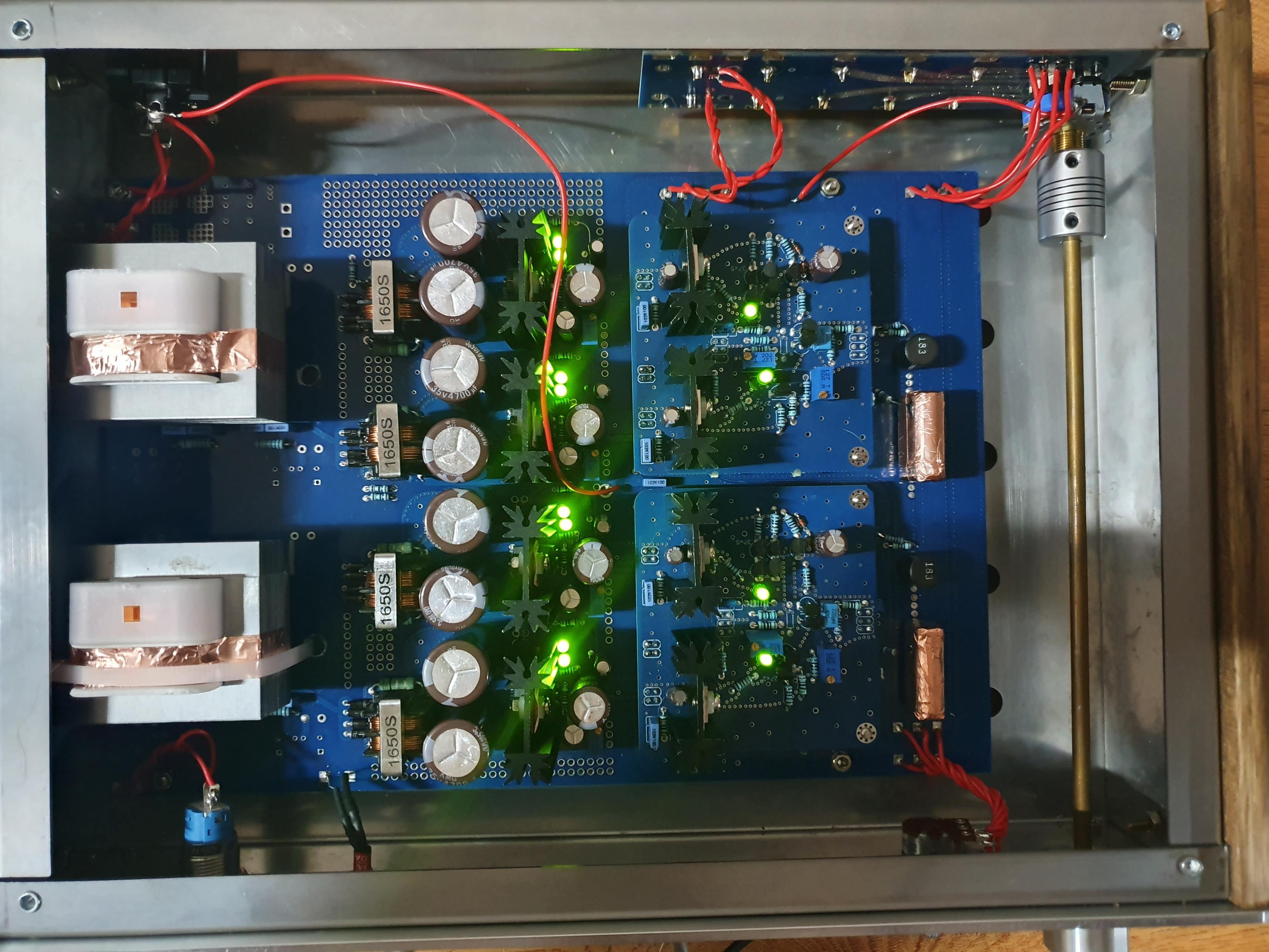

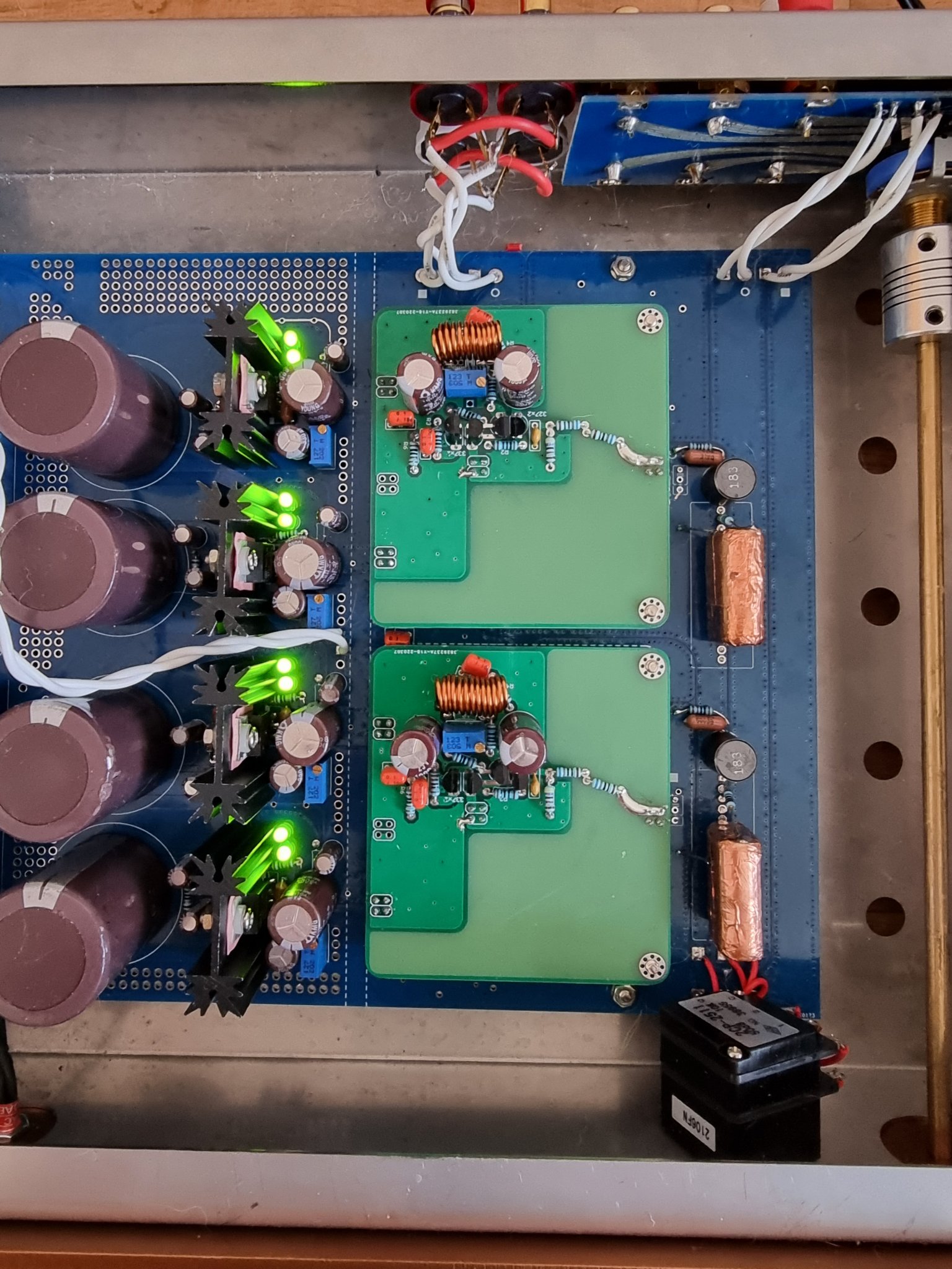

Heres my latest iteration for this awesome buffer whichs now my reference unit.
Purely passive psu, lrclrclrc string. Its output is... +-22v! (Gasp)
I doubled all the resistor values on the buffer to accomodate that and so theyre all either 2k or 270ohm. Still using bc327 337. The sound is much better than anything that came before it. If you ask me now id have to say regulators are overrated.
The kuartlotron doesnt thump anymore either at powerup with these new resistor values. Dc offset is still 1mv range and stable.
Id like to know tho if ive chosen optimal resistor values, and if psrr has been increased because of it.
P.s. used faston shielded inductor for this build. Like i said, it sounds flawless 😊

At those voltages thermal coupling may be desirable between transistors. If you thermally couple them you will likely have to re-trim.
The regulators were more to keep the voltage in the optimal range for performance with varying power sources, but it sounded fine without them. I didn't go above 10V because it would always sound harsh.
