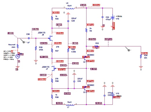

there will be more issues to consider.
diskrete DAC has 1/2+V of the offset at the output? That is +1.65V if power supply is 3.3V most lightly. So the coupling C will be necessery?
Another thing is output resistance of the DAC that is tipicaly R value (from the R2-R ladder net). That is probably 2K to 5K? I dont know?
So there will be some attenuation because of 10K input at the buffer?
I have R value of parallel R2R net 10K-5K so 2.5K is equivalent generator resistance in my case. So 10K to ground at input was small value in my case and I had to move to higher values to avoid atenuation and LowPass analog filter needed higher R load to get proper Fo cut off... The output resistance og the dac is pretyy high i think.
And third thing - If You plan to use diferential mode 2 buffers and transformer after that to acheive SE, that transfprmer should have some sufficent inductance of primary. Because I think that output resistance of the buffer is not too low?

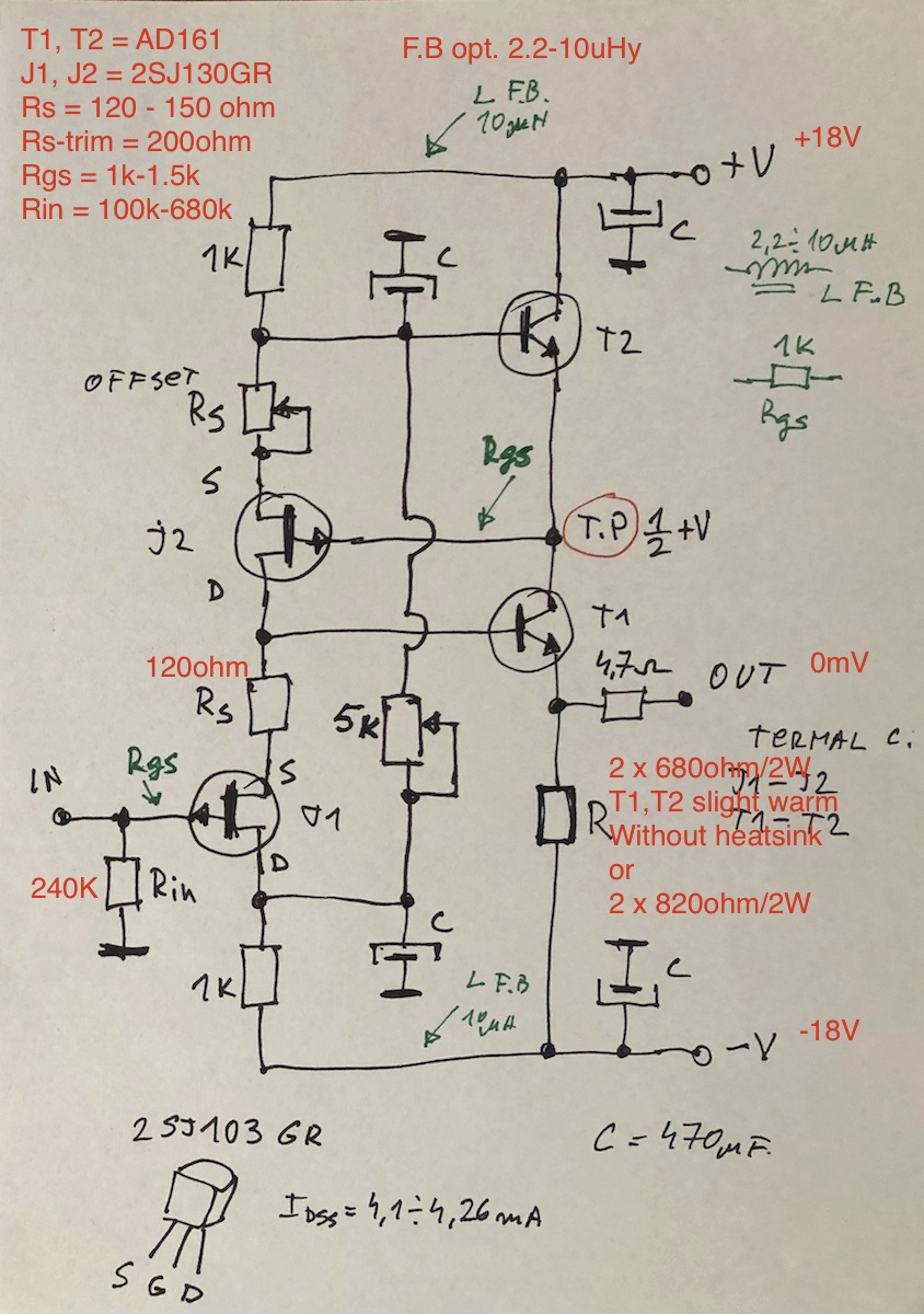

I tried JFET at the "input" branch, to increase Rin to several hudred Kilos. And Germanium AD161 at the output. With 340ohms series resistor from output tap to -V. To drive very low primary inductance transformer to get good LF bandwidthh...
I will post the shematic

IF You cut out all other nets from the output of R2R ladder network. Just FPGA and R2R net - it should have offset of 1/2 power supply at ladder net.1941 has no offset on output. Output impedance is 560 ohm per half.
The output impedance for R2R based topology should be R value...
That is for DAC device only without any following analog stage, buffer or amplification stage
I tested one more version with JFET "input" and Ge "output" devices. Working very good. Same like full Ge, but with higher input R. For Ge-s I tried 2 types AC187 with lower Io, and AD161 with higher Io, but without owerhating without heatsink.
I tested this because I have almost all elements on board. just exchanged 3 elements.
More common types for Ges anf JFET version is bellow.
