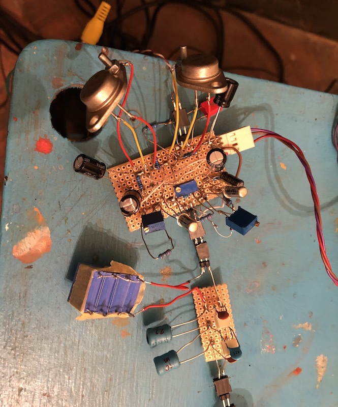

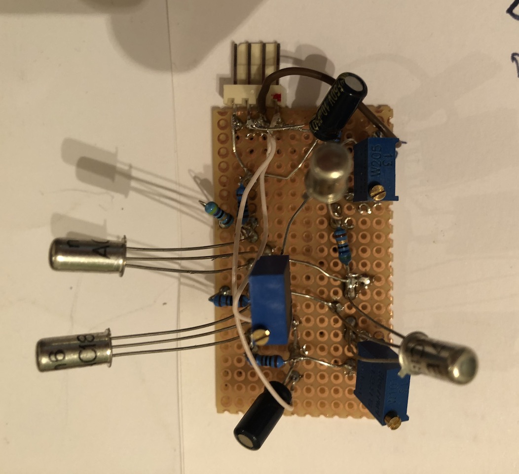

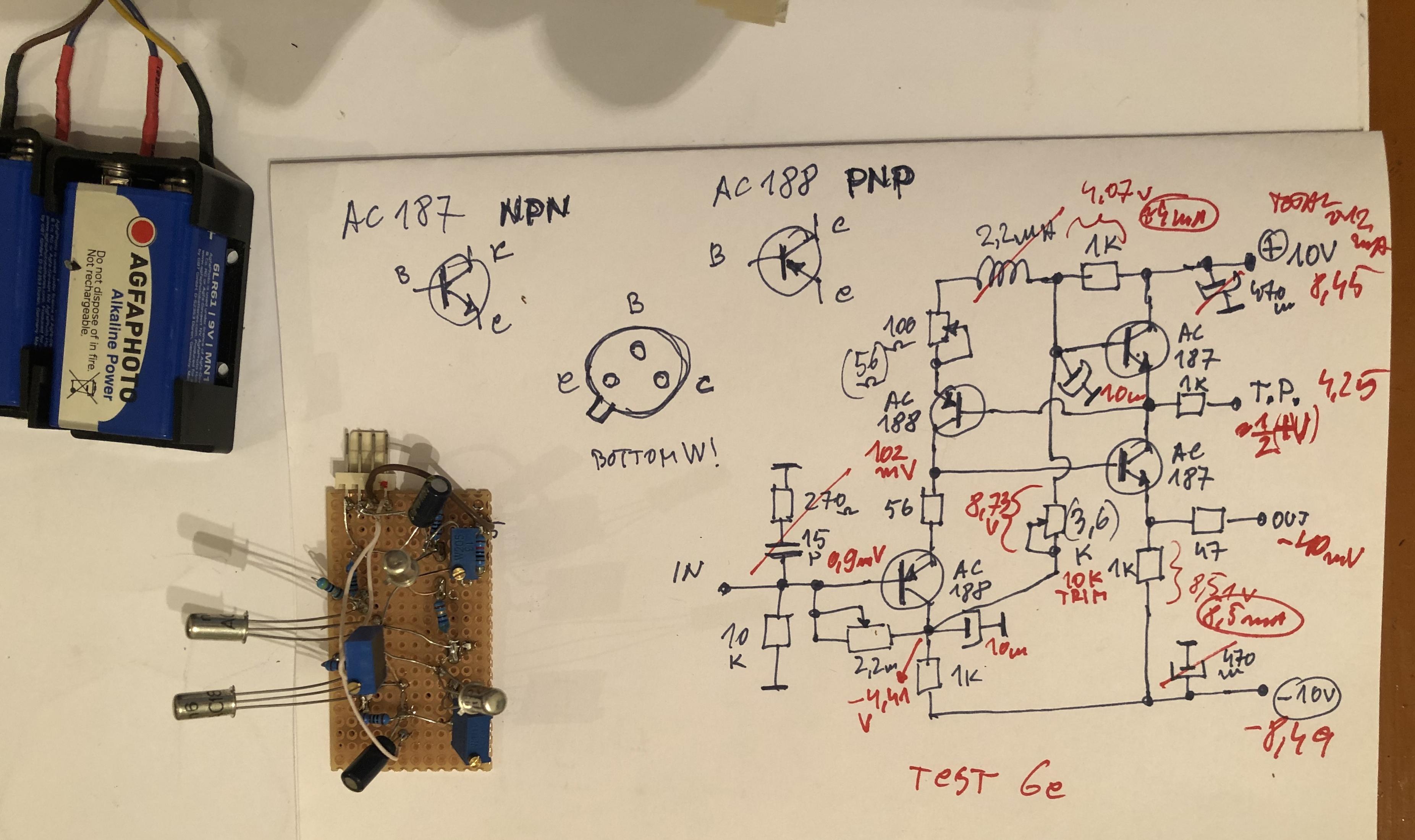

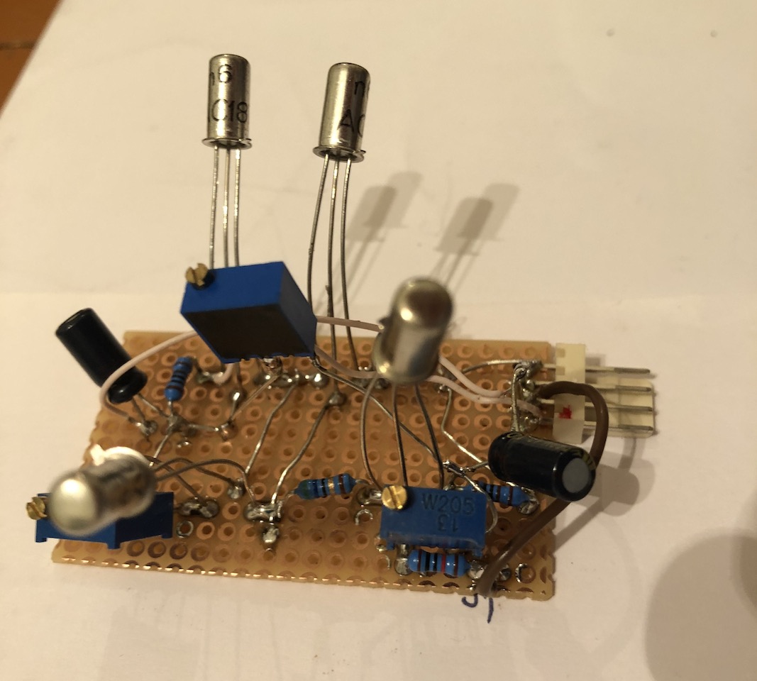

With "little" delay I tried Germanium version of this buffer.
And it was OMG sound last evening...
Circuit working with Ge devices AC187 and AC188.
For the test I not solder unmark parts, RC input filter, choke 2.2uH.
Capacitors at the PS are ommited too because I power device from the 2x9V battery pack.
Rest 2 capacitors was 10uF (against 470uF in the original sch.)
-It was possibile to set 1/2 +V at the test point.
-I just set another pot to 56ohms didnt measure and eventualy correct dist yet.
-off set is about -40mV with (I think) pot of 2M full value. Initialy was -52mV and with inreasig value droped.
-Transistors randomly picked.
-No overheating, 1st pair are consume about 4mA second pair is about 8.5mA.
-Second pair just slightly warm. First pair are cold.
-Circuit not showing any hum or his. Very silent.
I tried with Quad II power amplifier and with transformer input Western Electric Germanium amplifier.
The sound was vey good. Natural and with "body". Digital media are somehow moved to analog sound and made ballans with start-finish of the tone. Not to emhesize the finishing HF end. Circuit with Ge somehow "reduce" digital "signature". Instruments are neutral and transpraent, echoes are clear and also with fundament. Bass is very good.
But the voices are beautiful 🙂
I just listen one channel last evening until I the batteries are almost drained 🙂

I just set the 100ohm trimmer to 56ohm value lsame ike fixed resistor (not measured, I should...) and not touch that part.

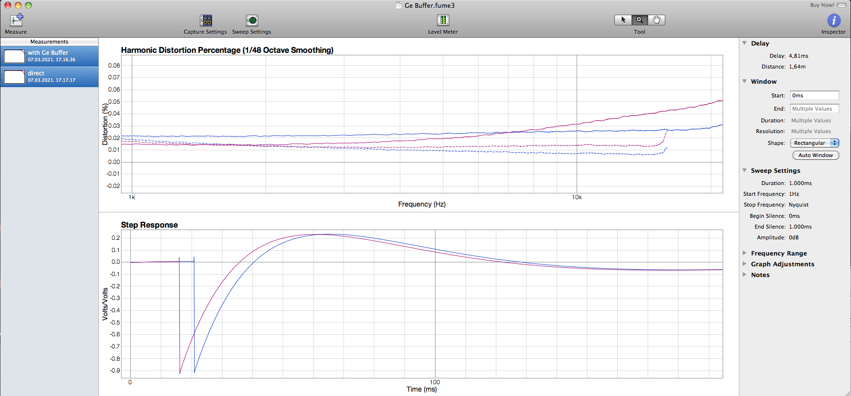

But I measure total distortion with buffer in system (experimantal dac-filter-buffer and it was delta only in 0.01-0.015 to naked dac output. That is with passive 5ord filter and 10K@input buffer. That is not huge but dac module have 2.5K of output Req. So this 10K input res. probably "damped" more than it should.
The transfer is pretty flat even with 10uF of C inside the circuit used against 470uF. (i didnt have when soldering...). No any cut of low end
I MUST prepare one IV converter circuit from Ge transistors, after even small listeninig of this Ge version buffer...
I have some Q about the using Ge:
- What is higher value of Rin that could be used?
- Can I use higher supply voltage?
- Is that currents of 4mA(input branch) and 8.5mA good?
- Can I use other types for output NPN stage, like AD161?
- Can I ommit output serial reistor (when loading output with transformer)
cheer and thanks 🙂

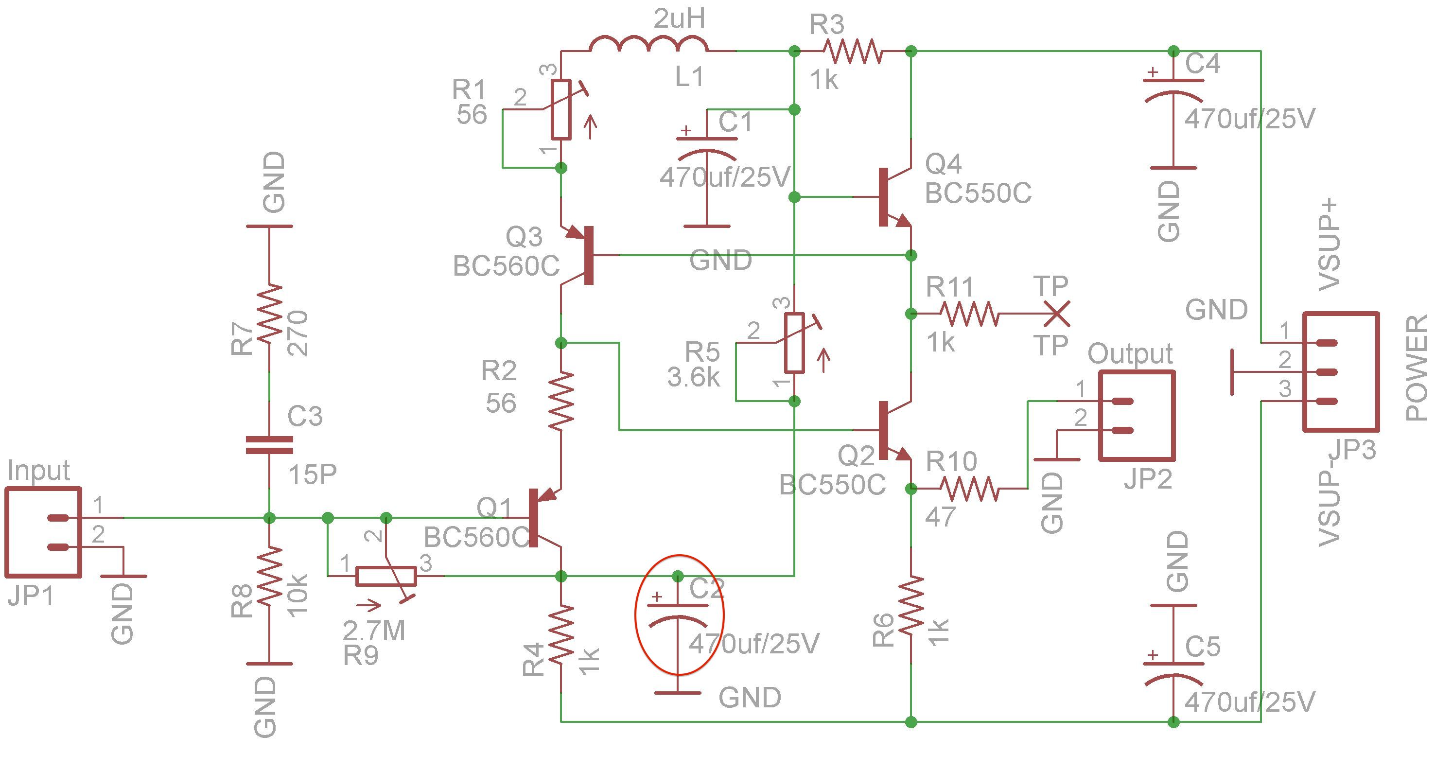

I will try to reduce more -40mV offset. By increasing BE 2meg resistance to 2.7meg in the schematic. And make thermal coupling. But even without themal coupling this circuit with Geramnium devices not showing any drift of test points.
Yes, thermal coupling doesn't matter much here because the tranistors all heat up equally. Where it might be useful is if the board is mounted with a hot heatsink on one side.
The specified transistors have fairly consistent Vbe, but some of your offset could be coming from your Ge transistors. You would measure this by measuring the voltage between input and output. If so you might be able to reduce it by swapping the PNP or NPN transistors.
If you can reduce offset to zero with the trimmer, then what's left is thermal drift. At some point as you increase source resistance (including the input resistor) the thermal drift will become tunmanageable. I don't know what that would be for Ge transistors and I hear the AC127/128 can be highly variable between batches and manufacturer. But if it will be permanently used with your DAC with 2.5k output resistance, you could actually remove the input resistor as it is only there in case the source is disconnected.
4mA and 8mA are fine and might actually be better for Ge transistors if the input transistor is slow. On the other hand by reducing the input transistor bias you may reduce distortion by reducing the harmonic currents from the input transistor base. You can do this by changing the 56R resistors.

Swap Q1 and Q3, or Q2 and Q4. You may get better offset if the Vbes are mismatched and you find the right combination.
You can increase the voltage but you will need to reset TP to half the supply voltage. There is no reason to use a Jfet CCS.

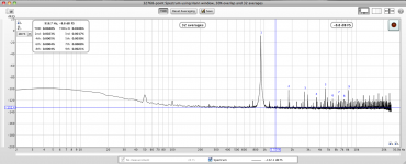

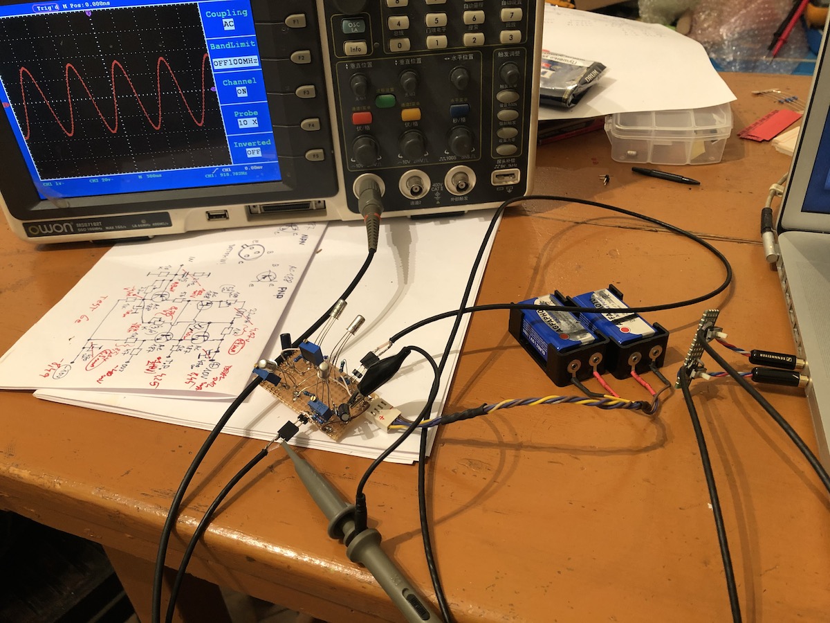

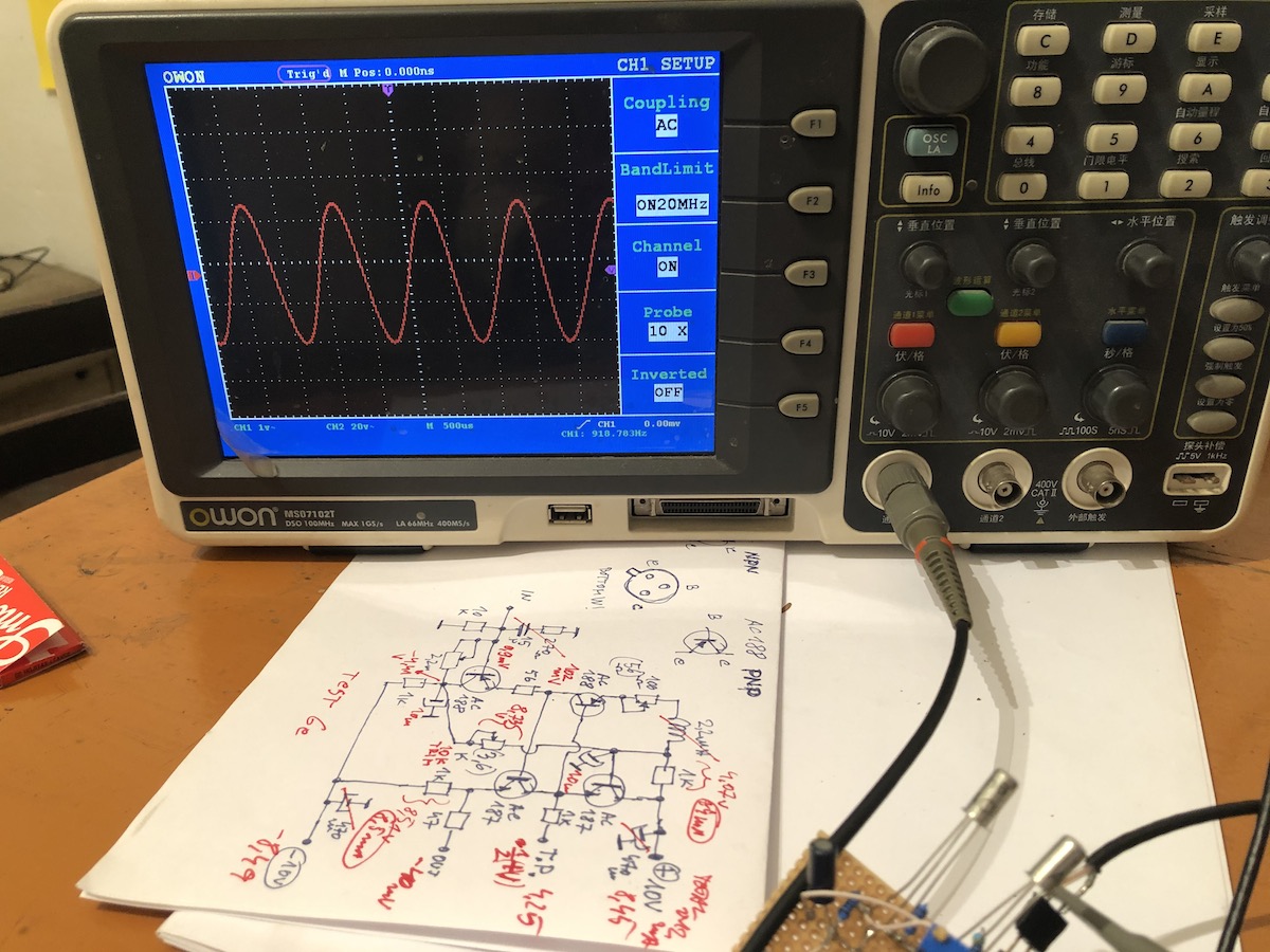

Hi
I done some measurements last evening.
I measured the circuit just like it was in the schematic.
BUT i switched output transistors with say 10mV offset. Kean was right 🙂
Also I spot (and measure) that in the input branch was about 0.38mA not 4mA cca.
About 4mA was total from +V with 1K-Rtrim-1K to -V
With 56ohm R at emitters.
So in the initial original values of the buffer, with Ge devices AC188/AC187 currents are
0.37mA input, 4mA shunt, 8.4mA output.
With batteries of +- 8.35V cca

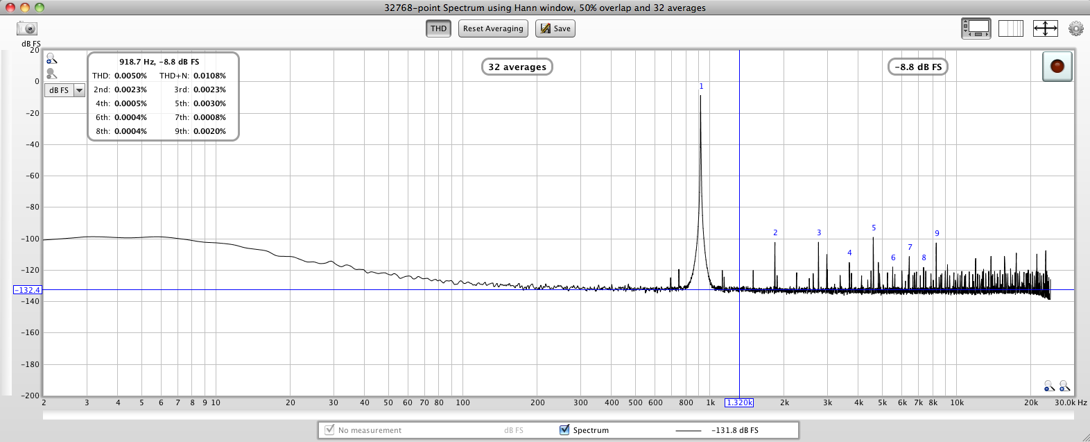

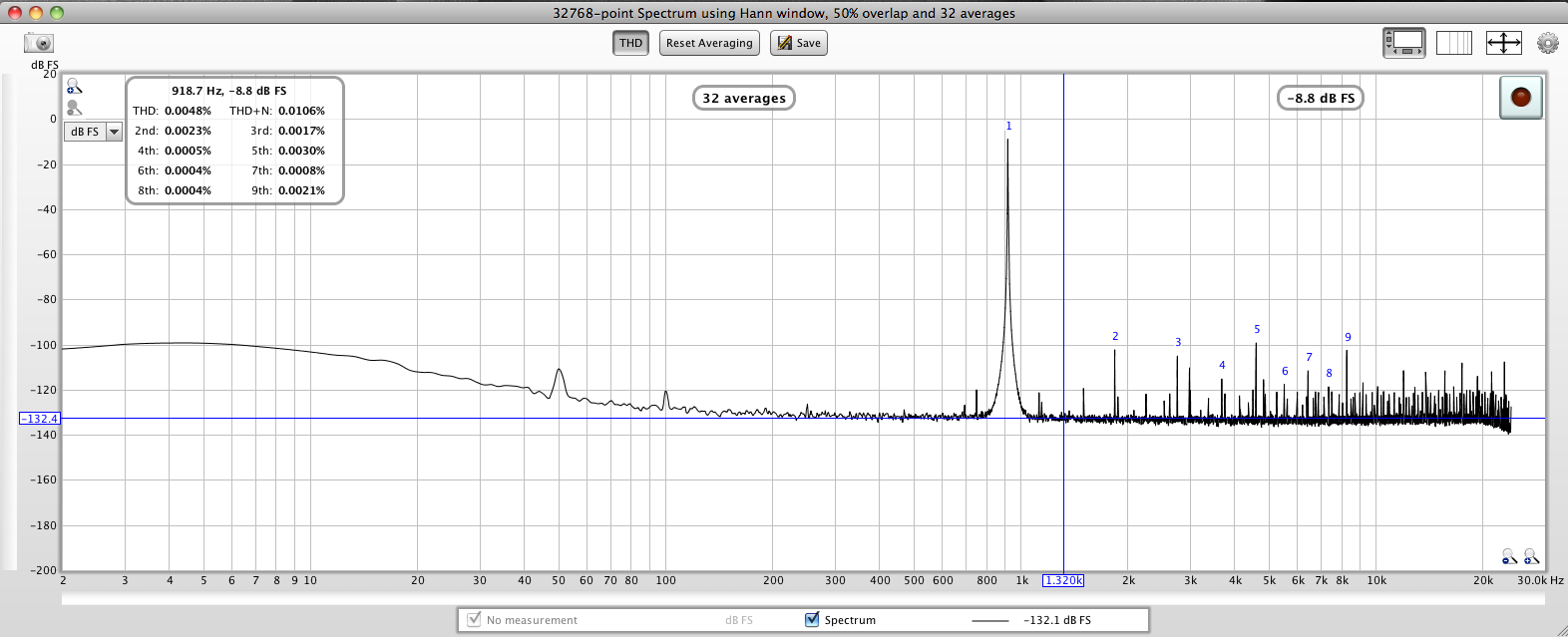

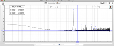

- The buffer holds input signal of 3.3V P-P cca. without clipping. I didnt have more output on the computer...
- Distortion is below sensitivity of the measurement equipment and didnt show almost any increase of distortion WITH Ge Buffer.
- Transfer is the same as without Buffer.
- But sound is much better WITH the Gee Buffer.
(Some moderate measurements indicate that Distortion at HF region are smaller with buffer with a same transfer and phase shift.)
- Distortion with Ge buffer is a bit smaller against the JFET classic buffer (with same battery supply)
[For measurements I use old MBP17 in. Soft for distortion measurements REW, for transfer FuzzMeasurePro, other AcousticToolBox...
MBP17in have 27.3K of input R measured as the Load. Impulse is negative because I dint use compensation. It is tha same with and withput buffer, so buffer does NOT invert phase...]

I forgot to say all this i prepared without thermal coupling of pairs. Without coupling, device slowly coming to the point values. I think that with thermal coupling things will be better in that way?
I had some holders, but as ysusal, they was bigger diameter and for other type of Ge devices 🙁
I will try with thick copper?

I spot the same with Ge-s too...
I tried yesterday AD161 in the "output". (for now also without thermal coupling.) And it wotking good too.
Also find some mistake and correct it. C in the collector of input transistor is opposite polarity. At this point voltage is negative and about slight more from 1/2 -Vb.
After that I add 470uF value of capacitors and also in the power rails. Put the buffer from batteries to +-12V power supply. Every TP was adusted. Absolutly any hum, hiss or anything comimg from the speaker... 🙁
And sound was even better. Better body and low mids with these bigger Cs...
Tried 32K input resistor (10K+22K series) and offset was adustable to zero. output segment from AD161 vintage Siemens parts, consumed 12mA. (I just need higher input value because of the fiter before buffer, Has to be higher termination impedance to avoid peaks at the cut off F...)
At he input of the buffer I put 4x1uF C.
With this bigger value of 4 x C (470uF) I didnt have any clicks or anything with power ON/OFF. So the Ge version coud be used without relay at the output.
I will post the measured values of the components and bias points.
All distortion remain the same like it was from the beguining. Nothinf is changed.
I didnt solder RC input (270ohm-15pF), beacuse I have already lowpass filter at tinput. Also I prepare but didnt solder 2.2uH FB because I think that Ge-s are much lower Fcutoff than Si-s is it OK?
pic
C2 should be in opposite polarity, because at the collector we have something about 1/2 -Vb... First I didnt spot this and solder in wrong way, later in proper way connected somehow offset was easy to adjust and it was more stabile? With additionof 470uF to 10uF everything was better.
Conclusion is:
-This buffer can work with AC188 inoput pair
-and AC187 output couple, as with AD161 output. Probably with other Germanium devices but not tested 🙁
-Tested with +-9V and +-12V power supply.
-Tested with input signal of 3.4V P-P. probably can accept more p-p...
-No hum or his, no on/off clicks and pops.
-Ditortion is wery low with Ge-s, and lower than source with HF region. Wich is from crucial for digital sources...
-Sound is - just BIG and natural 🙂
Conclusion is:
