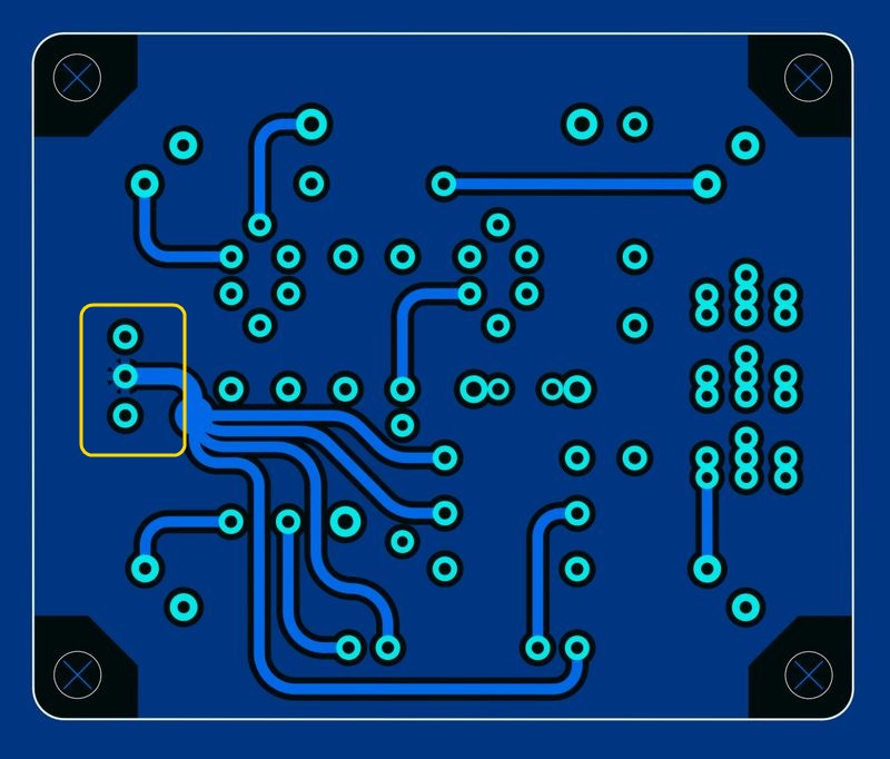

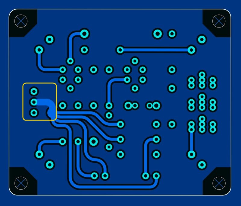

After some private message requests for the manufacturing files and Sprint Layout, I decided to make them available for everyone.
On the images the name 'KEANTOKEN' has a small error and it is repaired in the attached files in the archive.
The first version I made and hand made that works perfectly is visible here but I made some small aesthetic and practical changes.
The Kuartlotron - keantoken's simple error-correction superbuffer

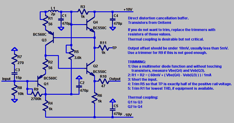

Okay. Well that is interesting, since it's the first time I've heard of a problem with the bass. The boards I sell use a 100k input resistor, the original circuit used 10k because some early users wanted to use it DC coupled. If you are using an input capacitor try using 100k instead of 10k.
I know the pcb design programs are designed for production assembly, not diy and this is a bit late in your design procedure but is it possible to increase the size of the donuts and also the space between the donuts and the surrounding 'planes?
As it is, the small donuts and narrow clearances increase the chances of a 'short' plus when altering components, it's rather difficult to avoid board damage
If you did it with the input grounded, then R9 will not do anything. It needs to be adjusted with the input open. R1 is for trimming distortion, not offset, although you could use it that way for small amounts of offset if distortion wasn't particularly important.
Ok, had another go at this. With open inputs the offset is 45mv, r9 is a 1M trimmer paralleled with 1.8M. I can adjust approx 10mv across its whole range. I suppose I need to change R9 to something else but I’m unsure what.
Vbe of 560s were 0.686 and 0.688 and 550s were 0.685 and 0.680.
Ok progress, I switched the 1M pot for a 5k one and jumpered the series resistor position and managed to get below 1mV. Not sure how to explain this, I clearly misread the schematic and thought r9 was 2k7...
Kean, they are 560CTA.
Ok, using the 1M trimmer with the series 1.8M also works, so I suspect I’m just at the end of the travel for the pot, probably at low R. Would it make sense to try something even higher, like 2.2M for the Series resistor to R9? Is Avery low resistance for R9 a problem?
The values 1M for the trimmer + 1.8M for the resistance correspond to the schematic.
If the trimmer is at its maximum value I think that a 2.2M should solve the problem but maybe it is at its minimum value and at that moment it is necessary to reduce the value of the resistance.
