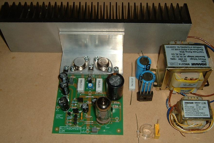

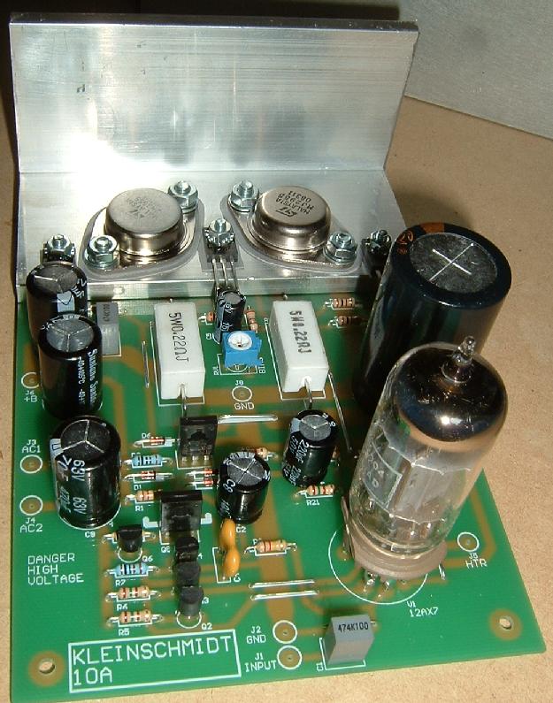

Alrighty…. things are starting to go somewhere.
Shown below is a completely loaded board (minus the VAS transistor heatsink tab, which I have yet to cut) along with most of the externally mounted parts required for one complete channel.
To the right of the picture is the 60VA 24V transformer, the 30V 150mA transformer and the series resistor for the 12AX7 heater along with the bridge rectifier and filter capacitors.
I would recommend a minimum of 10,000uF be used here. The ones in the photo are a pair of 4700uF units that I’ve got at hand. I will go out tomorrow and but a few more, to have 3 of the in parallel for each channel.
Also shown in the photo are the 100n X2 class capacitor along with the coil former and the 6.8 ohm resistor for the hybrid load coupling / Zobel network. These components will be mounted on a bit of tag strip at the speaker binding posts.

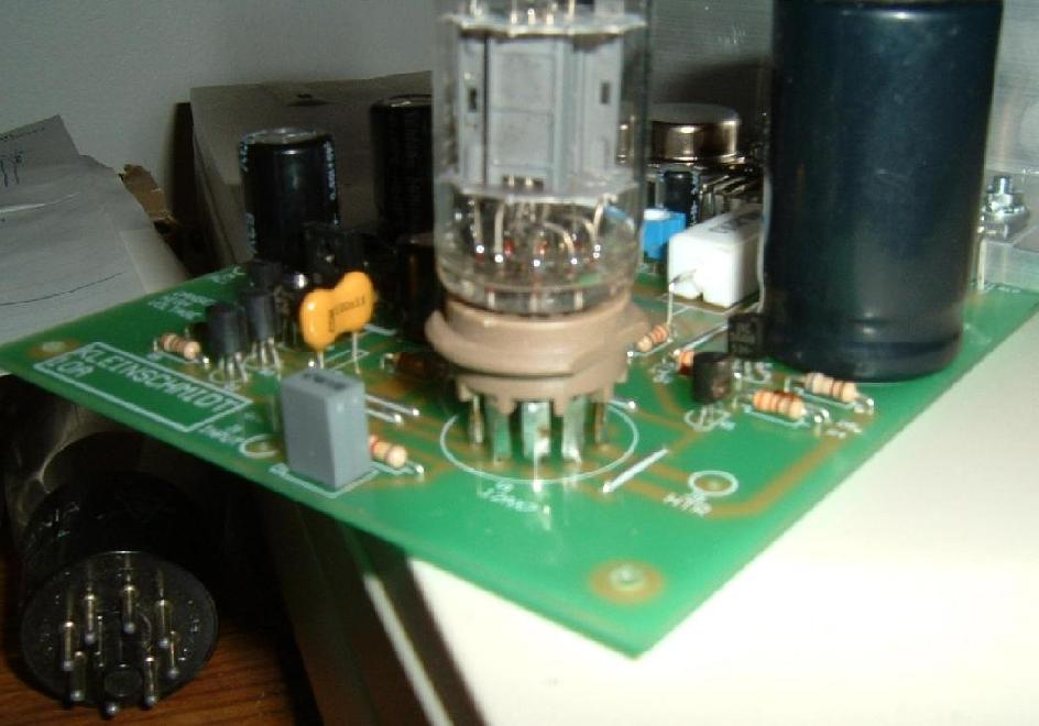

For the PCB mount valve socket, I have elected to use a common chassis mount B9A unit with the chassis-mounting lug (preferably) removed.
This requires that short lengths of tinned copper wire be soldered to the lugs to protrude through the PCB holes. This is a bit of a fiddly procedure, but it allows any common 9-pin valve socket to be used.
I also prefer this to the available sockets designed for PCB mounting as it keeps the hot valve well clear of the PCB.

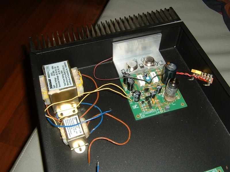

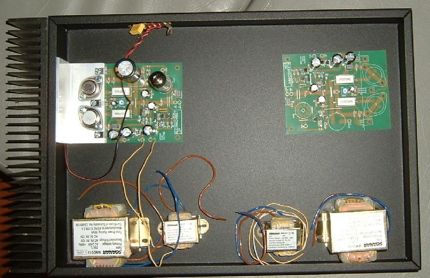

Going into the chassis.
I have decided to mount both amplifier channels in one case and I am using a Hammond steel chassis intended / marketed for conventional Valve amplifiers. The chassis has heaps of room inside, so the transformers, power supply components and mains wiring can all be mounted well clear of the sensitive parts of the amplifier board. The stereo channels are kept well separated too.
The transformers will be mounted on stand-offs, a little bit above the base of the chassis to prevent the induction of eddy currents.
The heatsinks on either side measure 300mm X 75mm X 48mm and are rated at 0.37 degrees C / W.
I will make a varnished pine lid for the chassis with a sheet of aluminium screwed to the underside for shielding. A circular hole will be cut above each 12AX7 for clearance (the tip of each valve will protrube just a little) and ventilation.

The tube socket floated above the board is a neat idea, i noticed there's even some spare space on the pcb between the socket and the lytics to drill a few holes.
jacco vermeulen said:
Ceramic stuff is so cool, a shame there's not much use for it (anymore) in SS.
Hmmm...... if you mean to add extra support to the valve socket, it really isn't required. It's quite rigid with 9 leads of 0.8mm tinned copper wire.
